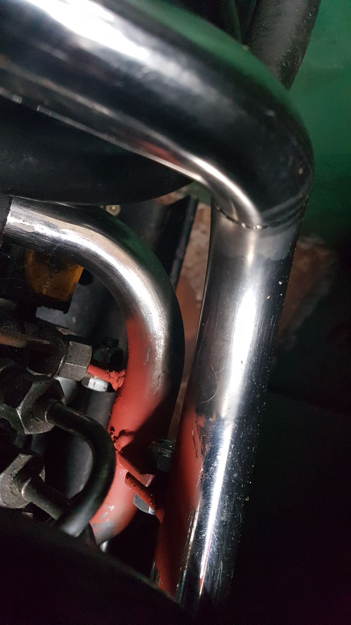

At last got some photos and thanks to Peter for coming down to see the boat, and he agrees I’ve been ripped off. I’ve included one photo of the stern gland, and I got a tight hold of the propeller through the weed hatch and it was rock solid, no play whatsoever. There’s also a photo of the fabricated support brackets that the Boatyard did. -

Sorry for late reply, I’ve been away. I put the antifreeze in separately, should I have mixed it with water first? I looked at the invoice again and they have done other things, I didn’t know the pipes had no support brackets as I didn’t know they needed any ?. The pipe to the expansion tank looked ok to me but I’m a relatively new to understanding boats. One thing I didn’t mention was when we were driving past Tully’s boatyard in Rotherham, all the nuts fell off the stuff box. Fortunately Tully’s had a slip way and I managed to reverse the back end onto it so we didn’t sink, and the Canal and River rescue bloke put it back together. From there we managed to get back to our mooring. The other thing is the boatyard put in lots of water but no antifreeze so I’m going to have to drain the damn thing again to get some in! ☹️
