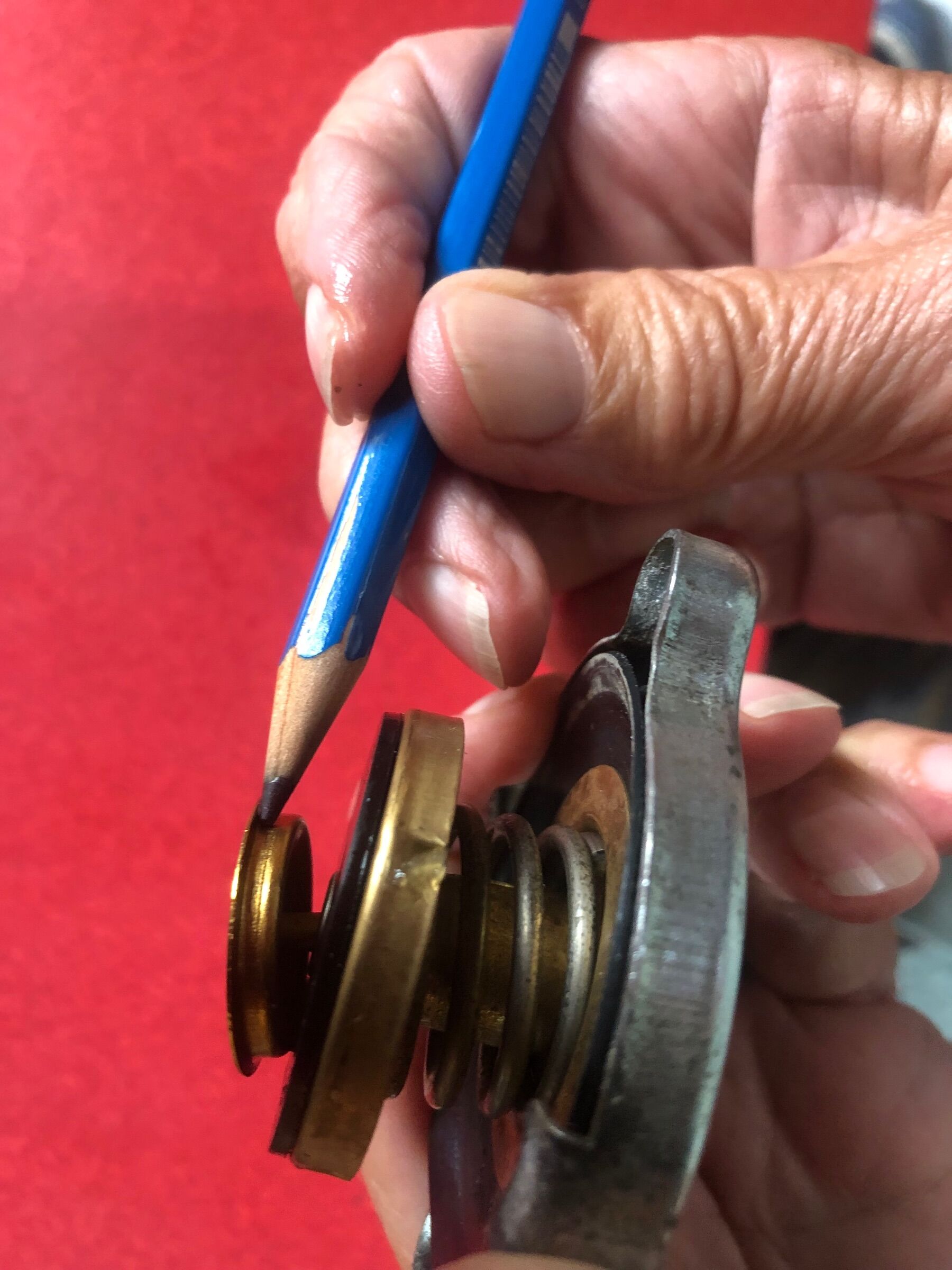

RLWP Posted July 13, 2023 Report Posted July 13, 2023 (edited) I was expecting to see something like the cap above. The central disk is the anti vacuum valve: Richard Edited July 13, 2023 by RLWP

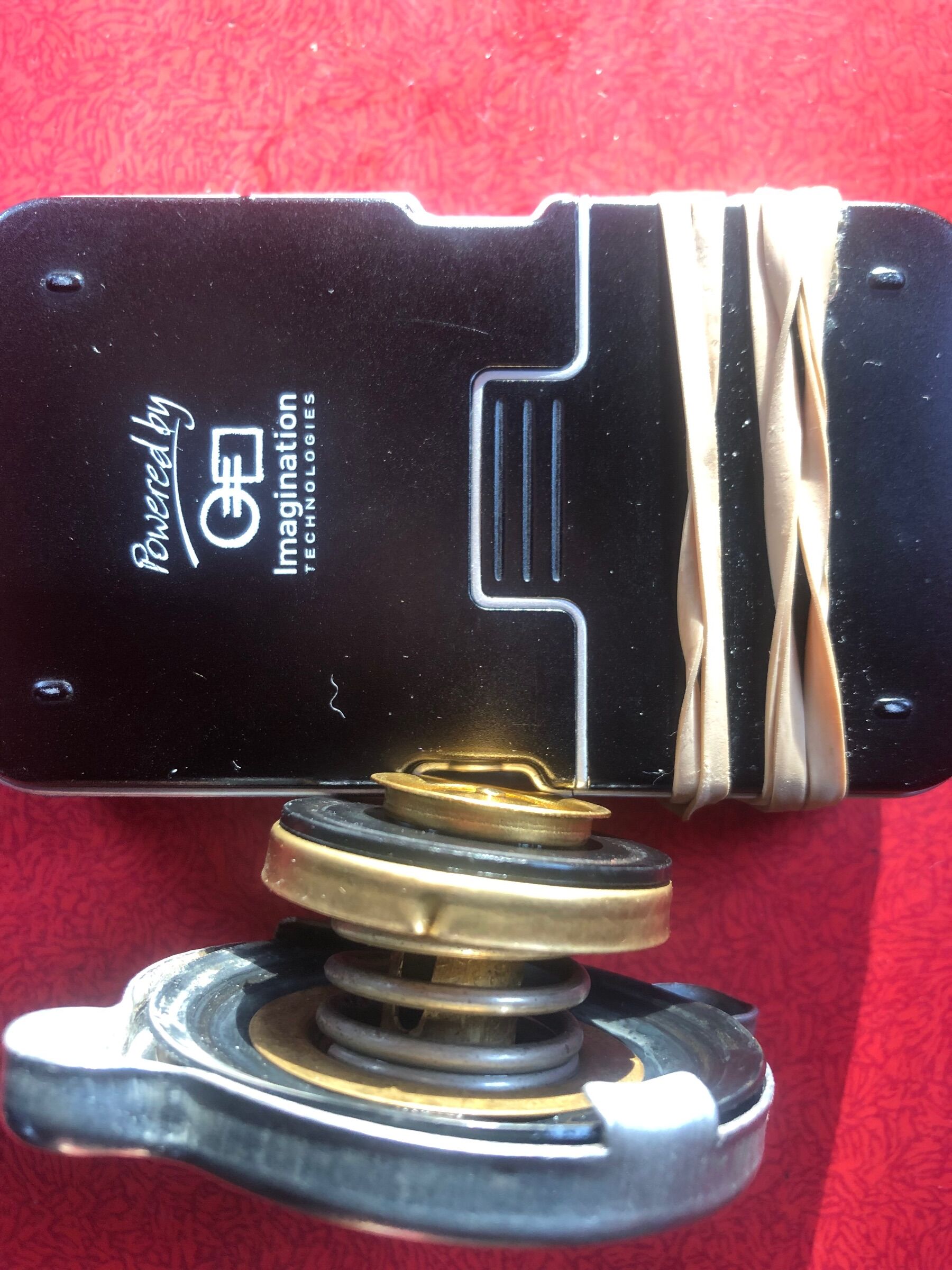

Tony Brooks Posted July 13, 2023 Report Posted July 13, 2023 I doubt this is any good, but I wonder if the rivet that holes the guts onto the cap is allowing air in.
Peugeot 106 Posted July 13, 2023 Report Posted July 13, 2023 13 minutes ago, Tony Brooks said: I doubt this is any good, but I wonder if the rivet that holes the guts onto the cap is allowing air in. Could be but I pressure tested it all with a bicycle pump though as you say i couldn’t vacuum test it. I think this winter I will fit a pucker expansion tank. I have a secondhand exhaust manifold so can ditch the mannicooler so there will be a positive head for the return and also a bleed for air. That’s what most other people seem to do. Very many thanks Tony For interest here we are approaching Tower Bridge. The dot to the left of the sailing ship. Note they opened it for us!

Tony Brooks Posted July 14, 2023 Report Posted July 14, 2023 16 hours ago, Peugeot 106 said: Could be but I pressure tested it all with a bicycle pump though as you say i couldn’t vacuum test it. I think this winter I will fit a pucker expansion tank. I have a secondhand exhaust manifold so can ditch the mannicooler so there will be a positive head for the return and also a bleed for air. That’s what most other people seem to do. If you ditch the water cooled manifold, you really should wrap the plain manifold in some form of insulation to TRY to protect against serious burns if someone touches it when hot/running. It is not something I would willingly do. The pressure test would only test the seal sat the bottom of the filler neck, not the top one, and there looks as if the top seal might be slightly crinkled in one place, it is hard to see on the photo. On the face of it expelling coolant and not drawing it all back in speaks of overfilling, but if you empty the expansion tank into something other than the engine, and it expels the coolant each time you run it without topping it up again it suggests something else, like air/gas building up in the skin tank each time it is run.
Peugeot 106 Posted July 14, 2023 Report Posted July 14, 2023 7 hours ago, Tony Brooks said: If you ditch the water cooled manifold, you really should wrap the plain manifold in some form of insulation to TRY to protect against serious burns if someone touches it when hot/running. It is not something I would willingly do. The pressure test would only test the seal sat the bottom of the filler neck, not the top one, and there looks as if the top seal might be slightly crinkled in one place, it is hard to see on the photo. On the face of it expelling coolant and not drawing it all back in speaks of overfilling, but if you empty the expansion tank into something other than the engine, and it expels the coolant each time you run it without topping it up again it suggests something else, like air/gas building up in the skin tank each time it is run. Hi Tony sorry for delay the signal is lousy here. I am out of contact will reply when signal better.
