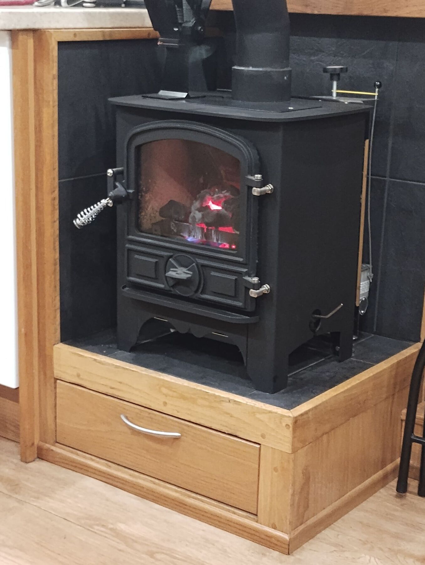

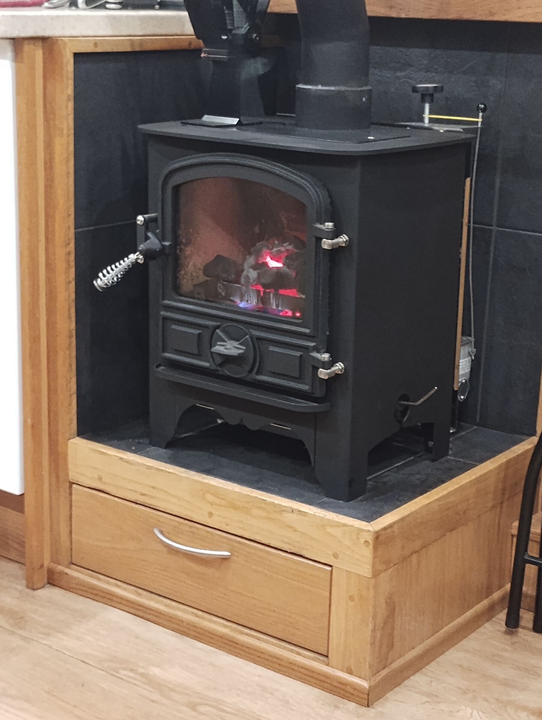

This is our Bubble stove with the extra cost ceramic coal kit. At tick over you don't see any flame or red coal but from just over halfway it's like this.
