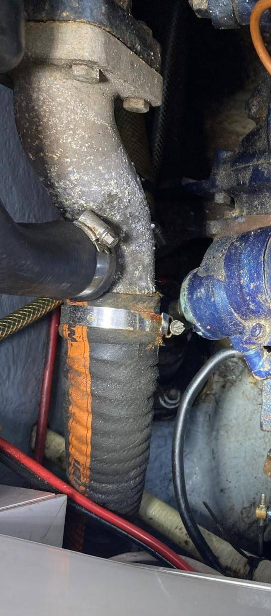

Thanks Guys, I think Im talking about this part which appears to have four bolts holding it on. What you cant see here is that under that jubilee clip, the hose is not in good condition.. Would I be better to seperate the exhaust where it bolts to the heat exchanger or should i pull the rubber hose off an figure out how to get it back on  later.exhaust.jpg.f5c0ff5f2464f39d3c62360c5bb69ae1.jpg

That is the mixing elbow, but the mixing part (where the sulphuric acid was produces before low sulphur diesel) is well away from the manifold. It looks like aluminium to me. My feeling is that If taking the engine right out, then I would try undoing the four bolts. However, I can't see much wrong with that hose apart from some rust marks that probably originated in the steel spiral reinforcement that looks as if it might have been pulled out of the hose to get it to fit over the elbow. That would allow water/condensation to work between the plies and rust the steel - hence the stain.

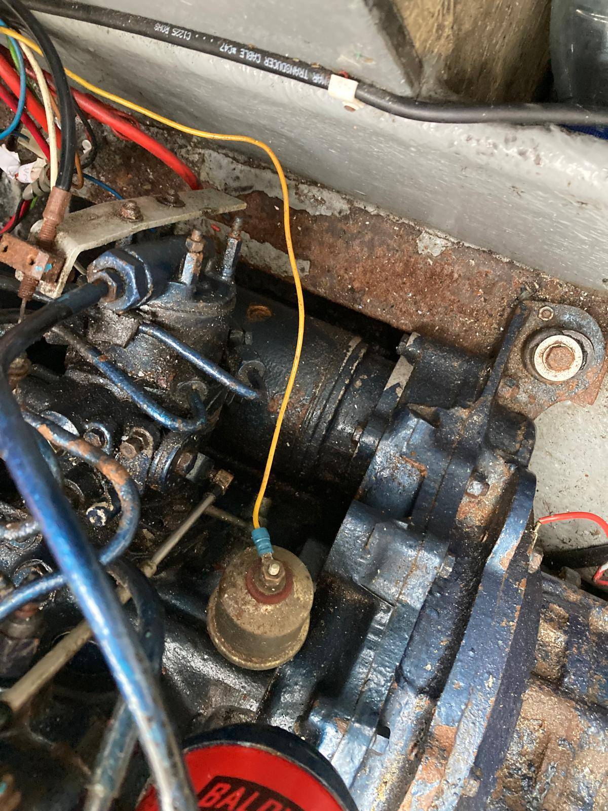

Two quick questions, picture number 1 whatszat!!!!!! I've labeled it 'dome shaped thing' but Im sure someone will tell me and laugh at the fact that I don't know. and 2. Does anybody know what torque setting the engine mounts and coupling should be at, so I have some idea of how much effort I can safely put into undoing them.

did you post the wrong photo? Nothing labelled as far as I can see. if you are calling the cylindrical thing with the yellow wire a dome shaped, then it is an electric oil pressure sender.

Thanks Tony, sorry not a very clear picture, yes it was the thing with the yellow wire on, I will change the label LOL.
