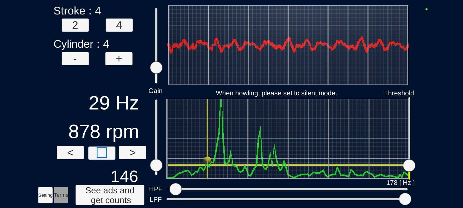

SiFi Posted September 3, 2024 Author Report Posted September 3, 2024 Measured tickover of 878 rpm using an app on my phone (measures the exhaust beat). I also had a closer look and found the tickover stop adjuster on the engine throttle. I was able to reduce the tickover a little to about 760 rpm without the engine becoming lumpy. I'm curious to see how this plays out.

MtB Posted September 4, 2024 Report Posted September 4, 2024 12 hours ago, SiFi said: I was able to reduce the tickover a little to about 760 rpm without the engine becoming lumpy. Getting on for 15% reduction in prop speed if my mental arithmetic is right. This will I suspect, make a noticeable reduction in the speed of the boat at tickover as the power of the blade changes with the cube of the shaft speed IIRC.
SiFi Posted September 4, 2024 Author Report Posted September 4, 2024 (edited) I'm conscious that the lowest rpm on my build of engine is rated at 850rpm so I may be over egging it! I will run the boat out and see whether the ~15% helps with the low speed handling of my boat. Edited September 4, 2024 by SiFi
IanD Posted September 4, 2024 Report Posted September 4, 2024 8 hours ago, MtB said: Getting on for 15% reduction in prop speed if my mental arithmetic is right. This will I suspect, make a noticeable reduction in the speed of the boat at tickover as the power of the blade changes with the cube of the shaft speed IIRC. About 15%... 😉 (prop power proportional to rpm^3 + engine power proportional to speed^3 = speed proportional to rpm 🙂
