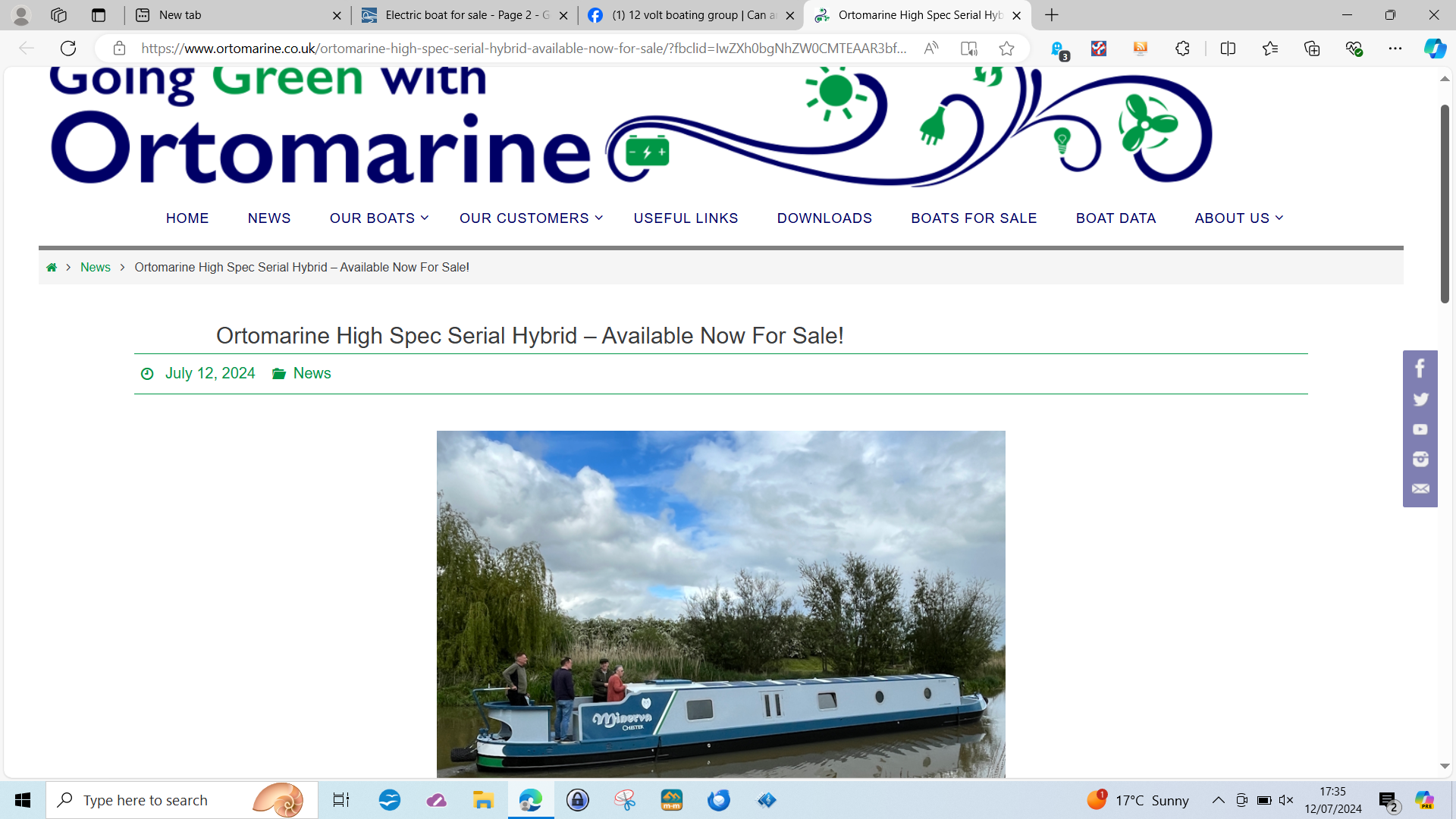

1 minute ago, peterboat said:
He is moving abroad so cant take it with him, what surprises me is the size of the battery bank its 600ah which is smaller than my leisure battery bank!
But its got a lot of solar and a reasonable genny plus its not been used
True but you need batteries to store all that electric its making
It's probably 48V though, not 12V... 😉
Kwh would be better
Indeed, and I expect it's 30kWh of LFP...
So how many full charges would this be equivalent to
 2.4kW of solar panels on the roof (which have generated nearly 1.5 Mega Watts of power since launch)
Solar panels that can provide 1.5MW wouldn't fit on any canal boat... 😉
(I expect they meant 1.5MWh...)
2.4kW of solar would be expected to average about 8kWh/day in summer, so 1.5MWh would need about 6 months of summer days -- and be equivalent to 50 full charges from 0% to 100% SoC.
None of which helps if the sun doesn't sodding shine in the summer, like now -- in the last 12 days we've managed 48kWh of solar which is 4kWh/day, about half the expected number... 😞
(generator has averaged 13kWh/day which is higher than expected for the same reason)
