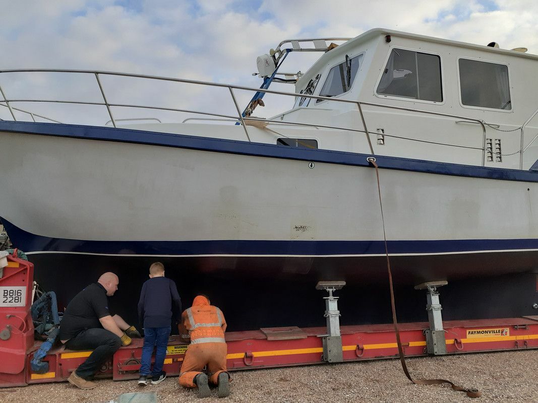

When my boat was moved even with everything folded down it was still too high when on a standard truck. We had to hire a special (very special) low loader that had a hydraulic bed that was certified to be road-safe when be lowered to 100mm road clearance, everytime they came to a bridge they had to drop the bed, drive thru and then lift it again. Good job we had escorts as well.
