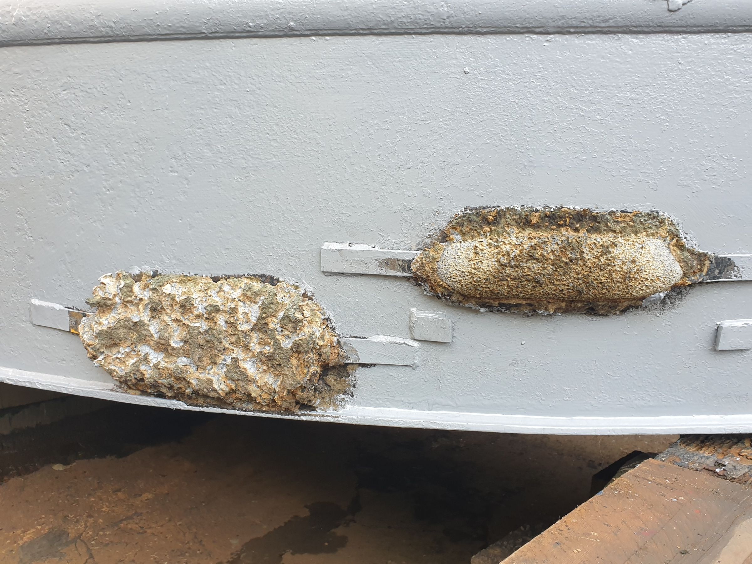

Greg & Jax Posted February 5 Report Share Posted February 5 Hi all . My boat is out to have the Hull painted and the corrosion on the anode,s look odd , these have been on about 8 years I do have more on and they look normal . Just wondered if anyone can shed some light on it . Regards Greg. Link to comment Share on other sites More sharing options...

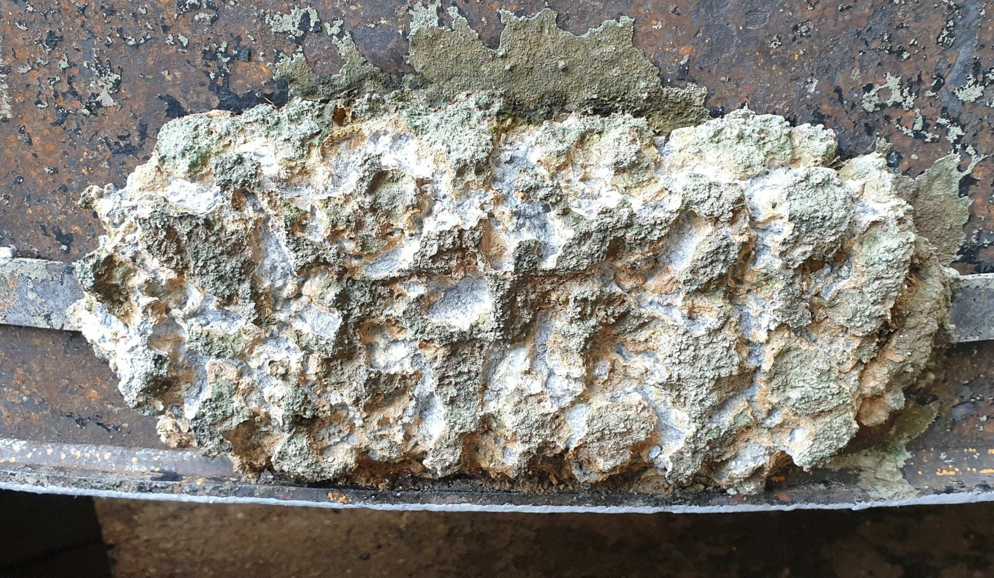

Alan de Enfield Posted February 5 Report Share Posted February 5 To me that looks like an anode that is working (doing its job). Do the other anodes look as if they are still new or just partly 'worn' ? For comparison : Link to comment Share on other sites More sharing options...
Greg & Jax Posted February 5 Author Report Share Posted February 5 Hi Alan, The left hand anode is about 8 years the right one about 3 years old . Link to comment Share on other sites More sharing options...
Alan de Enfield Posted February 5 Report Share Posted February 5 (edited) I'd suggest that in another 4 or 5 years the 'new' one will look like the 'old' one. Anodes can develop a 'crust' (white 'rust') which stops them working and they do need cleaning on a semi-regular basis. A wire brush is enough to remove the 'rust' Recommendations are that an anode should be replaced when it has reduced by about 1/3rd - 1/2 as the weight reduction will no longer give you sufficient coverage. It is possible to 'over anode' a boat and ideally the old anodes should be removed when new ones are attached. 'Over anoding' a steel or aluminium boat can have serious detrimental effetc on the hull. Having an excessive number of sacrificial anodes installed on your boat can lead to unintended consequences. Boats with fiberglass hulls are less likely to be affected by over anoding, but wooden and metal hull boats are particularly susceptible to the negative effects of over anoding which include: Burnback and discoloration Paint delamination and flaking Caustic wood rot (Source : PBO) Edited February 5 by Alan de Enfield Link to comment Share on other sites More sharing options...
Greg & Jax Posted February 5 Author Report Share Posted February 5 Thanks Alan. I will leave them as they are and see how they look next time round .👍 1 Link to comment Share on other sites More sharing options...
