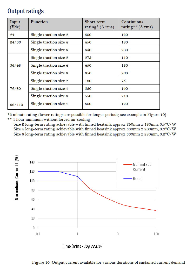

The other thing that affects the usable power ratings -- short and long-term -- is the controller used. I'll use numbers for the Sevcon Gen 4 Size 6 since I have a detailed data sheet for this, the relevant page is attached. This is rated at 650A peak (for 2mins) but this drops to 260A continuous when air-cooled -- however when water cooled (like Finesse do) the long-term limit will be much higher, certainly higher than the motor (380A). I don't know what controller you used but given that your TEMA motor is air-cooled I expect the controller will be as well -- is this the case?
At lower rpm the power also drops as rpm^3, so for cruising at 3kW the motor would be running at 630rpm. So we now have the following for this optimum-sized (17.5" x 11.7") prop:

This is pretty close to what Ricky Lee at Finesse does, he's built a *lot* of hybrid boats and these have been tested at full power for a couple of hours or more by both Finesse and customers (e.g. going up the Trent, out in the Wash) -- but note that both motor and controller are water-cooled to allow this.

Now looking at your TEMA 132-12, the continuous torque rating is 111nm which at 1000rpm means 11.5kW, for this Vicprop suggests 17.3" x 11.7" -- almost exactly the same as for the Engiro (and Beta 43). Assuming the same peak/continuous torque ratio as the SPM132-1 (175/70=2.5:1) the peak torque for the SPM132-12 will be 276nm. Doing the same calculations as above, we get:

So the maximum power for emergencies and rpm for cruising are very similar to the Engiro, but the continuous power *with a prop sized like this* is 23% lower -- this is because water cooling allows higher continuous powers, exactly as you said 🙂

Especially with electric motors, overpropping also reduces power output, and by more than with diesel engines because the torque is flat where diesel engine torque rises as rpm falls below peak power.
There's no effect on manoeuvrability or stopping *so long as you use higher rpm*, power delivered into the prop is what matters -- in fact *if* you go up to maximum rpm an oversized prop will stop more slowly. People are reluctant to do this with diesels because of noise and vibration, hence the idea that a bigger prop gives better stopping power -- this comes down to "bollard pull" which is typically about a ton per 100hp regardless of prop size and rpm.
