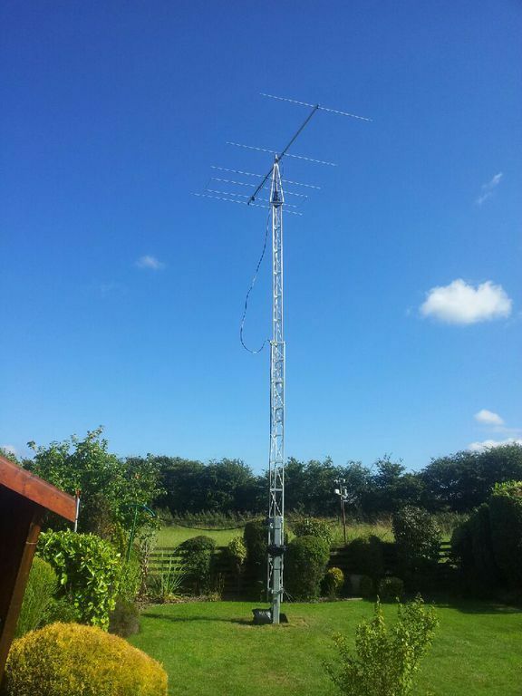

GUMPY Posted December 16, 2021 Report Posted December 16, 2021 What you need is a 60ft versatower 😱 Used to have one at my old house, the one below is only a 2section 40ft tower.
IanD Posted December 16, 2021 Report Posted December 16, 2021 3 minutes ago, Loddon said: What you need is a 60ft versatower 😱 Used to have one at my old house, the one below is only a 2section 40ft tower. I'll see your 40', and raise you 120'... https://www.willburt.com/products/telescopic-masts/pneumatic-locking/non-military/
tree monkey Posted December 16, 2021 Report Posted December 16, 2021 Now I've had my booster I recon I must be able to create my own 5g signal, so heres the deal, I will stand on the roof of your boat for £200 an hour if you find yourself short of a signal for that vital work zoom meeting
GUMPY Posted December 16, 2021 Report Posted December 16, 2021 22 minutes ago, IanD said: I'll see your 40', and raise you 120'... https://www.willburt.com/products/telescopic-masts/pneumatic-locking/non-military/ Is that in your back garden 😉
