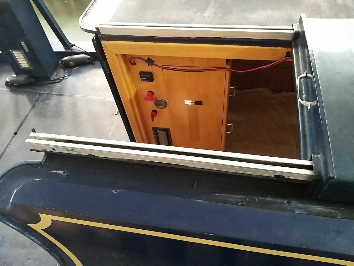

blackrose Posted September 29, 2021 Report Posted September 29, 2021 (edited) The first thing I'd be looking at is the hatch runners. Rainwater can collect on the exposed part of the runners and then run back under the hatch and into the boat. It happens on lots of different boats from different builders. If that is the issue the solution is fairly simple: assuming they're brass runners you cut a groove or slot into the runners just in front of the hatch at 45 degrees which will divert the water off the runners and onto the roof before it can get under the hatch. An angled cut is essential to ensure your sliding hatch still works. Don't cut at 90 degrees! Have a search on the forum as there are probably some pictures of how people have done this fix. I actually took a 5mm strip out of the brass runners but that might be a bit OTT. I think others have just put a blade thin groove in with a hacksaw. Edited September 29, 2021 by blackrose 2

matty40s Posted September 29, 2021 Report Posted September 29, 2021 (edited) If we are talking rear hatch, then the East Wests had a bespoke hatch runner which very closely resembles a sliding patio door runner, so closely in fact that it is. The leak is probably from the forward end of the hatch where the wood usually drops below the metal down part and rots away....usually at the centre of the boat side. The central runner is also not far above the roof height either, and if the sealant has degraded, can let water in via capillary action. You will need to remove the old piece of wood, and fabricate a new one....weatherproofing it well. The other area of water ingress is where the hatch sits over the door.....water sometimes gathers on the door top, then dripping inside. You will also need to keep the drain holes in the step(if you have one or more) clear, as otherwise heavy rain can fill the step and flow into the boat under the door Edited September 29, 2021 by matty40s 1
Parnz62 Posted October 7, 2021 Author Report Posted October 7, 2021 All sorted....it was a leak through the hatch runner as matty40s suggested, took the rail off and screwednirt back down onto a rubber gasket seal, then sealed the gaps for good measure. We has torrential rain yesterday and dry as a bone inside! Thanks for the advice!! 2
