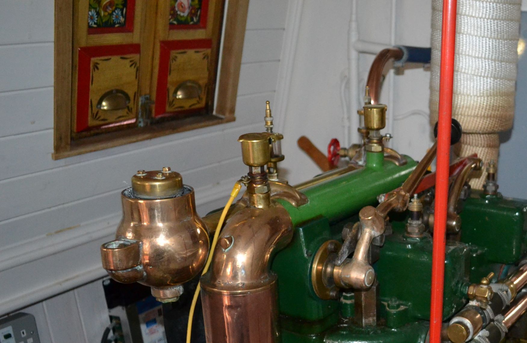

Mdmyatt Posted June 2, 2021 Report Posted June 2, 2021 (edited) Aup, just had my boat safety and failed due to the wrong fuel pipe on the spill rail. Currently it’s a 6mm od clear hose with push fit connections. Looked everywhere but can’t find any 6mm Od iso 7840. Just wondering what everyone else has done as I imagine I’ll have to replace all connections and think of something else. Edited June 2, 2021 by Mdmyatt Wrong word

David Mack Posted June 2, 2021 Report Posted June 2, 2021 3 hours ago, Tracy D'arth said: 6mm copper and brazed connections. Agreed. Brazed or silver soldered connections. Soft soldered joints are also a fail.
0000 Posted June 3, 2021 Report Posted June 3, 2021 Agree with others, use 6mm copper and to make things easier, you could use compression fittings. (note: its not a "spill rail", its the air/petrol intake pipe and the pipework you are referring to is the diesel feed to the thermostarts). On my thermostarts, I just have a small reservoir on each unit which more than supplies enough diesel to get her started so maybe an option for you.
Tony Brooks Posted June 4, 2021 Report Posted June 4, 2021 10 hours ago, BrandyMark said: Agree with others, use 6mm copper and to make things easier, you could use compression fittings. (note: its not a "spill rail", its the air/petrol intake pipe and the pipework you are referring to is the diesel feed to the thermostarts). On my thermostarts, I just have a small reservoir on each unit which more than supplies enough diesel to get her started so maybe an option for you. Thanks for that info. I have been looking at the image all day trying to work out what it was, made no sense to em as a spill rail.
Tracy D'arth Posted June 4, 2021 Report Posted June 4, 2021 10 hours ago, BrandyMark said: Agree with others, use 6mm copper and to make things easier, you could use compression fittings. (note: its not a "spill rail", its the air/petrol intake pipe and the pipework you are referring to is the diesel feed to the thermostarts). On my thermostarts, I just have a small reservoir on each unit which more than supplies enough diesel to get her started so maybe an option for you. This is probably the easier way to go. Would the thermostarts pass BSC without being piped? I can see no reason why not, a few teaspoons full of diesel has got to be safer than a plastic fuel line and push fit fittings.
Mdmyatt Posted June 6, 2021 Author Report Posted June 6, 2021 Sorry been in a tent in the woods in the middle of know where, just got back! I’ve been given some fittings and some 1/4 pipe just to get me through the bs, gives me some time to do a proper job sorting it out, It definitely looks like copper or the pot option is the way to go. It was the bs guy who called it a spill rail, apologies. Photo is pre eared o clamps.

koukouvagia Posted September 9, 2021 Report Posted September 9, 2021 I had at various times these two arrangements. The first one shows a feed tee-ed off the day tank; the second one just has a simple reservoir.
