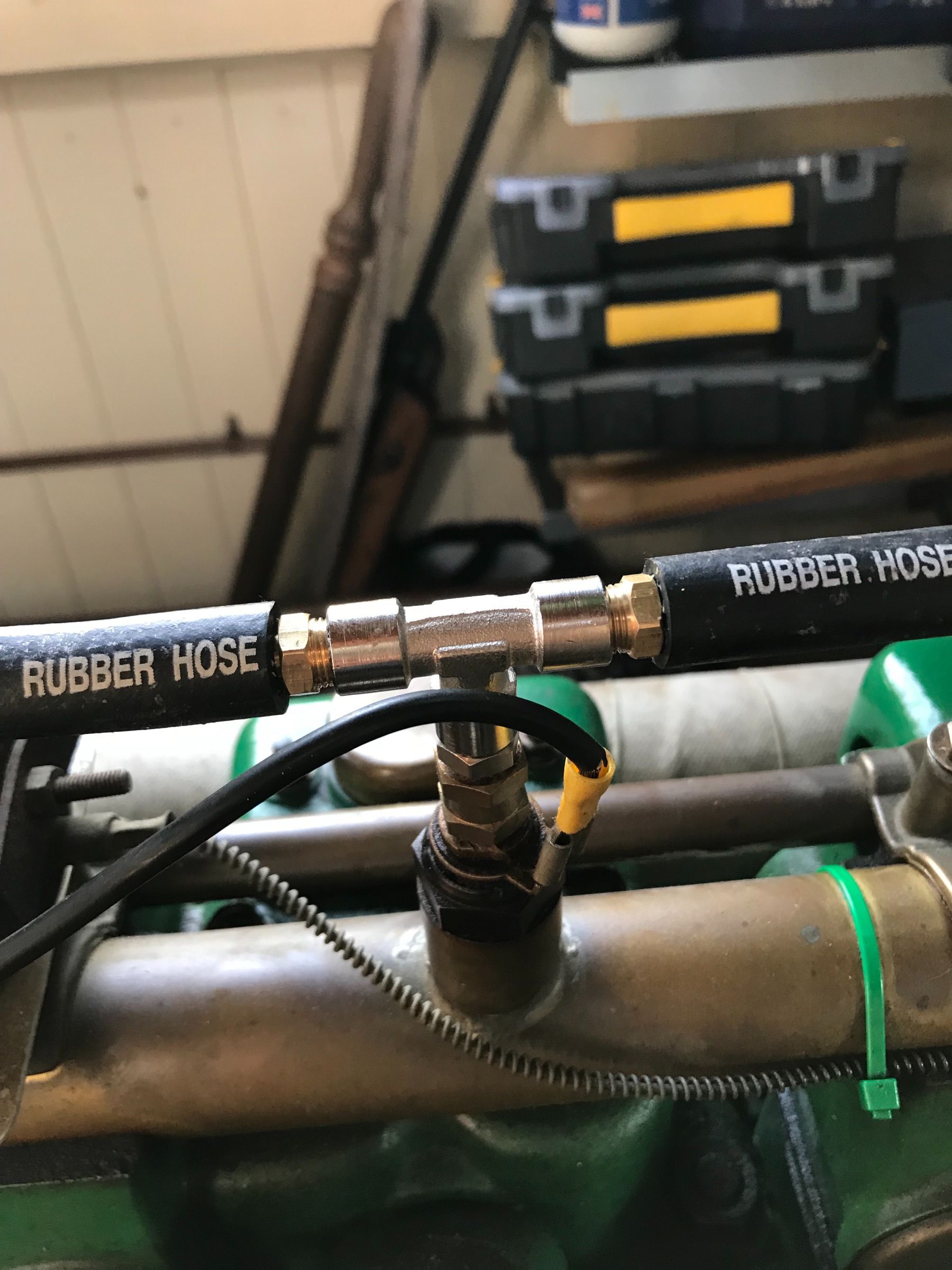

  1. Sorry been in a tent in the woods in the middle of know where, just got back! I’ve been given some fittings and some 1/4 pipe just to get me through the bs, gives me some time to do a proper job sorting it out, It definitely looks like copper or the pot option is the way to go. It was the bs guy who called it a spill rail, apologies. Photo is pre eared o clamps.

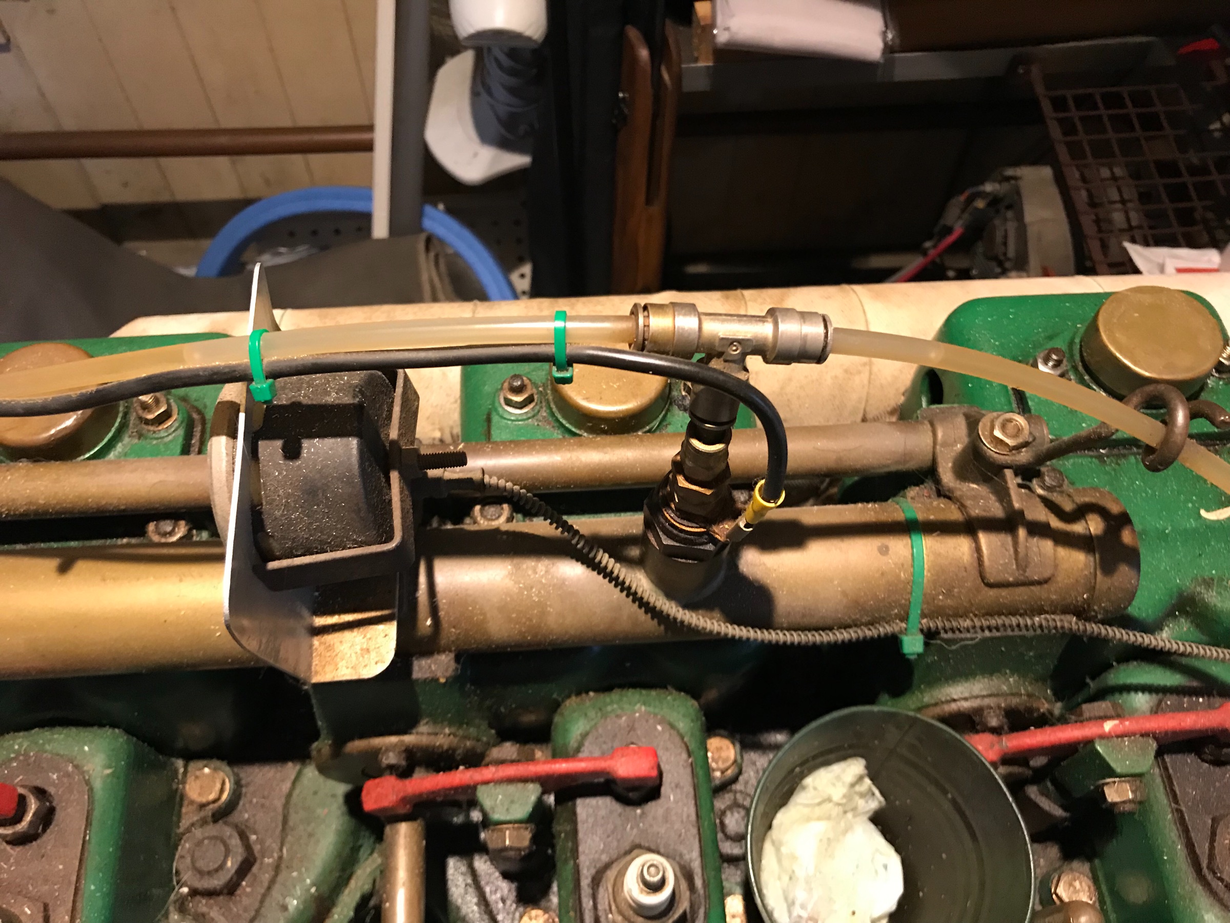

  2. Aup, just had my boat safety and failed due to the wrong fuel pipe on the spill rail. Currently it’s a 6mm od clear hose with push fit connections. Looked everywhere but can’t find any 6mm Od iso 7840. Just wondering what everyone else has done as I imagine I’ll have to replace all connections and think of something else.
