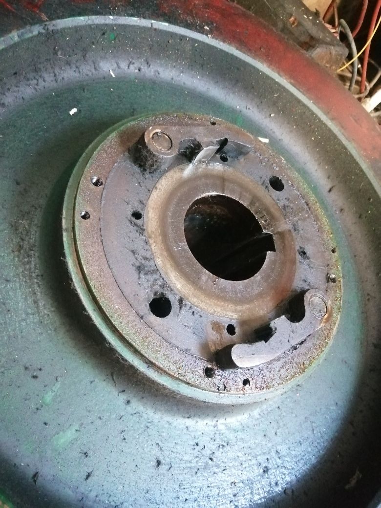

Just to update this thread. I found an industrial JS3 and bought that thinking it ideal because it would supply a flywheel for my friends boat and an engines worth of spares for the JS in Prince.
However.
Having just got both flywheels off I can see that the reverse sides are quite different. I was expecting the JS one to have no provision for the hand start mechanism and suspected I'd have to fabricate an adaptor to take the JP sprocket etc.
On further investigation though, not only is the rear hub substantially smaller diameter but crucially the tapered section is actually about 3/4in deeper than on the JP, meaning the widest point of the taper is wider on the JS flywheel than the other one.
To further complicate matters it looks like that, depth of taper is pretty important as the flywheel seems to close up tight to the crank end seal housing so a deeper taper would just hit that housing and not tighten..
I have included some photos here so hopefully people will understand what I'm getting at!
Any advice on this matter would be much appreciated!
The f/wheel with the starter ring looks to have separate parts where the hand start pawls would be. Also, that looks like a  taper sleeve fitted  in the centre, I don't know why, unless the  taper has been damaged at some point and repaired by boring out and fitting the sleeve
See you soon!
See you soon!
Let's have a look later!

Just to let everyone know that I finally got the electric start sorted. I bought a JS3 industrial engine and used the flywheel from that but it had a different reverse side so the hand start gear would not fit.
To remedy this I designed an adapter plate on cad and got that laser cut/machined.
This allowed me to refit the had start gear, reinstall the flywheel and fabricate a bracket for the starter.
I'm happy to say that it starts well and runs fine.
If anyone is doing the same and wants a copy of the cad file I'd be happy to send it.
