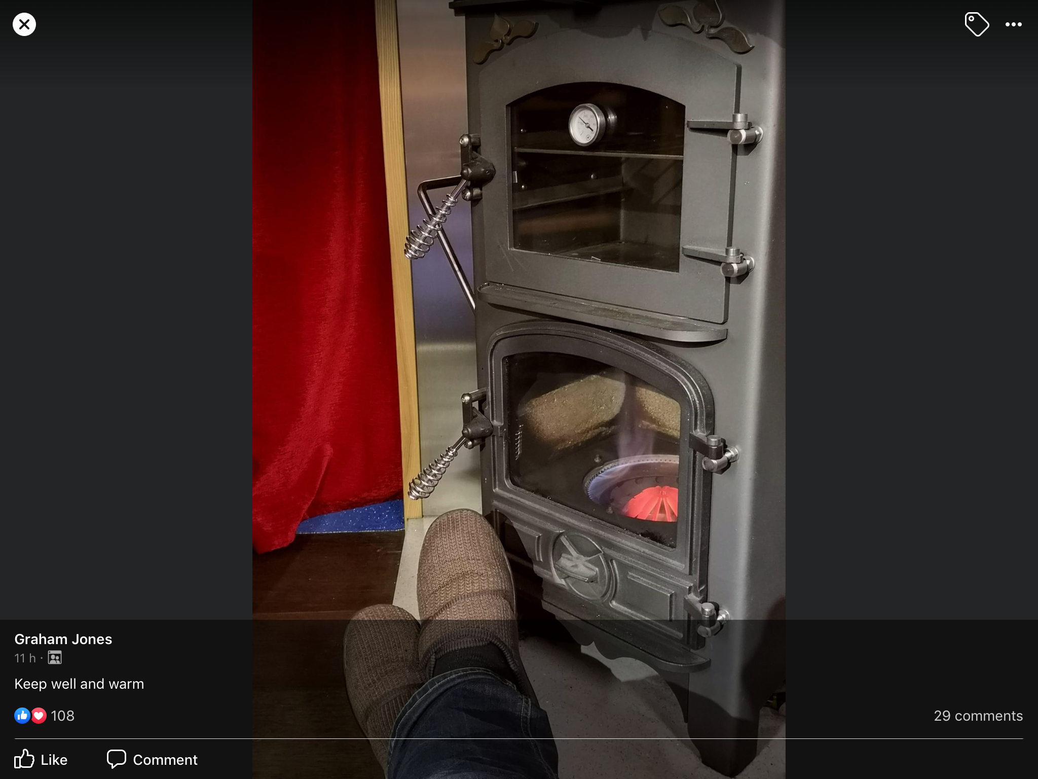

No it isn't the bubble stove does exactly what he wants it's a stove with oven and back boiler plus its front won't fall off in time as its heavy gauge steel.  They are quality stoves and been around for many years
I went "round the back" at Harworth Heating and was talking to a lad assembling one of their oven/stoves. They are well made, same size as an Epping but more modern appearance. I think you can choose from a few colours and finishes.
They are however very expensive!
They do both an "over and under" and a more conventional "side by side" that looks rather good. Sadly to fit in with the existing decor our cabin stove needs to be rather shallow and have the flue central rather than offset to one side, otherwise I would have thought seriously about the Bubble. The boat came with a Stratford range that looked great but did not make enough heat and instead put fumes and CO into the boat I wish I could find a modern steel replacement.
