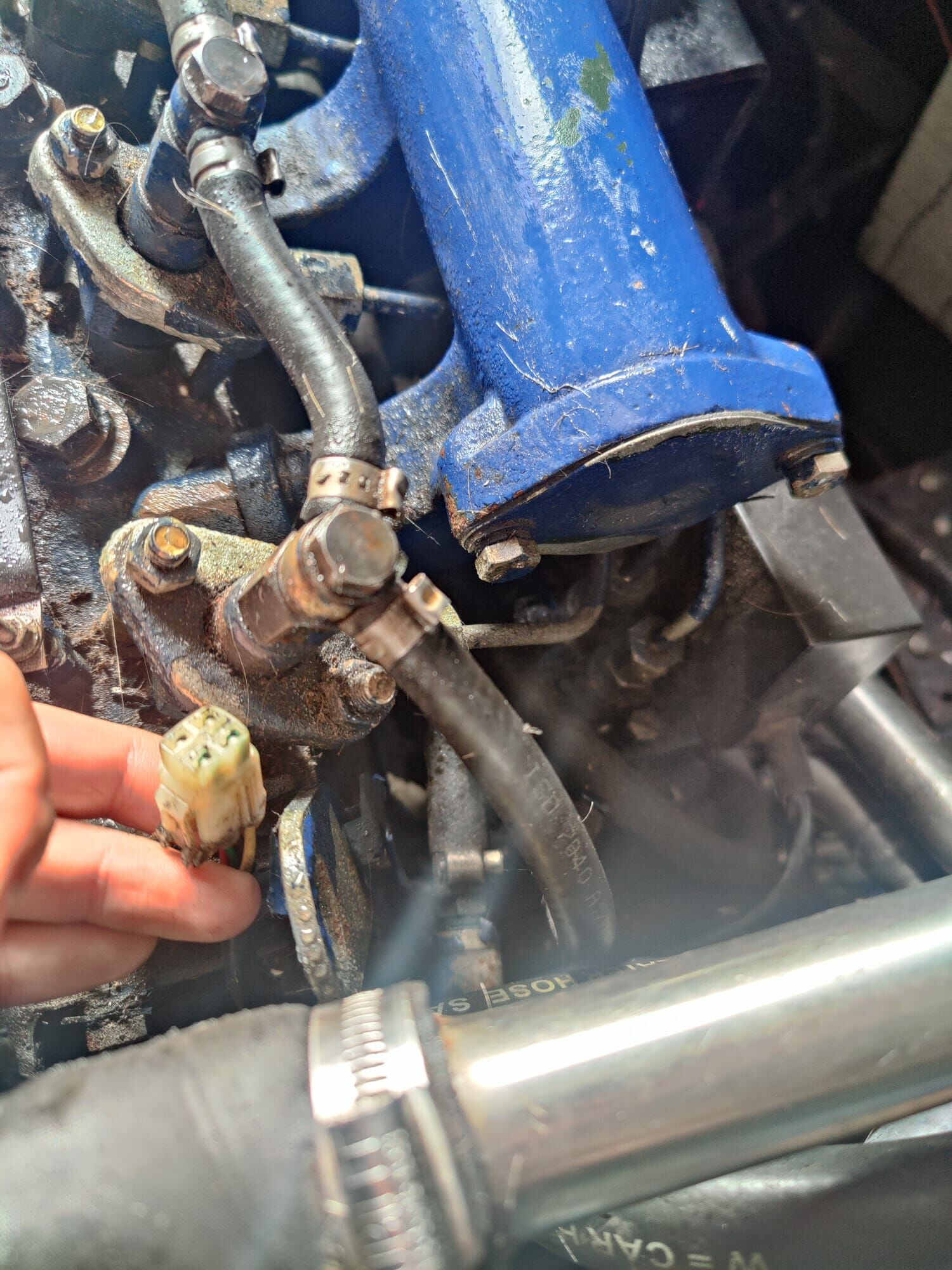

Hi all, just an update. We has an engineer come and he said the solenoid was toast. He has installed a stop switch away from the engine now and the engine can be stopped remotely. In the future i'd like to have a cover made so the engine is not open but for now this should suffice. Thanks for all the advice. 👍 -
Yeah so the solenoid was dead apparently, we've had a pull stop installed and now able to stop the engine remotely. I'll update the main thread now.

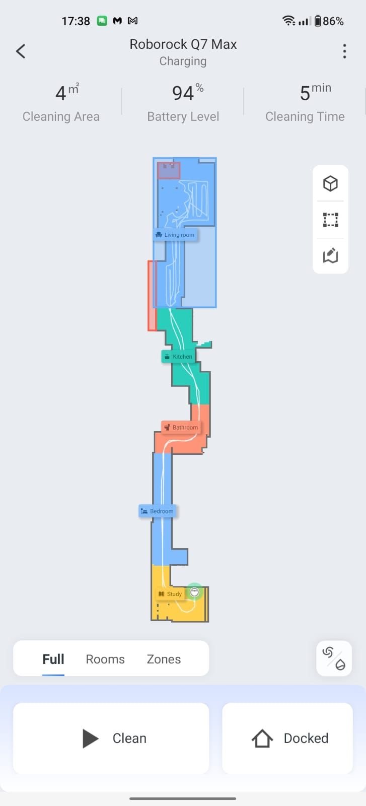

So i got one and its doing a good job so far, but it will require a bit of fine tuning to get it perfect. It has mapped out the boat nicely, the pics below are just a sample run of it doing the saloon area. The configuration options are good and with some adjustments it should be a good little boat upgrade hopefully.

Apologies for the late reply, so it turns out the stop solenoid already on the engine and it was disconnected from the loom. Previous owner never bothered to mention this... I reconnected it but no luck so i'm guessing it could be a new solenoid required? Either way its a bit late now, but the sooner i fix it the better. -

I'm totally unsure how many cables go into the plug, the plug is all i have to go on. The solenoid itself is this one: https://shireshop.co.uk/en-GB/catalog/all/part/3rAF-yy0D-czYG/shire-shanks-catalogue-dash-panels-electrical-stop-solenoid-4l22bz-13300 I'm almost certain that energising the solenoid will cause it to stop, as it is currently open and it it contracted it would mechanically pull the stop lever on the engine, which until now has been turned manually by hand. Cheers, I'll do this as a temporary measure until i sort out something permanent. Also there is no wiring diagram or owners manual. 👍 -
Hi all, my girlfriend has a barrus shanks engine on her narrowboat, but the only way to turn it off if by leaning over the running engine and turning a lever using her hand. I felt this was extremely dangerous and it turns out I was right, as she has had quite a serious accident when the fanbelt caught on her and caused her a serious injury. I want to sort out a way to stop the engine in a safe manner, I've been looking at the engine and have found a stop solenoid attached to the lever which is terminated at a 4-pin plug. Does anyone know if it is possible to get a button or switch for this plug which i can route to a safe location? I've tried looking around google but haven't come up with anything. Thanks for any and all advice!
