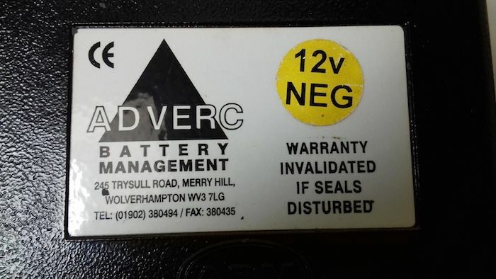

Tony Brooks Posted July 29, 2022 Report Posted July 29, 2022 10 hours ago, davidb said: Because the alternator voltage is being reduced by the diode and the Adverc is not compensating for it, even when the sense wire is connected on the battery side of the diode. "do you know about positive and negative rotor control?" Obviously not, maybe the new alternator I got last year was modified wrongly? So after about an hour or so, longer with very discharged or faulty batteries there are no signs of the charging voltage and current moving up and down at roughly 20 minutes high and then 20 minutes low. The sense wire would normally be connected to a domestic battery, not the diode, but I doubt that would stop the Adverc working. In view of how you seem to have the diode wired I think that there might be a mistake in the Adverc wiring so please double-check that it is as Adverc say it should be. I also don't know why you persist with a split charge diode when a VSR and a small rewire would do away with any volt drop problems (as long as the charging cables are large enough and all connections are good). The alternator's own regulator can be placed in the circuit on the positive side of the rotor or the negative, most probably have it in the negative. That is between the rotor and the case/negative. The Adverc is T'd into that circuit between the rotor and the alternator's own regulator. Now the more complicated bit. With discharged batteries when you first start and rev the engine the alternator's regulator will just sit there acting like a closed set of contacts so the voltage on that green fly-lead should be zero or very close to it with the meter between the fly-lead and negative. Once the batteries are charged enough for the alternator's regulator to starts working it keeps turning itself on and off at a maybe 160 times a second. It alters the mark-space ratio (turned on - turned off) of the connection to negative to control the average current in the rotor and thus the output. What this means is that the voltage on the fly-lead could be anything between zero (regulator conducting) and battery voltage (regulator off). No electricity ever goes into the fly-lead. Now what the Adverc does: At first start up the Adverc is probably acting just like the alternator's regulator, that is fully turned on so the rotor carries its maximum current, but at that stage the alternator is working flat out with the high current depressing the voltage (that's just the way alternators work). Eventually the alternator's regulator will start trying to regulate the rotor current but at this point the Adverc is still conducting the full rotor currant to negative so the charging voltage continues to climb until the Adverc regulation voltage is reached. At that point the Adverc starts turning the rotor current on and off but at a higher voltage than the alternator's regulator. It will do this for 15 to 20 minutes and then turn itself off for 15 to 20 minutes, leaving the alternator's regulator to do the voltage regulation. If regulated voltage is never reached for some reason the Adverc can do nothing. It will just sit there. Now, as long as your alternator is negatively regulated, it is vital you check, you can temporally connect the fly-lead to negative with the engine running with well charged batteries and the charging voltage should go jump up. Make sure all 12V equipment is turned off because you could easily get 20v or more until you disconnect that lead. If that happens the alternator is fine and if when the fly-lead is reconnected the charging voltage does not rise and fall at 15 to 20 minute intervals the Adverc is wrongly wired, faulty, or for some reason the Adverc set voltage is too low. If the regulation is in the positive side I would expect charging voltage on the fly-lead until the regulator started regulating and then the voltage will vary according to the way the regulator is working. Now a bit I am less sure of. In the case of positive regulation I think that with the engine running and well charged batteries the output would go uncontrolled if you connected the fly-lead to battery voltage. I think in that case putting a variable voltage into the fly-lead might do what you seek, but it won't work on a negative regulation circuit.
davidb Posted July 29, 2022 Report Posted July 29, 2022 1 hour ago, Tony Brooks said: So after about an hour or so, longer with very discharged or faulty batteries there are no signs of the charging voltage and current moving up and down at roughly 20 minutes high and then 20 minutes low. Thanks, Tony for an easy -to - understand explanation, I'll go through it all later and ring the people who modified the alternator. No, I have been watching for the Adverc cycling it, but it doesn't. It must be a negative controlling Adverc according to its label:
Tony Brooks Posted July 29, 2022 Report Posted July 29, 2022 (edited) 39 minutes ago, davidb said: Thanks, Tony for an easy -to - understand explanation, I'll go through it all later and ring the people who modified the alternator. No, I have been watching for the Adverc cycling it, but it doesn't. It must be a negative controlling Adverc according to its label: I agree, negative controlled, so should be OK to carefully short that fly-lead to the alternator case with the engien running while watching the battery voltage. Once the Adverc is working you can persuade it to boost the charging voltage by putting a couple of diodes is series in the sense lead. That will boost the charging voltage but might either illuminate an over voltage warning lamp or the Adverc may shut down. Possibly easier than tweeking the Averc motherboard. This may help you sort things out if you do not have the original manual: http://fullsail.done-that.com/Docs/8. Boat Documentation/4. Manuals/Adverc_installation_basic.pdf I think that you will see their diagram for a split charge diode is different to the way yours is wired but I think, with a bit of guessing as to where the cables go, yours should work. It does mean that one can't be sure about any of the wiring. Edited July 29, 2022 by Tony Brooks
dmr Posted July 29, 2022 Report Posted July 29, 2022 To repeat wot Tony said, if the Adverc is set to a lower voltage than the alternators internal regulator then it will do nothing because it can only increase the voltage. Trojans like about 14.8 volts so the Adverc should provide this during the high part of its cycle. Its relatively easir to get into the Adverc and adjust the voltage but this will require breaking any seals, no big deal if its already out of warantee. The Adverc should have its own indicator lamp in addition to the standard ignition lamp. This should be on before the engine starts and will flash to indicate (some) faults.
davidb Posted July 29, 2022 Report Posted July 29, 2022 21 minutes ago, dmr said: The Adverc should have its own indicator lamp in addition to the standard ignition lamp. This should be on before the engine starts and will flash to indicate (some) faults. Yes, it does have one and it acts just like the ignition lamp, and it is the left hand lamp on the box I added with the bypass relay below, and the one thing that changed when I fitted it was that the alternator kicks in immediately the engine starts rather that as it was before when I had to rev it a bit to clear the ignition light:
Tony Brooks Posted July 29, 2022 Report Posted July 29, 2022 6 minutes ago, davidb said: 33 minutes ago, dmr said: Yes, it does have one and it acts just like the ignition lamp, I have a feeling that means it is an old Adverc. I think on mine (about 2001) it stayed off unless there was a fault. I only saw mine on once when a field diode fault sent the voltage too high. Maybe the Adverc has died of old age but if it were mine and all the wiring is as per the diagrams I would see if I could get the board out of the thing and try to resolder all the pads to the pins. There is a chance a joint has just broken with age. Low lead solder is known to be prone to that.
davidb Posted July 29, 2022 Report Posted July 29, 2022 7 hours ago, Tony Brooks said: you can temporally connect the fly-lead to negative with the engine running with well charged batteries and the charging voltage should go jump up When I get back to the boat I shall disconnect this fly lead and measure the voltage on it with engine running through start-up to full voltage, that might tell me which side of the rotor it is connected. The red Adverc sense lead is extended right the way to the battery + terminal. I have rung the new alternator supplier and am going to send them a photo of their connection in it and see if I can change it, alternatively take it back to them to do it. Luckily, I have a spare standard alternator that I can fit meantime. "Once the Adverc is working you can persuade it to boost the charging voltage by putting a couple of diodes is series in the sense lead". that sounds like a good idea, I'll get some ready to take. "Trojans like about 14.8 volts so the Adverc should provide this during the high part of its cycle." that is what I now aspire to, in order to keep my 4 new babies thriving.
dmr Posted July 29, 2022 Report Posted July 29, 2022 Just checked my Adverc, light comes on with ignition, goes off when engine starts. Absolutely no need to mess about with diodes, just adjust the Adverc voltage with its voltage adjustment. 4 screws to get into box, one obvious preset in the corner. I suspect the OP has the Adverc voltage set too low. Adverc has a LOT of components and a protective coating on the board, so resoldering pins not a good idea.
Tony Brooks Posted July 29, 2022 Report Posted July 29, 2022 44 minutes ago, davidb said: When I get back to the boat I shall disconnect this fly lead and measure the voltage on it with engine running through start-up to full voltage, that might tell me which side of the rotor it is connected. The red Adverc sense lead is extended right the way to the battery + terminal. I have rung the new alternator supplier and am going to send them a photo of their connection in it and see if I can change it, alternatively take it back to them to do it. Luckily, I have a spare standard alternator that I can fit meantime. "Once the Adverc is working you can persuade it to boost the charging voltage by putting a couple of diodes is series in the sense lead". that sounds like a good idea, I'll get some ready to take. "Trojans like about 14.8 volts so the Adverc should provide this during the high part of its cycle." that is what I now aspire to, in order to keep my 4 new babies thriving. Hang on, I am not sure which control side your alternator actually uses. I think the instructions I linked to shows how to tell, I trust following those instructions is what you mean by measuring the voltage on the fly-lead. Where did the Trojans like 14.8 volts come from? At that voltage they will be gassing although the Adverc cycling will minimize it. They certainly like regular equalization. I think regular charging at 14.8 volts will involve you in very regular battery topping up unless you have an automatic watering system.
dmr Posted July 29, 2022 Report Posted July 29, 2022 11 minutes ago, Tony Brooks said: Hang on, I am not sure which control side your alternator actually uses. I think the instructions I linked to shows how to tell, I trust following those instructions is what you mean by measuring the voltage on the fly-lead. Where did the Trojans like 14.8 volts come from? At that voltage they will be gassing although the Adverc cycling will minimize it. They certainly like regular equalization. I think regular charging at 14.8 volts will involve you in very regular battery topping up unless you have an automatic watering system. The 14.8 comes from the Trojan data sheet, though I have spoken to Trajan about getting them quickly charged in winter on a liveaboard boat and they suggested giving 15volts a go. I have the Adverc set to 14.8 volts on its higher voltage. I top the batteries up at engine service intervals which is 200 hours. However in summer when we are doing longish days almost every day I drop down to 14.6 volts. Four of my Trojans are now at the end of their life and use more water, and at the last 200 hour check the tops of the plates were just peeping out at me, but these are 6 years old on a full time off grid liveaboard.
