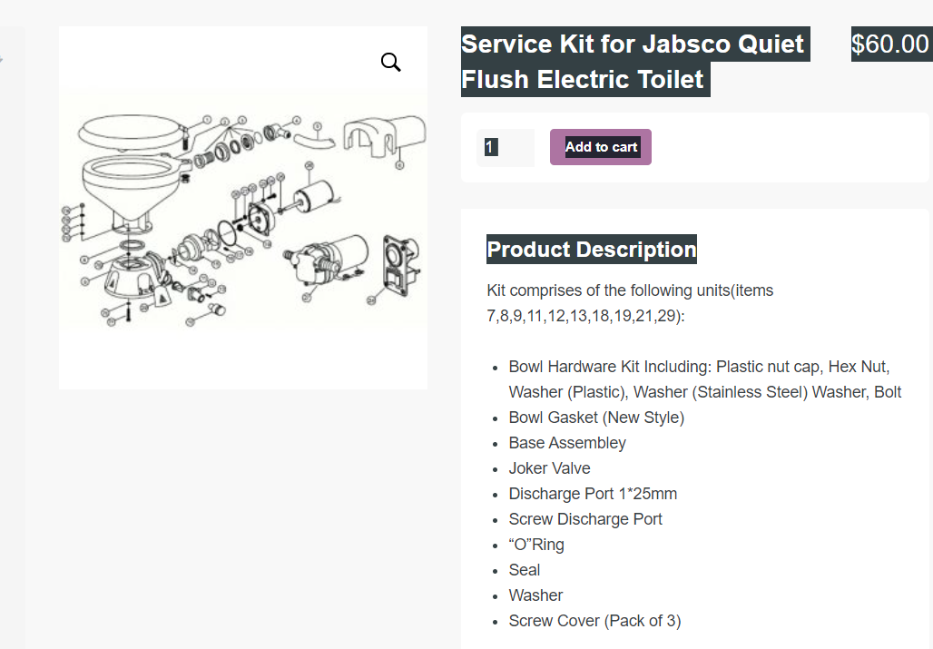

My Jabsco mascerator recommends replacing the joker valve every couple of years. I have done it once and it was easy, not filthy or over-smelly.
I've read about this, but my Jabsco Macerator exploded diagram doesn't show anything called a Joker Valve.  Does it masquerade under another name?

Thanks for this DC. The Joker is in that pack! Sadly, mine's different though. Can't remember what model (Deluxe or something) and Boris said that it's naughty to go to my boat so it may be a while 'til I find out. I appreciate your help though. :)
