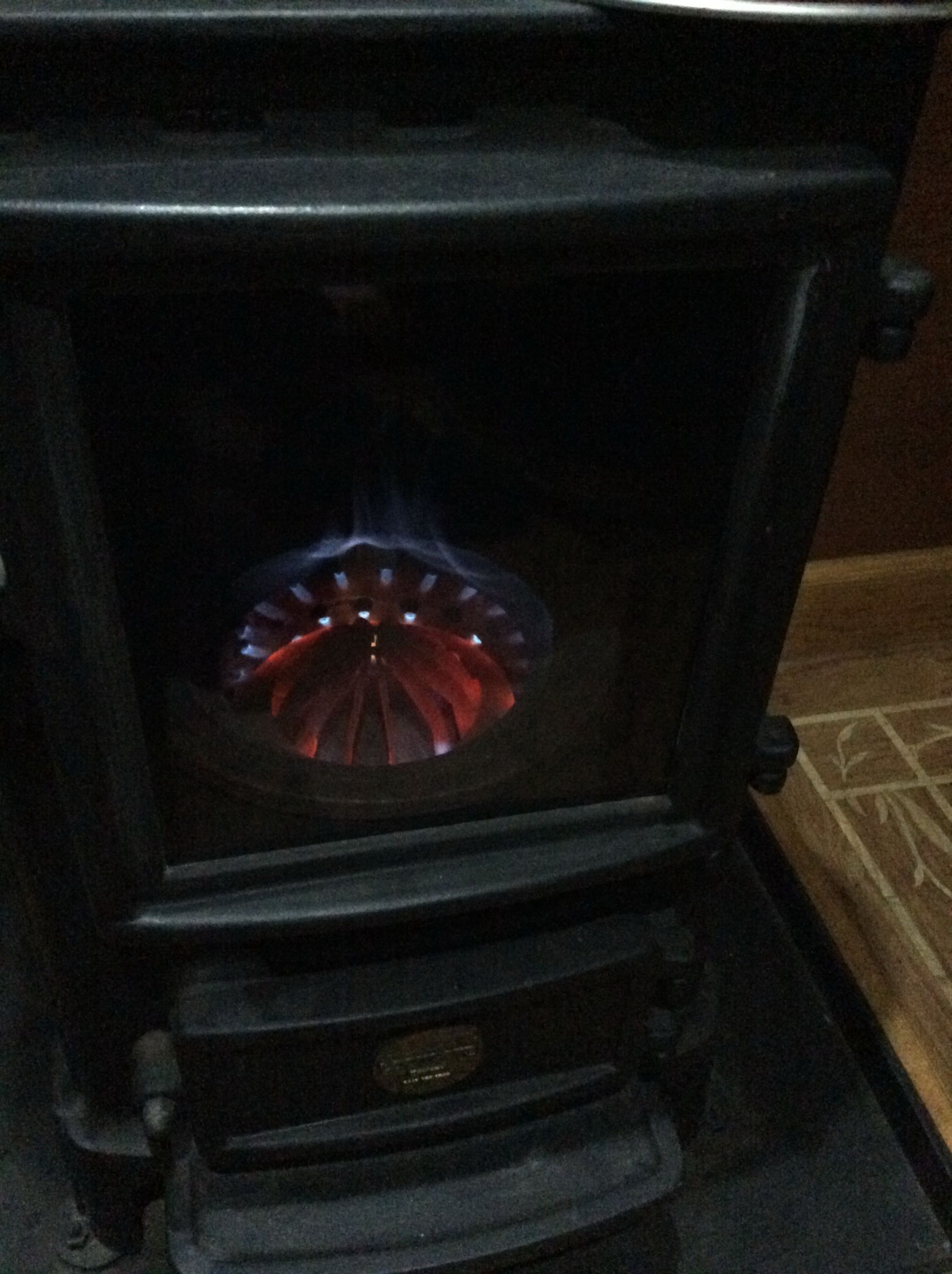

Mike Tee Posted October 31, 2022 Report Posted October 31, 2022 This is just above the lowest setting, no jumper required! And its over 20 years old. Admittedly it needed a good clean etc when we acquired the boat recently, but still all original. Sorry, not the best of photo's. 1
Tracy D'arth Posted October 31, 2022 Report Posted October 31, 2022 38 minutes ago, Mike Tee said: This is just above the lowest setting, no jumper required! And its over 20 years old. Admittedly it needed a good clean etc when we acquired the boat recently, but still all original. Sorry, not the best of photo's. That is the best flame picture of a drip feed burner I have seen in ages.
Guest Posted October 31, 2022 Report Posted October 31, 2022 1 hour ago, Mike Tee said: This is just above the lowest setting, no jumper required! And its over 20 years old. Admittedly it needed a good clean etc when we acquired the boat recently, but still all original. Sorry, not the best of photo's. Same as mine until the water incident! 35 minutes ago, Tracy D'arth said: That is the best flame picture of a drip feed burner I have seen in ages. Mine used to be the same stove has to be as level as possible, I used kerosene which is cleaner and hotter
