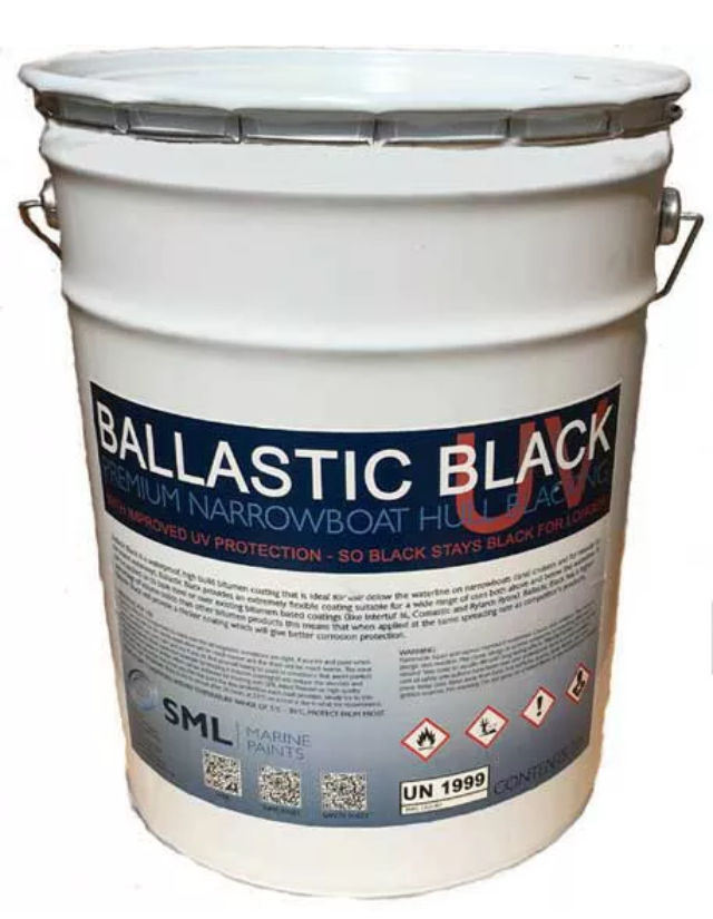

LS90 Posted August 14, 2020 Report Posted August 14, 2020 (edited) Hello everyone, I’m new to the forum, and I’m hoping to learn a little bit about SML Ballastic Black hull blacking. Has anybody on here got any experience of the product? My boat is due for blacking in September, I’ve been recommended this by a few boaters now and just wanted further opinions before ordering the product. Thanks ? Product description; Ballastic Black Premium Hull Blacking is a waterproof, high build bitumen coating that is ideal for use below the waterline as a hull blacking on narrow boats, canal boats and for vessels on the inland waterways. Bitumen products such as Ballastic Black provide an extremely flexible coating it can be applied on to bare steel or over existing bitumen based coatings. Ballastic Black has a higher percentage of volume solids than Intertuf 16, Comastic and Rylards Rytex. This means that when applied at the same spreading rate Ballastic Black will provide a thicker coating (in some cases 30% thicker) which will give better corrosion protection. Edited August 14, 2020 by LS90
pearley Posted August 14, 2020 Report Posted August 14, 2020 We used it 4 years ago. We were recommended by SML to put 2 coats if Vinyguard Primer on first, after pressure washing then 3 coats of Blacking which means a full 7 days in drydock . Was very impressed with it. It's quite thick so if you scrape something if sort of rolls it back rather than scraping it off. Even when scraped the primer stays put. 2 years ago we used it again but only one coat of Vinyguard, again as recommended. We're booked in again for this week again for Ballistic Black but a major power failure at the drydock meant we couldn't live aboard so cancelled. But will be using it when we rebook. 1

Slim Posted August 14, 2020 Report Posted August 14, 2020 I've used for my last 3? blackings at about 18 -24 month intervals. Protection seemed better than with other bitumens but that is a little subjective. Hope to come out again next spring when I will use it once more. 1
