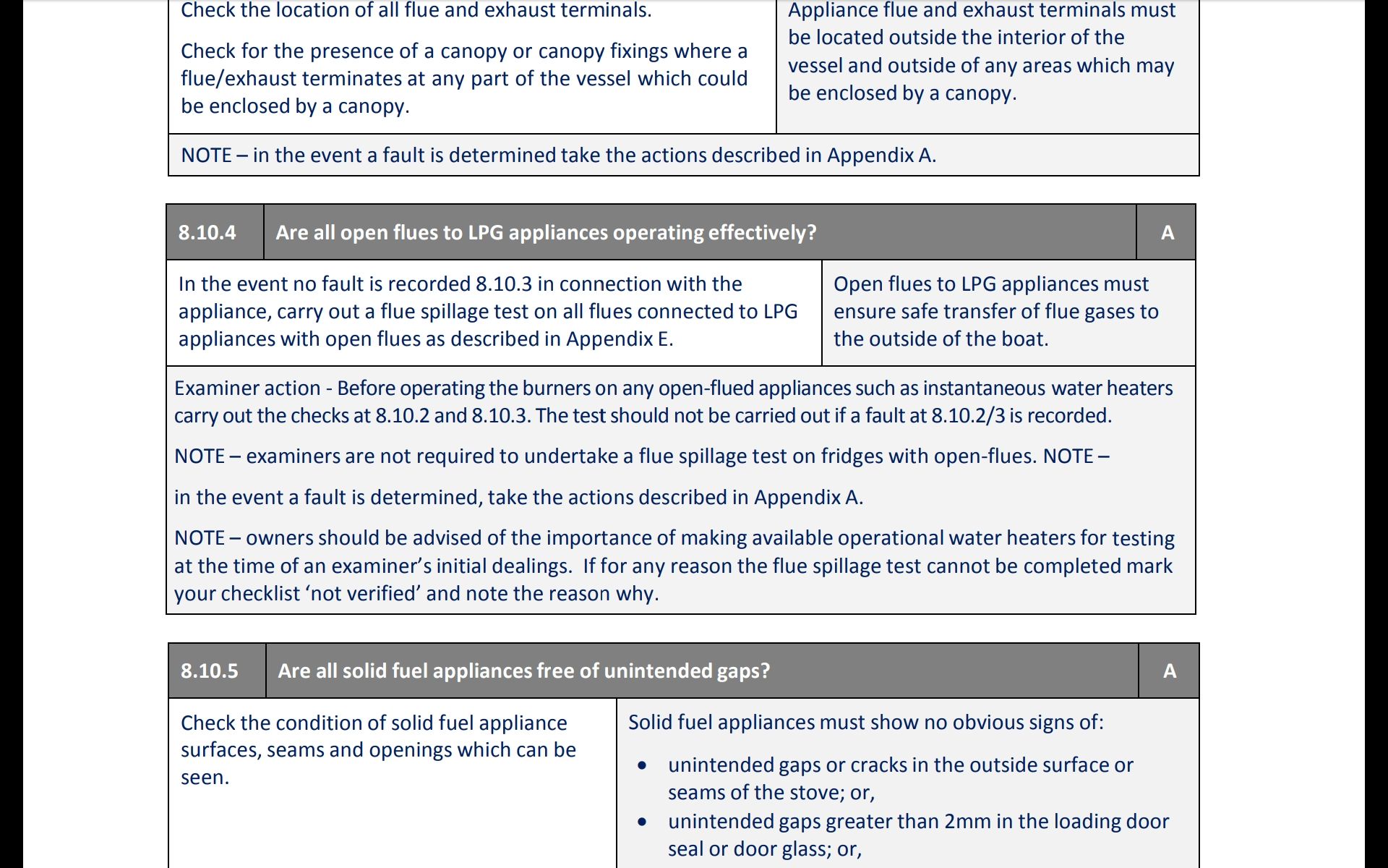

Just found this, maybe 14 Kw is important
Under the Gas Safety Regulations 1998 a room being used to sleep in can’t have a gas boiler over 14kw unless it is room sealed. Make sure you check the output of the boiler before installing.
Would just seem to suggest it just needs to be checked its operating efficiently. No mention of where it can and cannot be located. Which frankly I find surprising.
Plus, all those checks are Advisory only.
