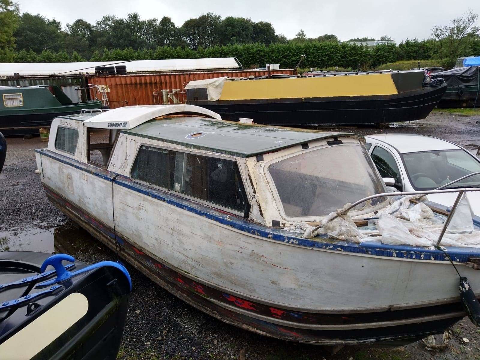

This is a picture of my boat when I said yes to having it. It is a shell and need lots of work. But I have a boat.

Dawncraft centre cockpits look lovely, but if it's sitting on the hard will it float? If i remember correctly, there are hardwood keels and rubbing strips under the waterline. Bolted through the hull. Be confident in those before setting off on any major travels.
ETA: this example looks as though it was always designed for an outboard

Regarding the fins on the bottom one is missing and the other is rotten. Both will be getting replaced. Possibly fibreglassed.
The rubbing strakes will be getting removed and all holes filled.
I want to build a sliding roof canopy to try and use as much of the space as possible. Anyone else built one for a centre cockpit?

One thing that has always got me wondering, why DC fitted timber keels and bolted them through the hull. I guess they have last a good 40 years though on some boats, some not. I am about to replace a set in GRP for a customer as the ones on his DC25 which are barley there.
Good to hear you ridding of the strakes, more the lower one as they are prone to leaks being so close to the water line.
Its low cost in materials to build a canopy in GRP, this is a top screen and canopy i built for my last boat, but fixed but much the same to slide back if hinged. I plan on doing one for my Norman this year that slides back..or forward, not decided yet.
