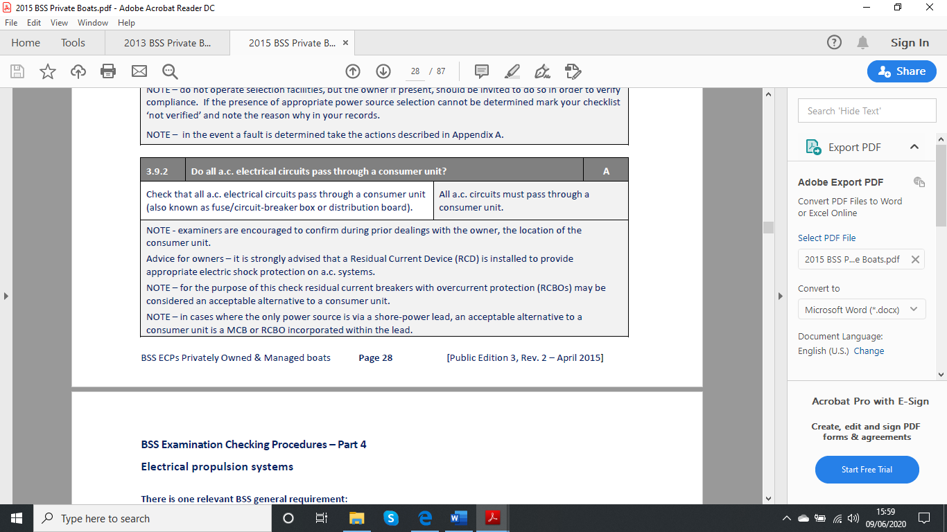

The use of a consumer unit was 'Advisory'
3.9.2 Do all a.c. electrical circuits pass through a consumer unit?      A
Check that all a.c. electrical circuits pass through a consumer unit (also known as fuse/circuit-breaker box or distribution board).
All a.c. circuits must pass through a consumer unit.
Applicability - examiners are encouraged to confirm during prior dealings with the owner, the location of the consumer unit.
Advice for owners – it is strongly advised that a Residual Current Device (RCD) is installed to provide appropriate electric shock protection on a.c. systems.
Applicability – for the purpose of this check residual current breakers with overcurrent protection (RCBOs) may be considered an acceptable alternative to a consumer unit.
Applicability – in cases where the only power source is via a shore-power lead, an acceptable alternative to a consumer unit is a MCB or RCBO incorporated within the lead.
The BSS 'office' agreed with me that in effect it was simply an 'extension lead' and did not require a CU and said that they would remind the examiner and ensure that on his next 'refresher' that he was up to date with the requirements.
Here it is 'in the flesh'

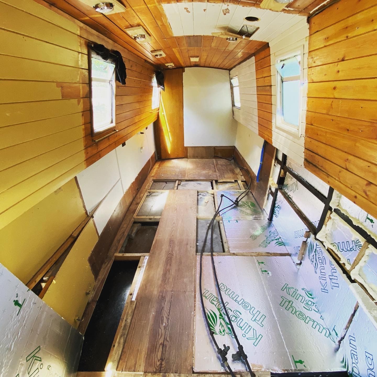

On 27/05/2020 at 20:32, ASupertramp said:
Good Evening!

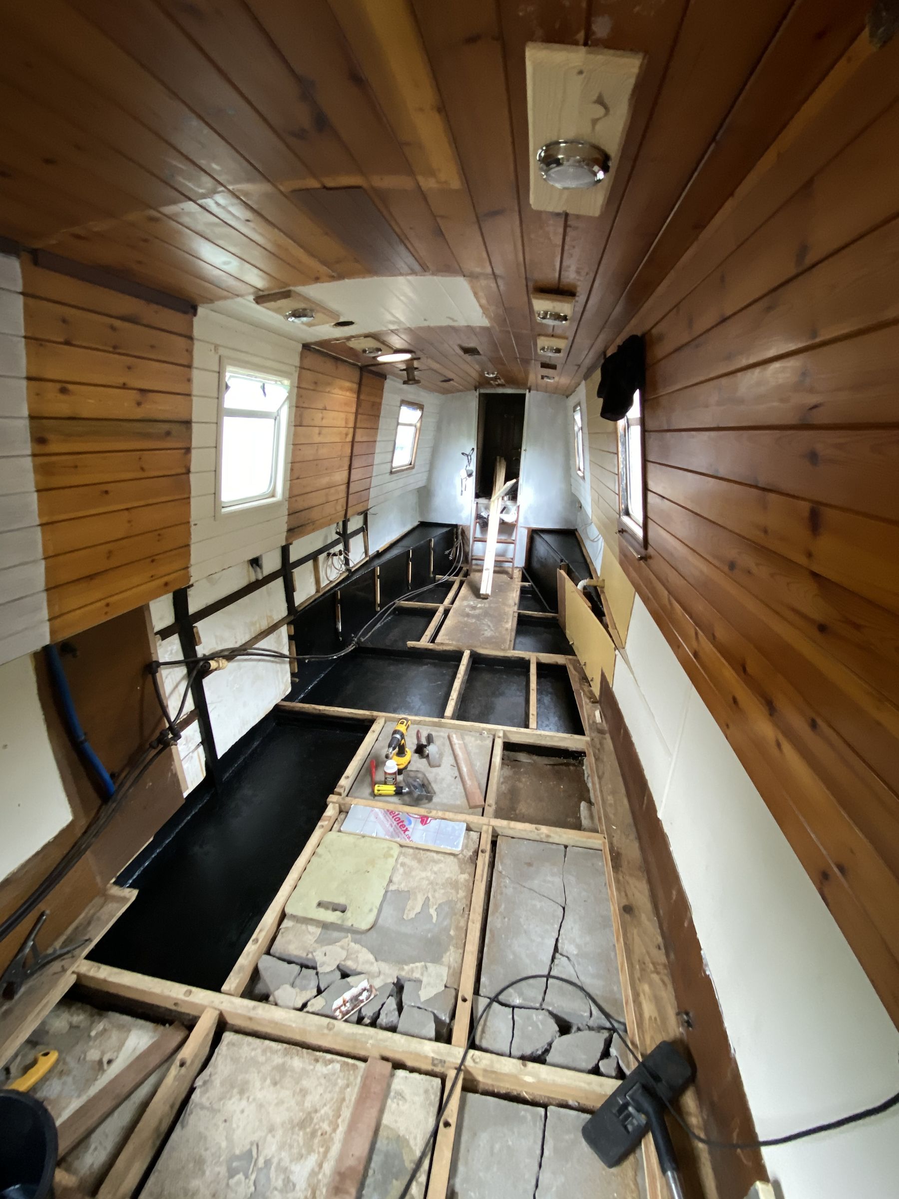

I am now well into ‘worse before it gets better’ zone. I have pretty much demolished the rear half of the boat, removing the three interior bulkheads as the plan was always for a walk through bathroom and study. When I removed the shower, the sub floor was rotten and bilge rusty so I stripped everything back to metal, fixed the rust and I am now in the process of insulating and fitting a new sub floor. I’ve bought 18mm marine ply, collecting that tomorrow.
I would like some pointers if possible about the best order to complete things from this point onwards. I have a joiner lined up to build the bulkheads and bed/office, but what should I be doing first. I thought installing any wires for electrics/lights/sockets, then the central heating pipes, plumbing then joinery?
I’m also suffering from information overload so go easy on me!

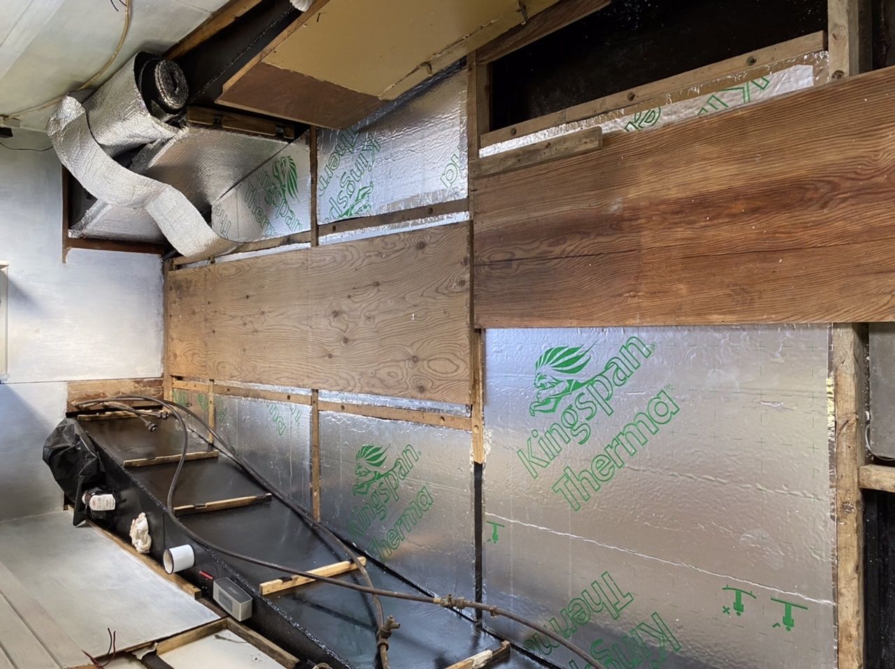

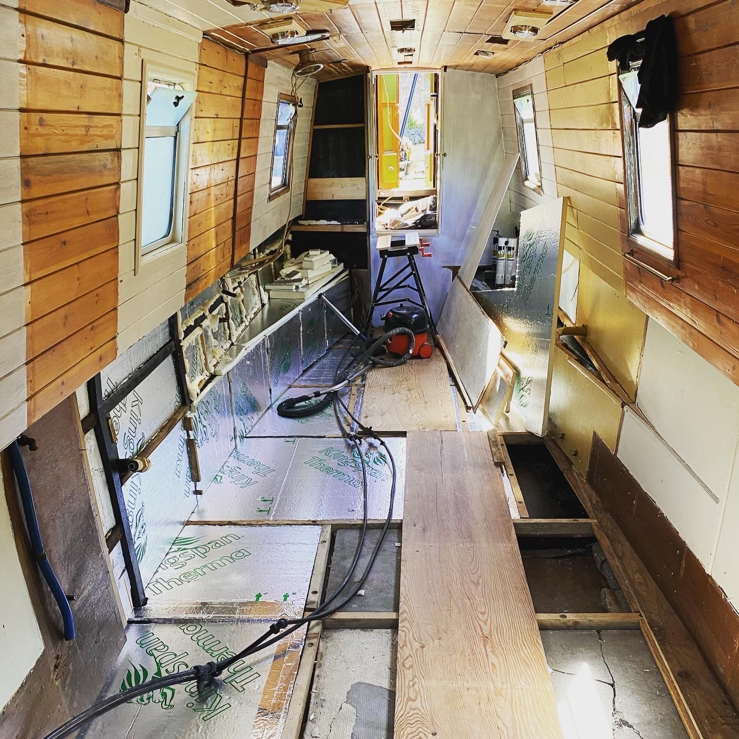

This is where I’m currently at:
Started cutting the sub floor but need to brace it somehow along the swim as it bows slightly. Not sure how to do that. Sides have been insulated.
Progress feels very slow now as I’ve had weeks of dismantling rather than putting back together.
