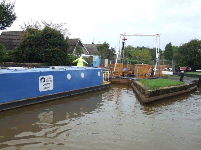

ditchcrawler Posted November 23, 2019 Report Posted November 23, 2019 10 minutes ago, David Schweizer said: Your reply has reminded me that there is no road acess to Denham Deep, so they could have logistics problems moving a crane in to lift the gate, unless they resort to more traditional maintenance procedures, when they used A frames over the lock, a Block and Tackle, and alot of men pulling ropes!! Like they did at Lawton lock on the T&M
Guest Posted November 23, 2019 Report Posted November 23, 2019 Have to admit a very rough estimation of timescale of closure would be useful from CRT rather than just 'ongoing' Just now, ditchcrawler said: Like they did at Lawton lock on the T&M How long did that take!?
