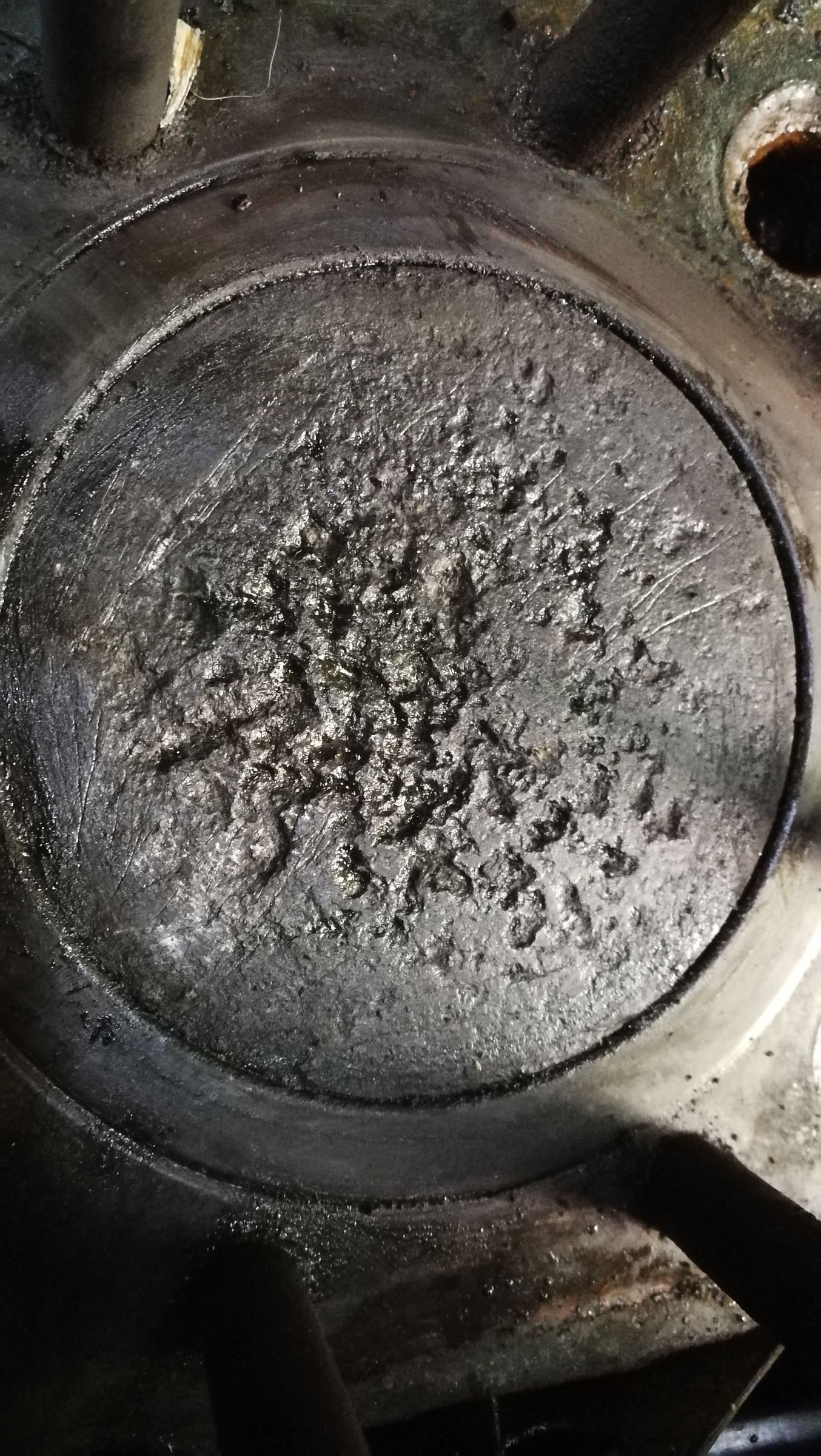

Andy_B Posted October 18, 2019 Author Report Posted October 18, 2019 20 hours ago, frangar said: You need to take the rocker shaft out & rockers then you can access the nuts that fit on the tubes that the push rods go through. It’s a bit of a fiddle and if it’s a marine JP you will need to remove the silencer as well. Managed to get both rocker shafts out without disturbing the silencer - unscrewed the greaser elbow and pulled it forward. Gentle application of mole grips. Front piston is pitted at the crown, it's not just carbon build up, it's into the metal. I take it this isn't right?! Any suggestions other than new piston?

John Hartley Posted October 18, 2019 Report Posted October 18, 2019 That looks more like a mining disaster and not pitting.? Its a long time since I puled one to pieces and I have not seen pitting that bad before 1
Andy_B Posted October 18, 2019 Author Report Posted October 18, 2019 (edited) 14 minutes ago, John Hartley said: . . . more like a mining disaster and Very good. Made me laugh out loud! ? Edited October 18, 2019 by Andy_B
frangar Posted October 18, 2019 Report Posted October 18, 2019 38 minutes ago, Andy_B said: Managed to get both rocker shafts out without disturbing the silencer - unscrewed the greaser elbow and pulled it forward. Gentle application of mole grips. Front piston is pitted at the crown, it's not just carbon build up, it's into the metal. I take it this isn't right?! Any suggestions other than new piston? Well done!! That looks like it’s been letting water in. Can you see a pattern on the head gasket from where the water has been tracking. It looks from the pic that the liner might be a bit low on one side...I hope I’m wrong!!
Andy_B Posted October 18, 2019 Author Report Posted October 18, 2019 Might be just the way I've wiped it, the way the liner looks. I wondered if it'd been left a while somewhere in between being a fishing boat and being a narrow boat and perhaps got water in this pot. The other one is fine, just light carbon buildup. I've not cleaned it yet but the matching head looks pretty rough too.
frangar Posted October 18, 2019 Report Posted October 18, 2019 30 minutes ago, Andy_B said: Might be just the way I've wiped it, the way the liner looks. I wondered if it'd been left a while somewhere in between being a fishing boat and being a narrow boat and perhaps got water in this pot. The other one is fine, just light carbon buildup. I've not cleaned it yet but the matching head looks pretty rough too. Just check there is a even lip all round the liner. Mine was low and it caused all manner of grief until I had it pulled & shimmed. I’d say that looks more than damage from standing water but it might be from old salt water corrosion if it’s out of a fishing boat and the cooking water was leaking into the cylinder in the past. Think you are looking at a new piston & head skim...what state are the liners in?
BWM Posted October 19, 2019 Report Posted October 19, 2019 14 hours ago, frangar said: Just check there is a even lip all round the liner. Mine was low and it caused all manner of grief until I had it pulled & shimmed. I’d say that looks more than damage from standing water but it might be from old salt water corrosion if it’s out of a fishing boat and the cooking water was leaking into the cylinder in the past. Think you are looking at a new piston & head skim...what state are the liners in? Likewise, i had one fitted too low which allowed a free exchange of water and fuel oil between cylinder and water jacket. If extreme it will also affect the seals near the base of the liner. What is the sealing face on the cylinder head like? I'd second the use of wellseal when reassembling.

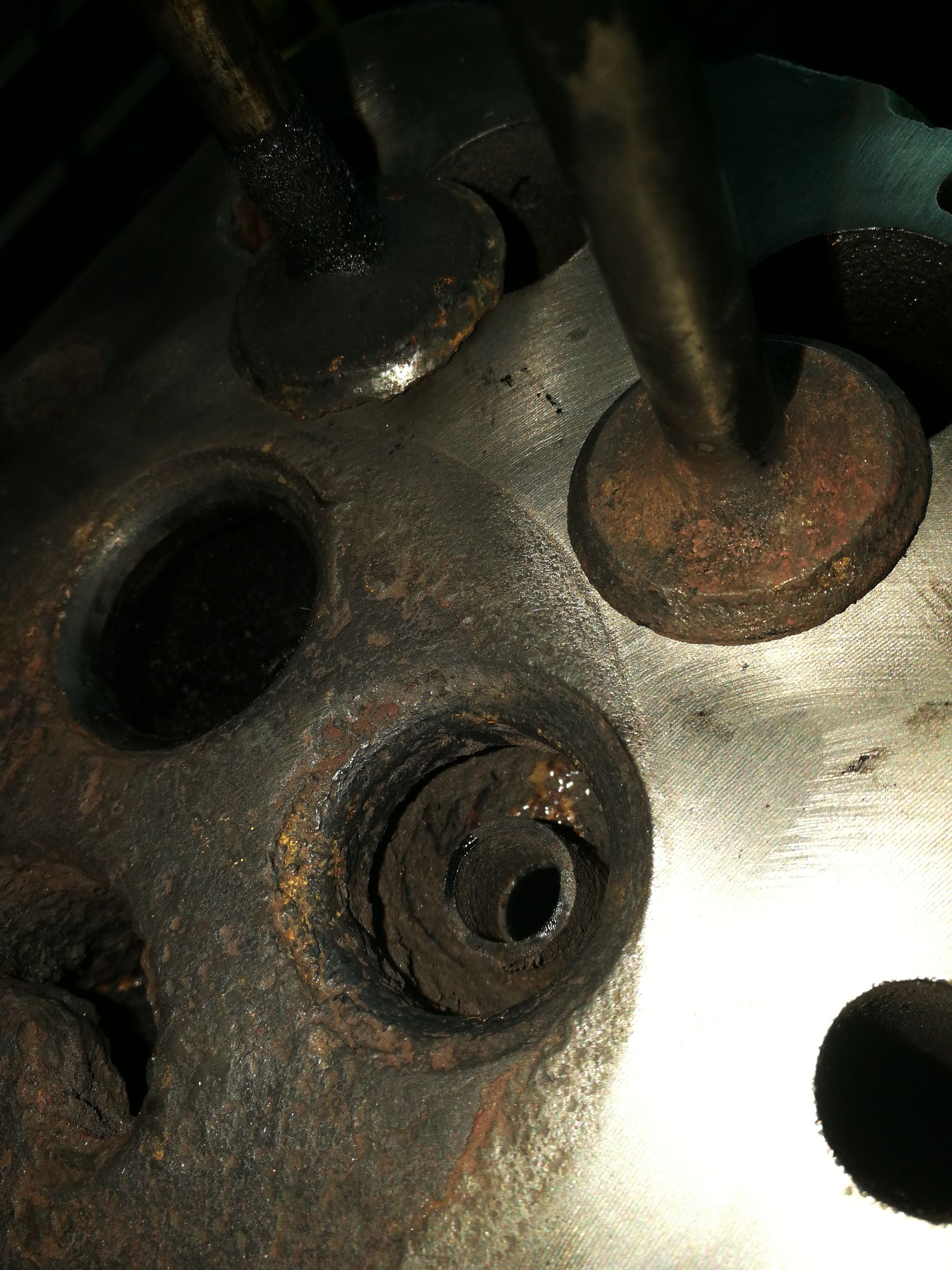

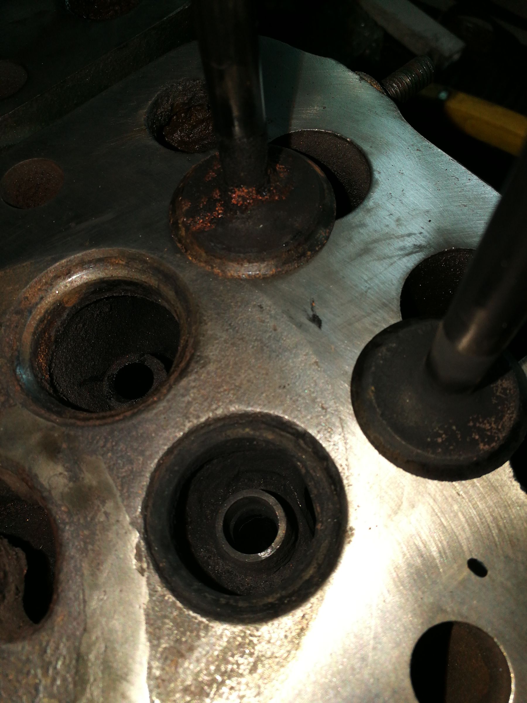

Andy_B Posted October 19, 2019 Author Report Posted October 19, 2019 I'm finding these comments very useful, will check the liner and block surface later. Meanwhile here are some snaps of the heads. Can anyone see why compression was a bit low on the front pot? (Rear pot first, front next)
MtB Posted October 19, 2019 Report Posted October 19, 2019 Nothing wrong with that exhaust valve seat at all, is there!! 1
Andy_B Posted October 19, 2019 Author Report Posted October 19, 2019 I've got two tins of carborundum paste. . . ? Seriously I wonder whether there's enough left for a recut. ?
frangar Posted October 21, 2019 Report Posted October 21, 2019 On 19/10/2019 at 12:39, Andy_B said: I've got two tins of carborundum paste. . . ? Seriously I wonder whether there's enough left for a recut. ? Ooohh that’s not great. There was a head or two on eBay a few weeks ago. You could also try Marine Power Services on the south coast who’s on here as @martyn 1 or @steamraiser2 I think a new piston is needed too...which means if you’ve pulled the piston you may as well fit a liner...then you notice the big end has some play....then you may as well get the crank ground.....??....I’ve a feeling of dejavu now...? Hopefully you won’t need to go that far! I’m not sure if you could have an insert put in for the valve either??

BWM Posted October 21, 2019 Report Posted October 21, 2019 On 19/10/2019 at 12:39, Andy_B said: I've got two tins of carborundum paste. . . ? Seriously I wonder whether there's enough left for a recut. ? I doubt you could skim the head to remove the pitting as it looks too deep, needs a replacement. There was a head on eBay for about £350 but i didn't like the look of it, had the appearance of a home 'restoration'. 2 minutes ago, RLWP said: We have had seat inserts fitted to JP heads. I'm fussy about valve regression We have pistons, valves, head gaskets, manuals etc. Richard That head needs more than an insert!

Andy_B Posted October 21, 2019 Author Report Posted October 21, 2019 10 minutes ago, BWM said: There is someone doing ex Mod stock for just shy of £600, boxed and unused. Like you say, mad price but no competition. I'm not sure if that is for a bare head without valves, etc. yeah, saw that - image looks like it has valves but as you say it's silly money! The other head is better but not perfect and seems to have been welded. Oh dear! 20 minutes ago, BWM said: 21 minutes ago, RLWP said: We have had seat inserts fitted to JP heads. I'm fussy about valve regression We have pistons, valves, head gaskets, manuals etc. Richard That head needs more than an insert! Richard - who's done inserts for you - I am inclined to agree with BWM that it's a bit far gone but I'd like a machine shop to look at it first!
martyn 1 Posted October 21, 2019 Report Posted October 21, 2019 Well from the pictures I would be putting that piston and associated head in the scrap bin. Don't forget when you get it sorted and put the heads back on to check the piston to head clearance. All of the indian made head gaskets I have seen to date are to thick and wont allow the clearance to be set correctly. It will run but wont be as clean as it can be. Hence we don't buy the Indian gaskets, we make our own to the OEM thickness. We have used heads as well hear
