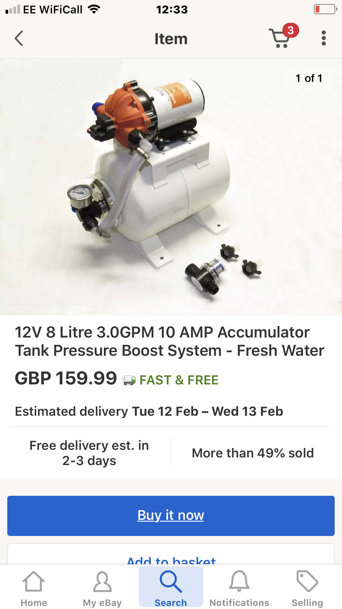

Adamwalker64 Posted February 9, 2019 Author Report Posted February 9, 2019 Thought I might try this What do you think
Kingdom Isambard Brunel Posted February 9, 2019 Report Posted February 9, 2019 Fine, but what pressure rating is the rest of the system such as calorifier, and pressure release valve? 30psi, 2 bar gives a good shower for most folk, is the shower head the problem or the mixing valve?
Adamwalker64 Posted February 9, 2019 Author Report Posted February 9, 2019 Ain’t got one yet just starting a refurb so gonna be starting from scratch just trying to get some ideas at the min so any input greatfuly recived

ditchcrawler Posted February 9, 2019 Report Posted February 9, 2019 I cant see it getting much simpler than a pump mounted on top od an accumulator. However you are paying a lot for convenience on that set up, the pump is about £60 so that is £100 for a tank, gauge and piece of plastic pipe.
