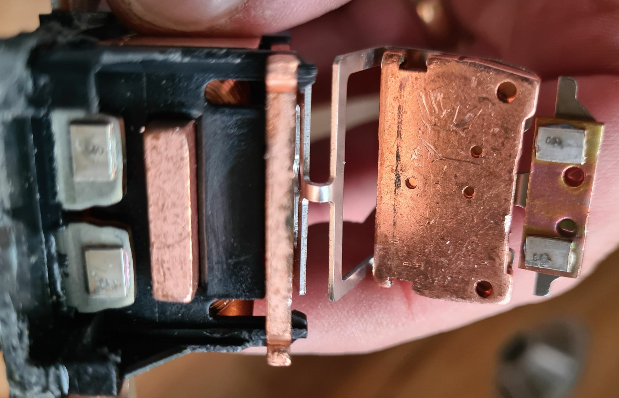

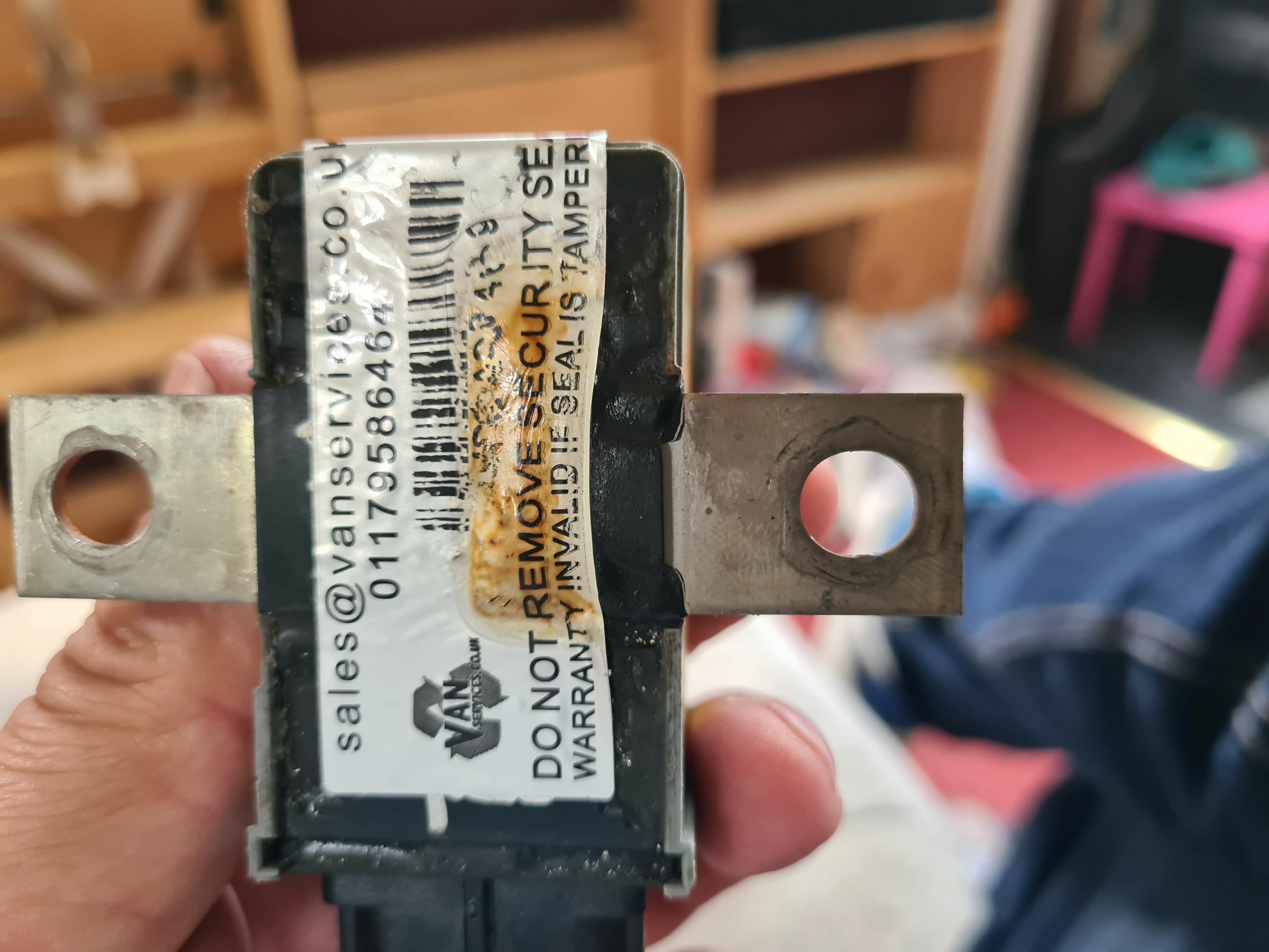

Thanks for idea about relay coil, but only driven when it's switched, and only using short pulses as per spec. Relay operated for some time prior to failure today so still remains a mystery. Prior to dismantling, relay could still be heard to click positively when switched on or off. Edited to add: Have just checked coil drive connector, and no voltage on terminals until switching, when just a short pulse occurs as expected.
Has anyone else that uses the tyco BDS-A bi-stable relay had problems with it? I've just had a second one fail open circuit (with evidence of overheating). Only used on the charging side (load side uses a BEP motorised battery switch) and never been switched under load (to my knowledge). Max charging current is around 160a (although we rarely see more than 140a) so it shouldn't be overloaded. I think @nicknorman uses one and can charge at a much high rate than i can! Annoyingly both failures have resulted in blown alternator😡 I put the first failure down to poor connection as clear evidence of the connection post and cable overheating with corrosion to the cable. This was probably my fault for reusing old cable and crimped end, and in fairness there were warning signs for several weeks before it failed. All cable replaced with new well made crimps when the relay replaced 6 months ago. No problems until today with sudden failure of all charging when cruising. No prior warning at all, and evidence points to relay itself rather than cable connections. Do I replace with another used one? Or bite the bullet and buy new? Or forget the tyco completely and use something else? Evidence of overheating to internal relay contacts, but no evidence of significant wear, pitting, or corrosion on dismantling.
