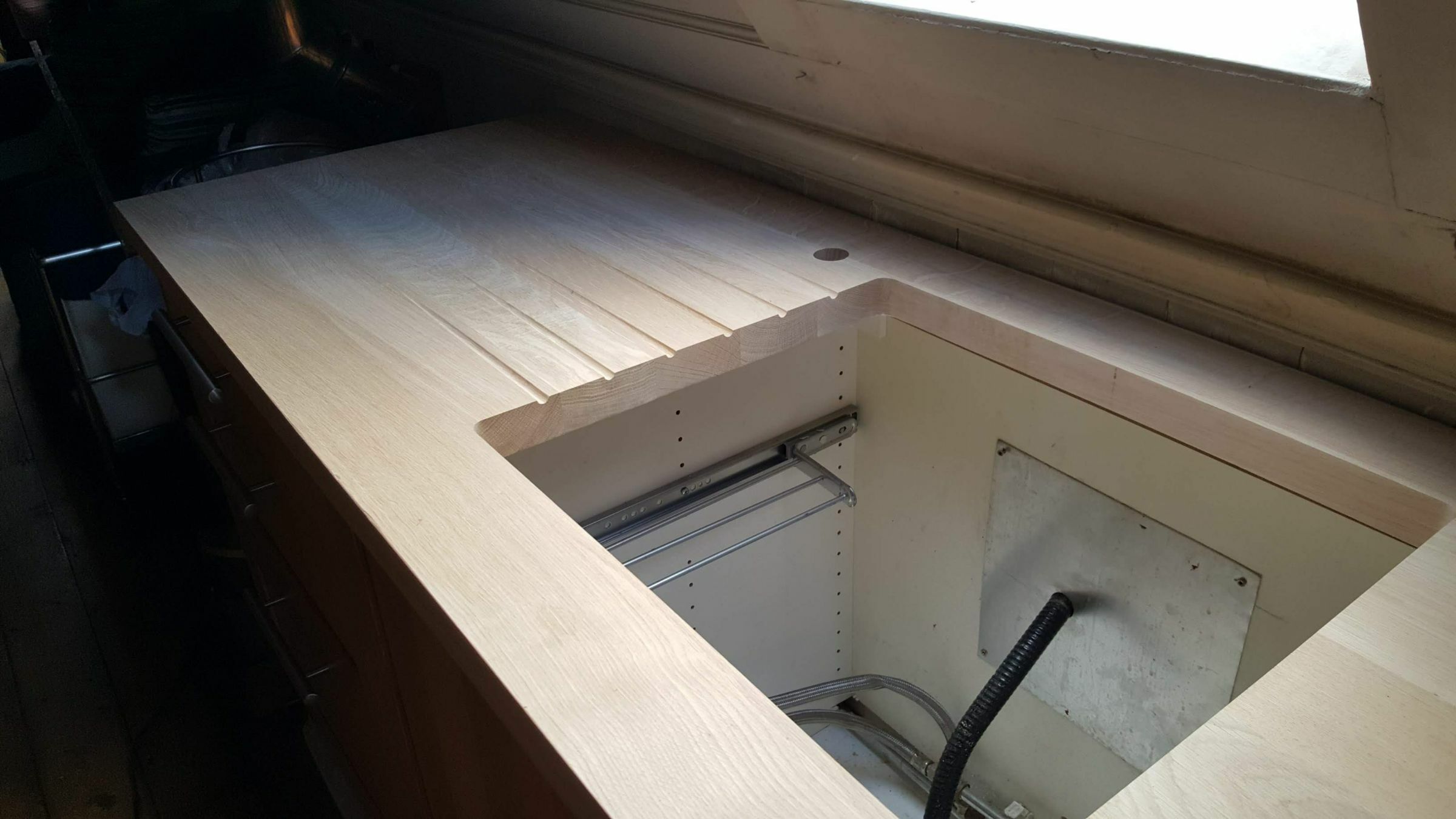

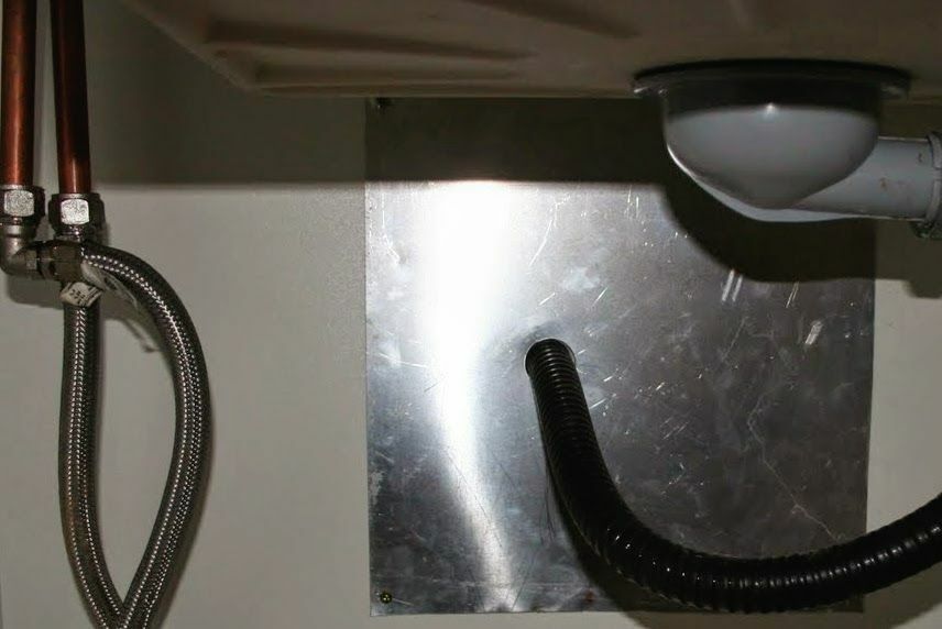

If you need to replace a skin fitting which has a back nut, a removable inspection plate makes access a lot easier.

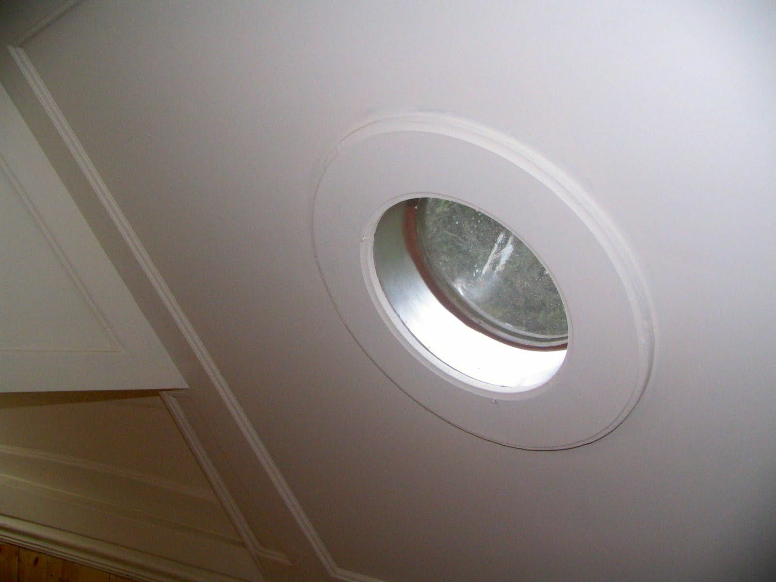

DIY Porthole surrounds and linings

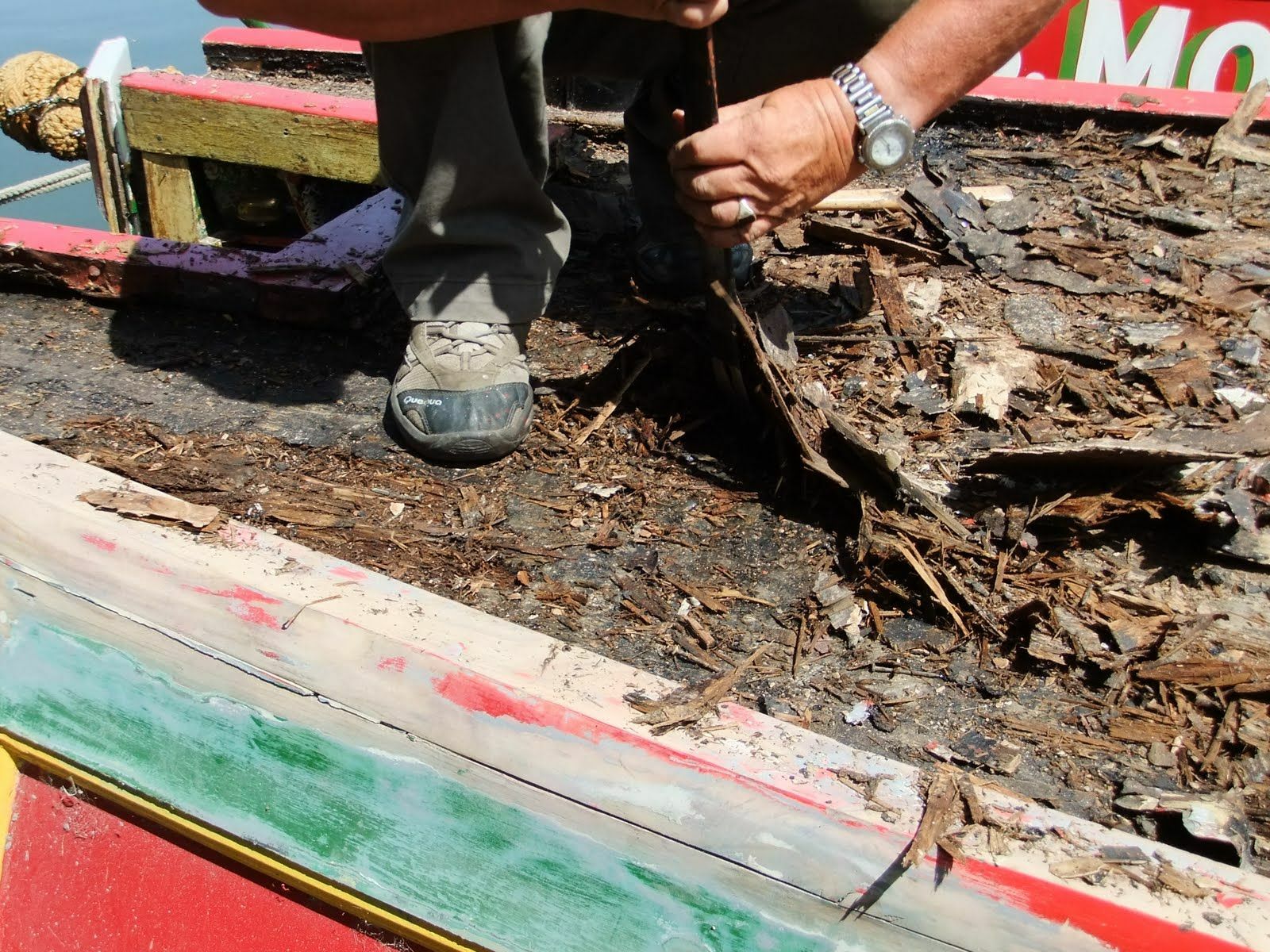

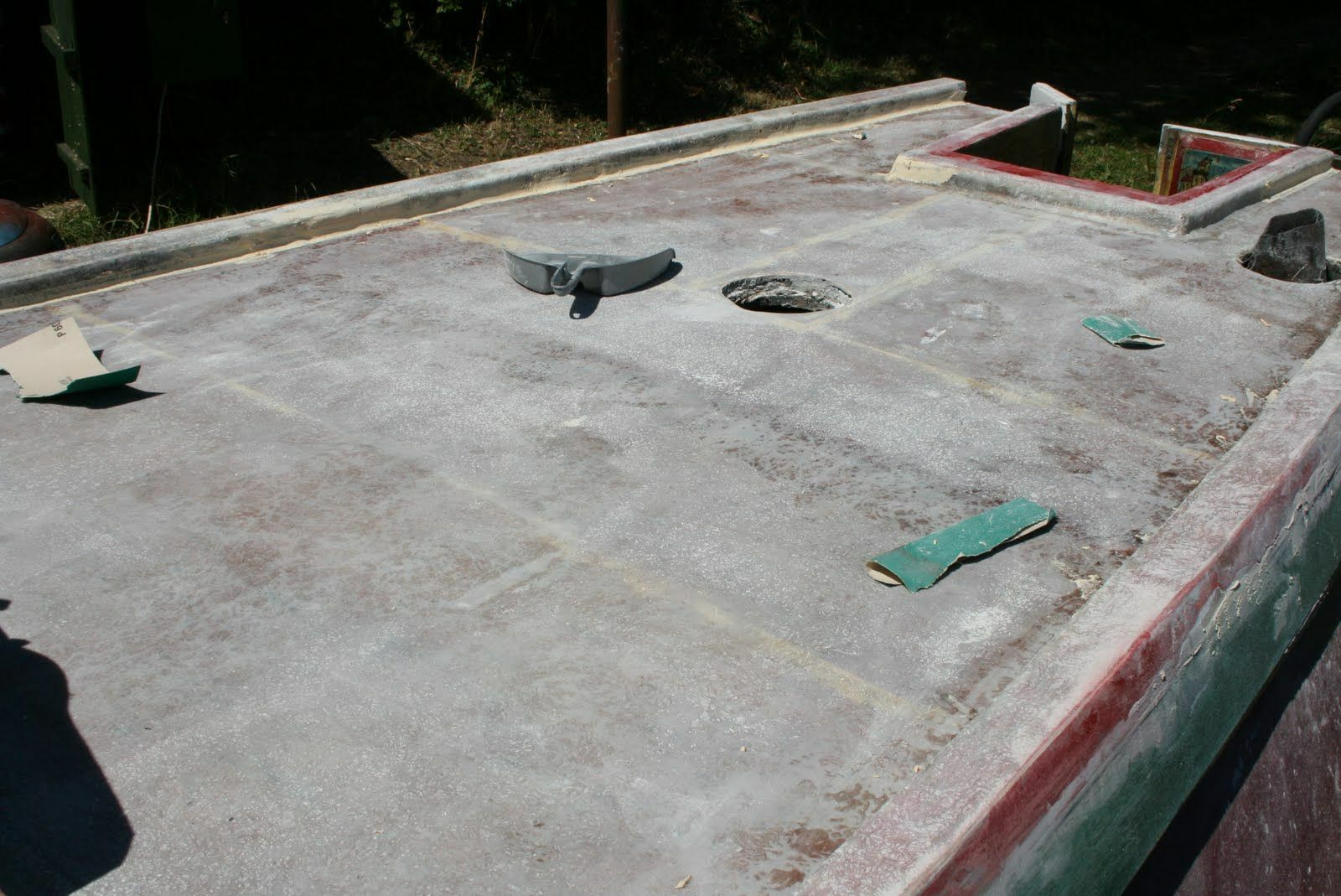

On our butty I removed the top layer of ply which had been laid over the original wooden roof. I quickly realised that original roof would not provide a smooth surface so I added a thin layer of ply (8mm, I think); I covered this with fibre glass matting, poured on resin and then sanded it down. The result was aestheticlly OK, but as I've mentioned before, the underlying problem was not really solved. Still it gave me a few more years of a leakproof roof.

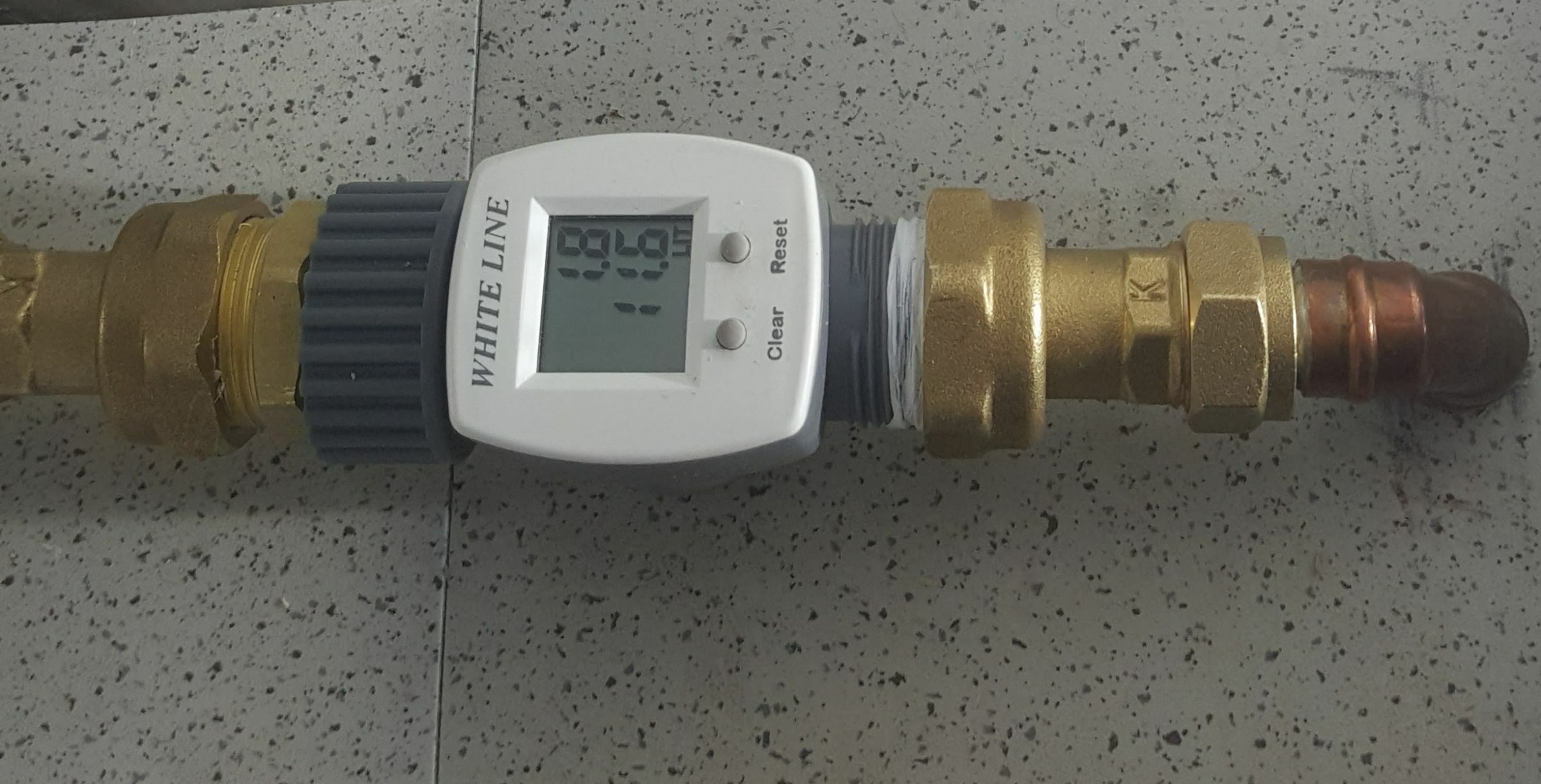

I've fitted these. They have a rubber ring to prevent moisture entering the cable. They seem to work well. https://www.amazon.co.uk/dp/B07KC5S96Q/ref=pe_27063361_487055811_TE_dp_1
Hmm. You may be right. However, I've had this fitted for about five years and I've never had to change a battery. There may be a button battery; I'll check at the weekend. eta Just looked it up. It does have a battery.
No external or internal power source needed. There's a sort of turbine which moves the counter.
The simplest and cheapest method I found was to use one of these garden hose meters. I reset the counter when I've filled the tank then I watch the meter count down. When the guage reads 250l I know it's time to fill up again. No 12v needed. Dead simple.
