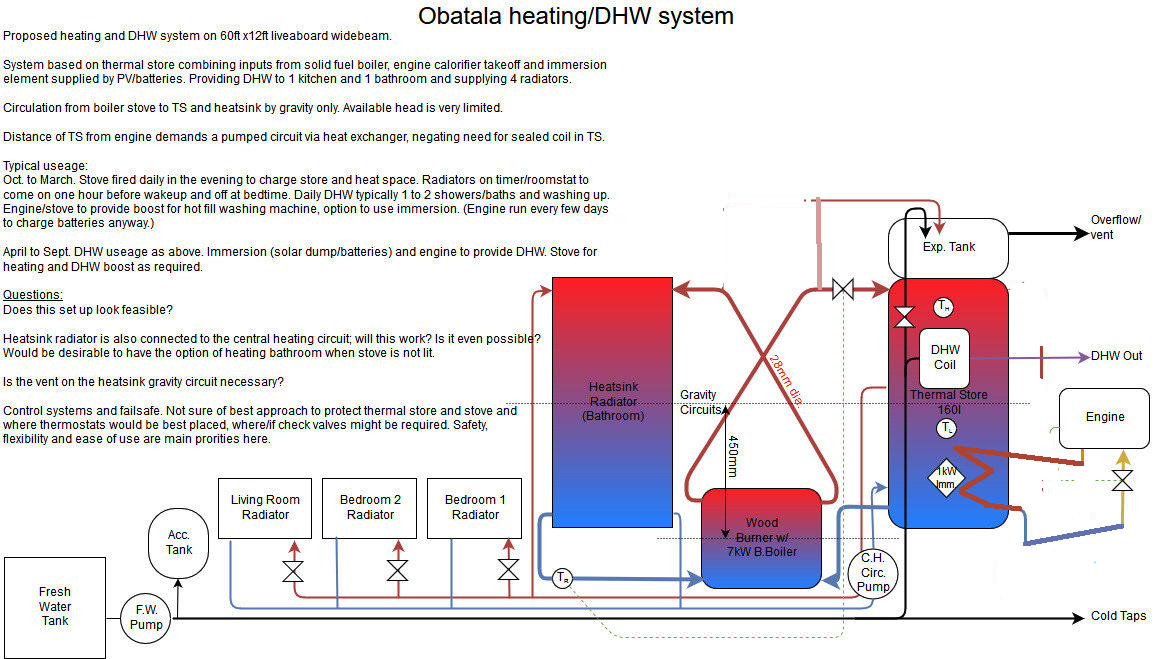

Hi, I would not use the plate heat exchanger on the engine and buy a themal store with an indirect coil so you could attach the engine direct. Hopefully if the engine is close enough to the store the engine water pump should take care of it. In my opinion you don't need the vent pipe on the heat sink rad or on the gravity hot water flow. But to be safe and because it's easy would put a vent pipe there ( See Pic ) I think it's workable but the one problem I can see is keeping the store at an adequate temperature for hot water as required. I have fitted only a few Thermal stores in houses and they have all had a controllable source of heat like an oil/gas boiler incorporated. Which can be timed say before you get up in the morning to heat the store for hot water and the solid fuel/wood burner is a bit of a evening focal point and not a main source of heat. -
