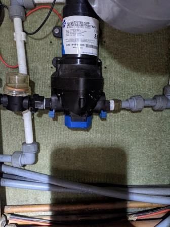

  4. Hi all, thanks for all the comments and advice. I found the leak, a joint had come loose behind some panelling. Fixed now and bilge almost dry. The water pump is fine, no terminal damage. Lesson learnt about leaving water on when not there, always the hard way! Thanks again
  5. Thanks I'll try the sucking technique to try get it pumping and check where the leak might be. Any tips on how I might stop the pump from weeping? Unscrewing and resealing?
  6. Hi all I've not been living on boat and found that back cabin bilge was full of water when I last went on board, about 2 weeks ago. Batteries were completely drained and fresh water tank was empty so assumed a leak on fresh water pipes which led to pump pumping till dry and draining fresh tank and batteries. I managed to get batteries charged again but removing fuse for fresh water pump and filled up fresh water tank but to see where leak is I need to get water to circulate through system. When I put fuse for pump back in, it starts pumping but don't think its managing to get pressure up to required level as nothing comes out taps or shower. Managed to get flush on toilet but this is at lower level obviously. Looking at the pump, it appears to be leaking along one the seals (pic attached) which I presume is preventing required pressure to pump water to taps? I'm not sure this is the actual leak as that cupboard floor did not appear to be very wet and seeping is very slow. You see drips on right hand side towards bottom of pump and there are seeping out the seal just above. Is this pump repairable and would the pumping dry of fresh water tank have damaged it? Any advice gratefully appreciated?
