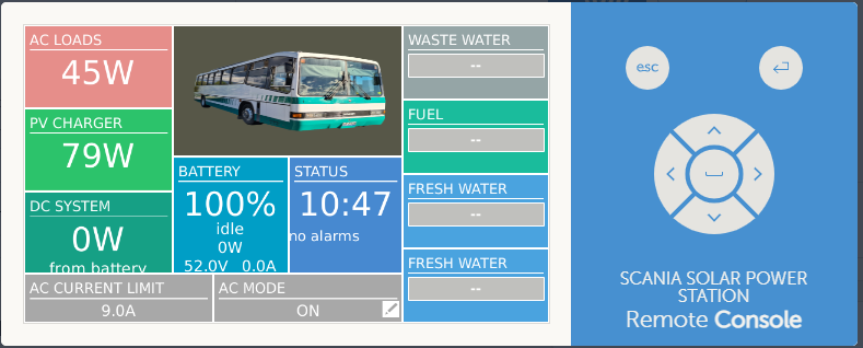

  5. If you enable the motorhome screen on the Cerbo GX you get a screen similar to that below, tap on the AC current limit and you can alter it with immediate effect, no need for accessing the set up.
  6. Victron categorically state that ESS should not be used for off grid install such as boats. ESS relies on a permanent grid connection and at times can feed energy back into the grid, especially if a large load is turned off. I do not know if the travel power electronics would like being back fed. I believe ESS also needs a grid code to be set on the inverter so the system knows the rules. I am not sure you needs ESS, you just needs the AC current limit setting so you do not draw too much power. If you have a Cerbo GX connected to the inverter then you can set the AC current limit from one of the Cerbo screens very quickly and easily without needing to reprogram the inverter.
