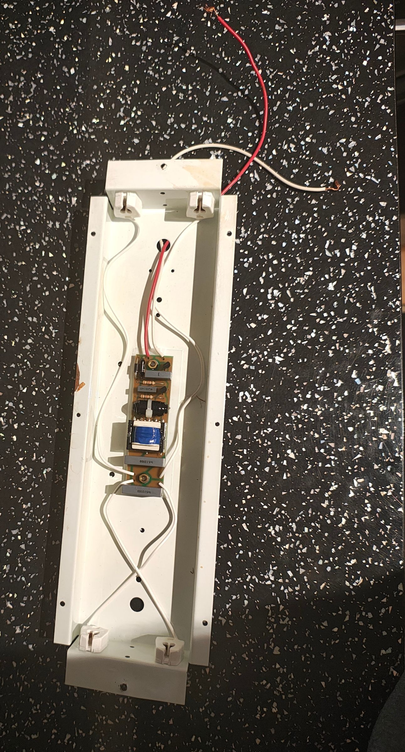

  4. Grumpy I have tested the light fitting with light strips / bulbs that work and they don't work. Therefore I want to follow your Idea. The inside of the light frame it's 300mm long by 75mm wide. Can you assist me? What do you recommend I buy ? We have two more lights I would like to change. Thanks Steve

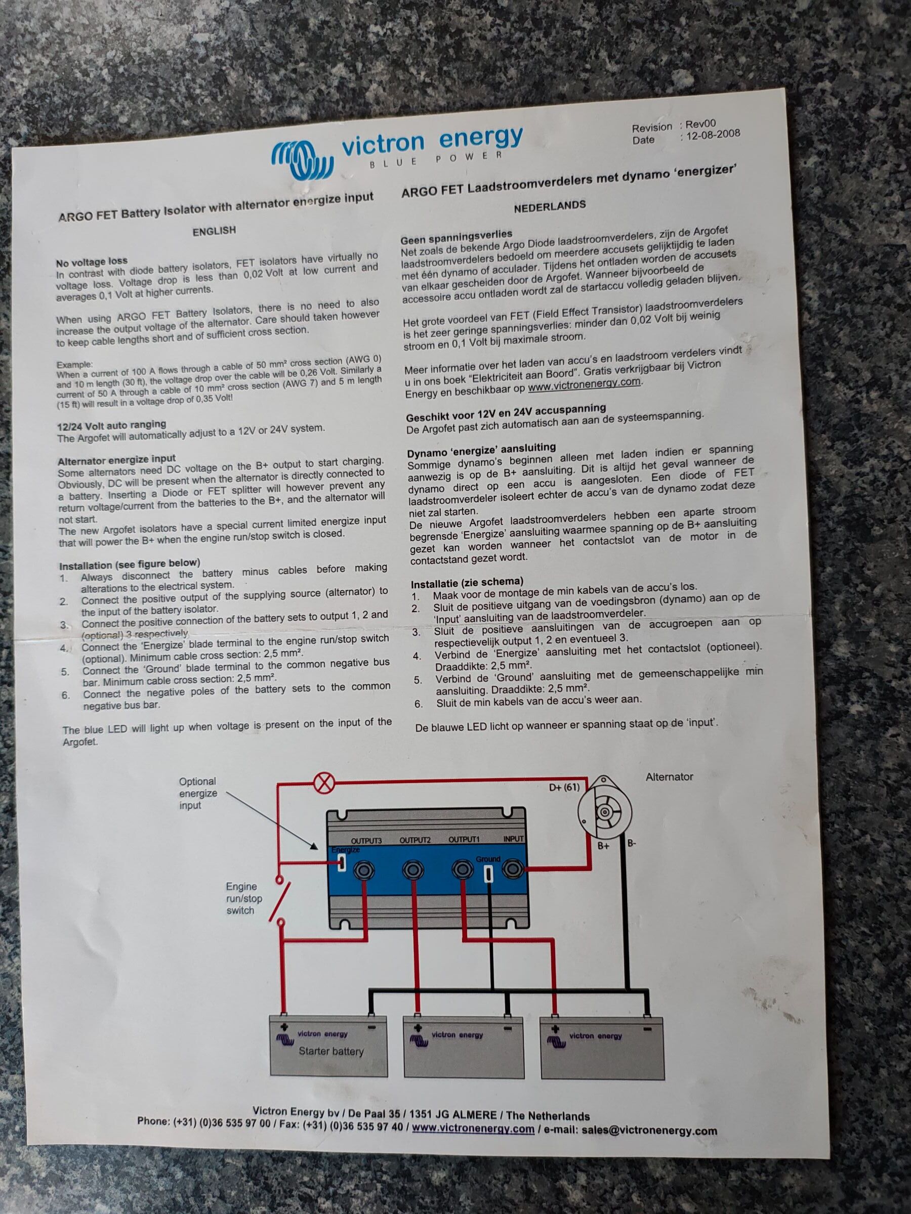

  7. Tony It's a few years since the victron battery monitor was calibrated. Thanks for the information. I will look at recalibration of the victron battery monitor. See photo on the information of the splitter. Cheers
  8. The battery set up is how I purchased it. I believe it's how the boat was built. When we purchased the boat there was 8 batteries on the boat. Yes there are currently 7 batteries on the boat. Inverter side there was 4 batteries when we bought the boat. We have reduced this down to 3. These are charged by their own altinator or the solar panels. The solar panels feed these batteries and are monitored by the victron battery monitor. On the domestic side there are 3 batteries. These are charged by their own altinator and solar panels. There is 1 starter battery. This is charged by the domestic altinator. It's not charged by the solar panels. Because the solar isn't connected to the domestic batteries directly there is a victron splitor fitted. The feed from the solar panels goes straight to the splitor. This sends 50% to each bank of batteries. Once the solar panels stop producing power, I.e at night, the splitor some how disconnects the connection between the 2 bank of batteries. You may wonder why so many batteries? We have a 1200mm corner bath jacuzzi. It still works. We don't use it. The boat was built as a honeymoon boat by the hire company. 😀 Hope this helps
