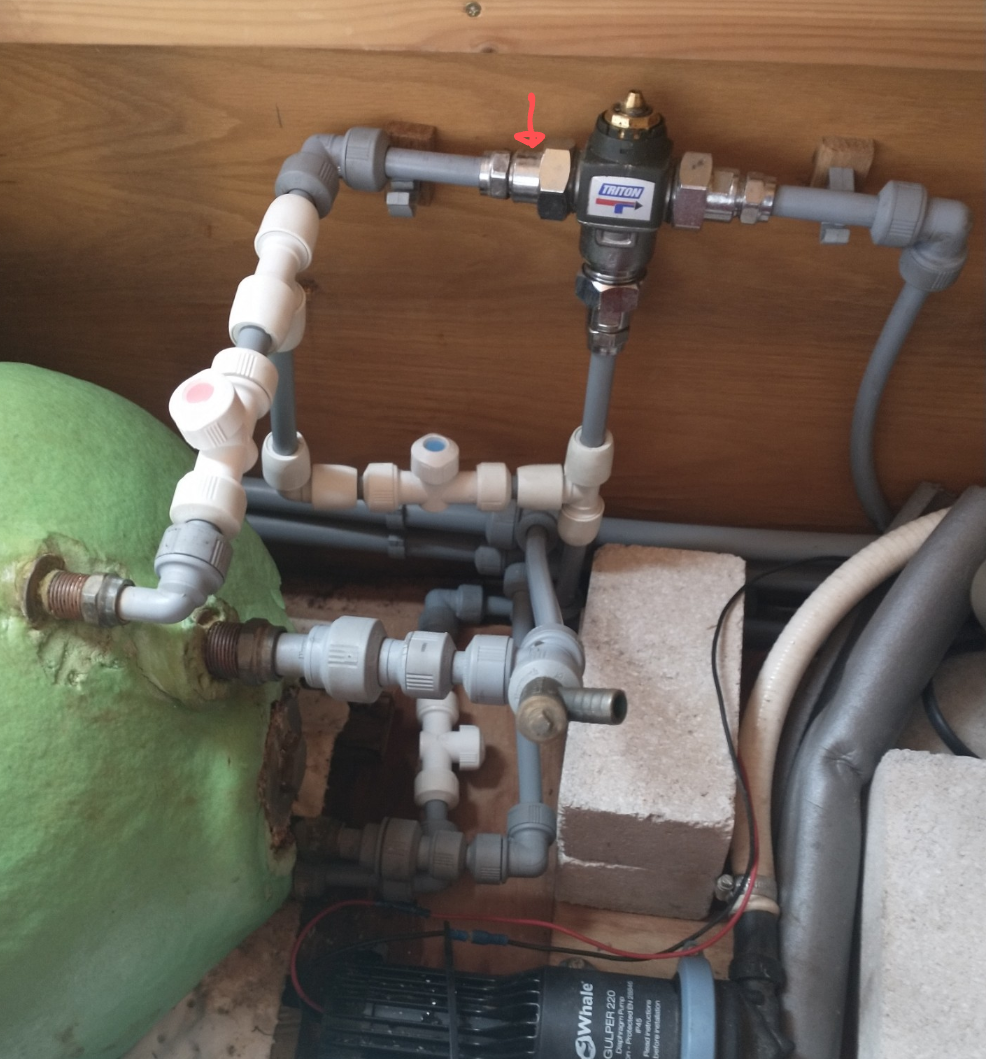

I have covered this previously in the thread. We use the boat 3 to 4 months of the year. Then we winterise it. These valves cut off the hot water tank. Once we cut off the hot water tank I fill the cold and hot water pipes with fresh water antifreeze. Last September someone suggested I could blow out the water from the fresh water pipes by taking the filter cap just before the water pump. This is Something I will try in September. Thanks for all contributions
I am guessing the neoprene washers for this unit will not be a standard washer size ? What approximate size would you recommend? Again thanks for your time and information
Thanks for the additional information re neoprene seals. Considering they may have been there since the boat was built I am guessing they would require changing should I disturb them by opening up the joint?
I have highlighted the nut with two flat surfaces with red arrow. If we were not using the boat at this time I may have taken the risk. I plan to call two local marinas tomorrow to see if I can get one of them to check for a filter. Using spanner 🔧. Thanks for your suggestions and help
