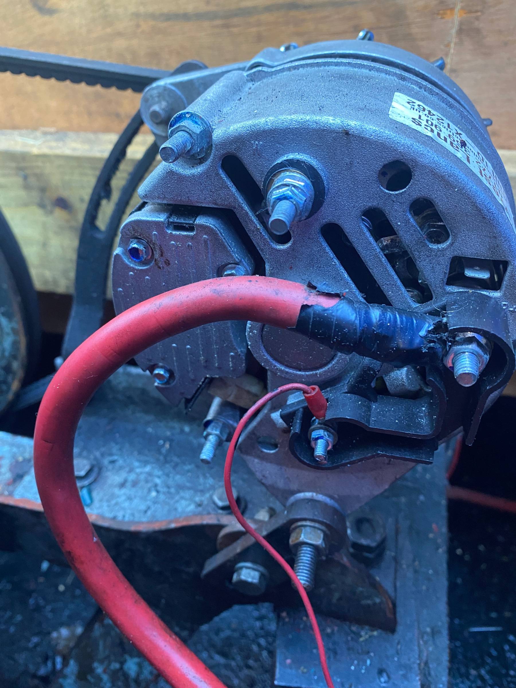

  5. B+ to D+ with the engine revved is about 0.1 Another problem I’m having is finding a reverse fan blade. Only found one place on the internet and they won’t answer the phone. Two alternator suppliers I’ve tried can’t help. Maybe I need a different make with the fan the right way round.
  6. Thanks for all your replies. Yes it was a sunny day and solar was connected. Ok so solar off. Nothing else connected to battery. Meter across battery. 13.3V. Start Engine to steady tick over. Voltage ramps up quickly to around 14.4. BUT THEN it starts to climb ever so steadily bit by bit and over a few minutes (around 10 ) it has reached 15V.???? Engine off for 20 mins. Repeat above and get same result. Engine speed doesn’t effect this. By the way the fan shroud is the wrong way. Will need to get anti-clockwise one.

  8. Right. Off work and a sunny day. Alternator tests 14.9 at the battery connection with meter negative connected to its case. Measures 14.45 at the 12v input terminal (is it D+?) picture attached I think it may be a nock off Lucas from China. Waiting to hear from supplier on Monday. Picture attached. Additional info 2.6V at the terminal the thin wire is attached to at rest ignition on.

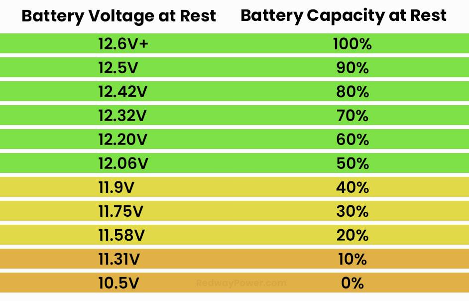

  13. FYI I was given this table by alpha batteries. Applicable for gel batteries:
