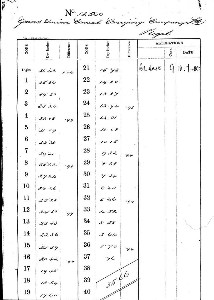

WJM Posted December 13, 2007 Report Posted December 13, 2007 OK - I have the basic principal, the more weight in the boat the lower it sat in the water, the less of the boat above the surface, measure the height above the surface, apply some maths and bingo, the weight of the cargo. How exactly did the process work - what information was in the gauging table (four entries for measurement at the four corners?) and how did the maths work to produce the result? Following on from that, were there any 'tricks' used to manipulate the results. At major canoe regattas we often have our boats weighed after a race. It is fairly routine for anyone whose boat is a borderline on weight to 'accidentally capsize' as they approach the weighing station to ensure the boat has a film of water all over the inside that the scrutineers cannot empty out. The commercial boatmen must have had their fair share of tricks either at the time of the original gauging or during operation.
Liam Posted December 13, 2007 Report Posted December 13, 2007 I beleive that the boat's freeboard was measured when it was empty, and then measured again every time equal weights were added. Once they got to a certain point, whatever it was, for example 16 tonnes, they were able to guage how much the boat could take when it was sat "X" deep. I'm guessing that a copy of these results were kept at guaging points over the system.
WJM Posted December 13, 2007 Author Report Posted December 13, 2007 I kind of had that much already - I am trying to understand the actual calculations. If the boat is heavy at one end and light at the other (which it could well be) how was the maths done to arrive at the weight? What info was in the tables? To throw another question into the mix - when did they stop gauging? - there were cargo boats still operating on the Southern GU in the 1980s. Were they still gauged then?
magnetman Posted December 13, 2007 Report Posted December 13, 2007 I reckon take 4 measurements at each load weight then average the readings taken each side and end then use tables or a special slide rule to calculate a 'tons per inch immersion' equivalent for the particular boat. Narrow boats have a high 'block coefficient' so these calculations would be relatively straightforward.

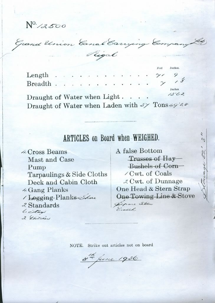

zenataomm Posted December 13, 2007 Report Posted December 13, 2007 Interestingly my post on this forum: - Forum: History & Heritage · Post Preview: #161570 · Replies: 4 · Views: 210 And I'm still waiting to hear. Yes they did measure the amount of dry at points along the side and took an average, and yes copies were kept at the various gauging points. The sheets also listed the ropes, stove and dunnage that formed part of the boat's inventory.
WJM Posted December 14, 2007 Author Report Posted December 14, 2007 Zen - any chance you could post the Gauging Table on the forum? Have you got it as a scan?
zenataomm Posted December 14, 2007 Report Posted December 14, 2007 Zen - any chance you could post the Gauging Table on the forum? Have you got it as a scan? They are large sheets, but I'll do me best!

Hobbler Posted December 14, 2007 Report Posted December 14, 2007 There was a Gauging Dock above Factory Locks at Tipton on the BCN . When a boat was first gauged set weights were loaded into the empty hold and the freeboard measurement taken as each weight was added . Mind you they did not always get it right and there are several photographs of boats actually sunk in the dock when too much weight was added. There were various tricks that could be employed to "Increase" the load . Two I witnessed in the 50's was to hose down a dry load just before reaching a gauging stop and another was while the load was actually being gauged to distract the gauging clerk while he was taking the load measurement and try to get your mate or anyone else to stand on the gunnel on the same side as the measurement was being taken. Obviously most clerks were wise to this one but it was sometimes possible to get away with it.
zenataomm Posted December 14, 2007 Report Posted December 14, 2007 Zen - any chance you could post the Gauging Table on the forum? Have you got it as a scan? Scanned them, they've come out better than I thought, just come to post them on the thread and realised I don't have an eight year old to show me how. I'll go back through the forum I'm sure there must be a how to do it somewhere, before I hit the bottle and give up on boats and canals for ever. zenataomm
zenataomm Posted December 14, 2007 Report Posted December 14, 2007 Good old SuperMalc, I might have guessed he'd be our saviour, does every forum have a SuperMalc? So having followed his guide for dummies ........... here follows two scans of the guaging sheets ................
Hobbler Posted December 14, 2007 Report Posted December 14, 2007 Of the items listed as on board I presume tarpaulins and side cloths are we now call top cloths and side cloths but what are deck and cabin cloths . Are deck cloths the same as tippetts or something different ? and are cabin cloths what was used to protect the expensive signwriting on the cabin sides ?
Keeping Up Posted December 14, 2007 Report Posted December 14, 2007 Pretty close to the rule-of-thumb estimate of 1" per ton

carlt Posted December 15, 2007 Report Posted December 15, 2007 (edited) Of the items listed as on board I presume tarpaulins and side cloths are we now call top cloths and side cloths but what are deck and cabin cloths . Are deck cloths the same as tippetts or something different ? and are cabin cloths what was used to protect the expensive signwriting on the cabin sides ? Photo of Lucy with, what I understand to be cabin cloths: Rose usually had the cloths pulled all the way down, though. The tarp over the back deck may be the deck cloth? (Thanks, Alan, for sharing those wonderful two photos, btw) Edited December 15, 2007 by carlt
Hyperion 53 Posted December 15, 2007 Report Posted December 15, 2007 A deck cloth is the cloth that fits over the deck board forming part of the cratch. In the picture below you can see the deck cloth over the deck board on Badsey at Dadsford shed whilst President was being relaunched. In most cases you fit the deck cloth first, then pull the side cloths up and lay the top cloth over followed by the tippet on top. There aren't many boats running around these days with such cloths fitted.
carlt Posted December 15, 2007 Report Posted December 15, 2007 (edited) Excellent! Thank you! Was I right about cabin cloths? It's what Laura Carter called them when I was chatting to her some years ago. Edited December 15, 2007 by carlt
Hairy-Neil Posted December 15, 2007 Report Posted December 15, 2007 (edited) By dunnage do they mean:- 1. Loose packing material used to protect a ship's cargo from damage during transport. 2. Personal effects, baggage. Or perhaps 3. Both of the above Edited December 15, 2007 by Hairy-Neil
carlt Posted December 15, 2007 Report Posted December 15, 2007 I understood "dunnage" to mean packing material.
John Orentas Posted December 15, 2007 Report Posted December 15, 2007 (edited) I understood "dunnage" to mean packing material. Collins new English; "Loose wood of any kind laid on the bottom of a ship, to keep the cargo steady or prevent injury from bilge water".. "Etymology unknown". Edited December 15, 2007 by John Orentas
