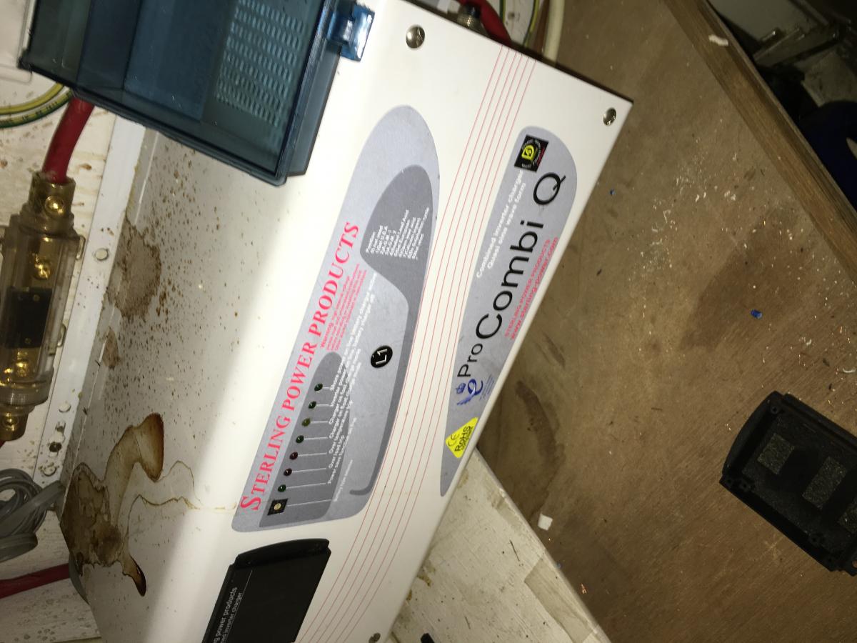

I have just bought a cambridge audio bluetooth speaker. It is my only thing that requires 240v and hence the first time since buying my boat that I need to run something out of the mains.
I have a steeling 2500w quasi sine wave inverter, all is working, i do get a buzz on the speaker which im hoping to fix with a power conditioner from richer sounds.

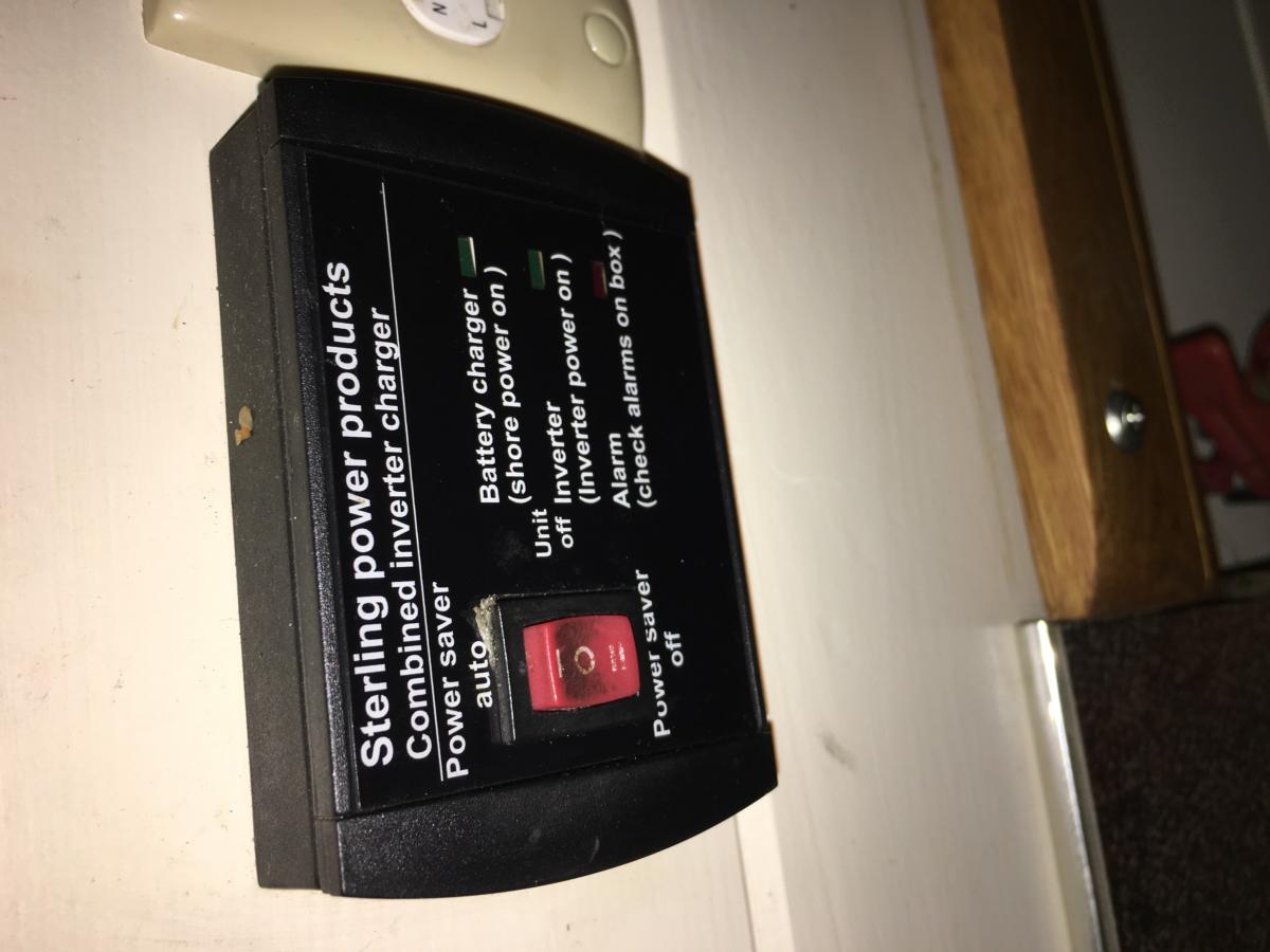

My main qustion is what is the correct position for this switch. The bluetooth on the speaker only seems to work when it is down (set to power saver off) but the speaker appears to switch on when it's up.
It would be great if somebody could explain what this switch does exactly as I've completely forgotten as I've not used it since buying the boat (where he briefly explained it)
Please see photo of switch attatched
Possibly the reason why your soundbar only works with power saver mode off, is because the soundbar doesn't present enough load to make the power saver mode work.
IIRC in power saver mode the inverer switches off until it detects a load. If the load is the soundbar is below this threshold, then the inverter won't switch on.
What load does the soundbar present? It may be better to buy a small dedicated inverter for it.
Thanks for the responses, the wierd thing is the light still turns on in powersave mode, but bluetooth only works with power saver off.
So can I leave it in powersaver auto and that won't drain batteries when the mains are not in use?post-26942-0-07851600-1480246438_thumb.jpeg
Cuthound is spot on with his diagnosis, we come across this problem a lot when we fit these inverters, when people try to charge there mobile phones with the inverter switched to power saver mode and no other 230v loads on.
Ok, thankyou. So is the only workaround switching to powersave off mode when I want to use the speaker?
Yup.
And, then the problem that you have is that the Inverter is using twice the power just to 'operate' than you need to run the speaker.
You may find that you are drawing 3 amps just to run a small low wattage speaker.
Or add some more load like a standard lamp but that would consume more power from your batteries.

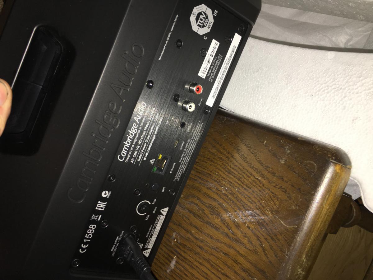

Hmmmmm - looking at the photo it appears that the 'speaker' is 150w (power consumption)
That equates to approximately 15 amps being drawn from the batteries ( 4 hours use will reduce a 110Ah battery below 50% SoC - were you aware of how much it used ?)
It should not be a problem activating the inverter.
But maybe you don't see that sort of load until its working and so the inverter doesn't switch on to get it working.
I was aware it would probably use a fair bit of power, but It's worth it smile.png
OK - no problem as long as you take it into consideration when recharging you batteries and remember that 4 hours of use is equivalent to running THREE 12v FRIDGES FOR 24 Hours
