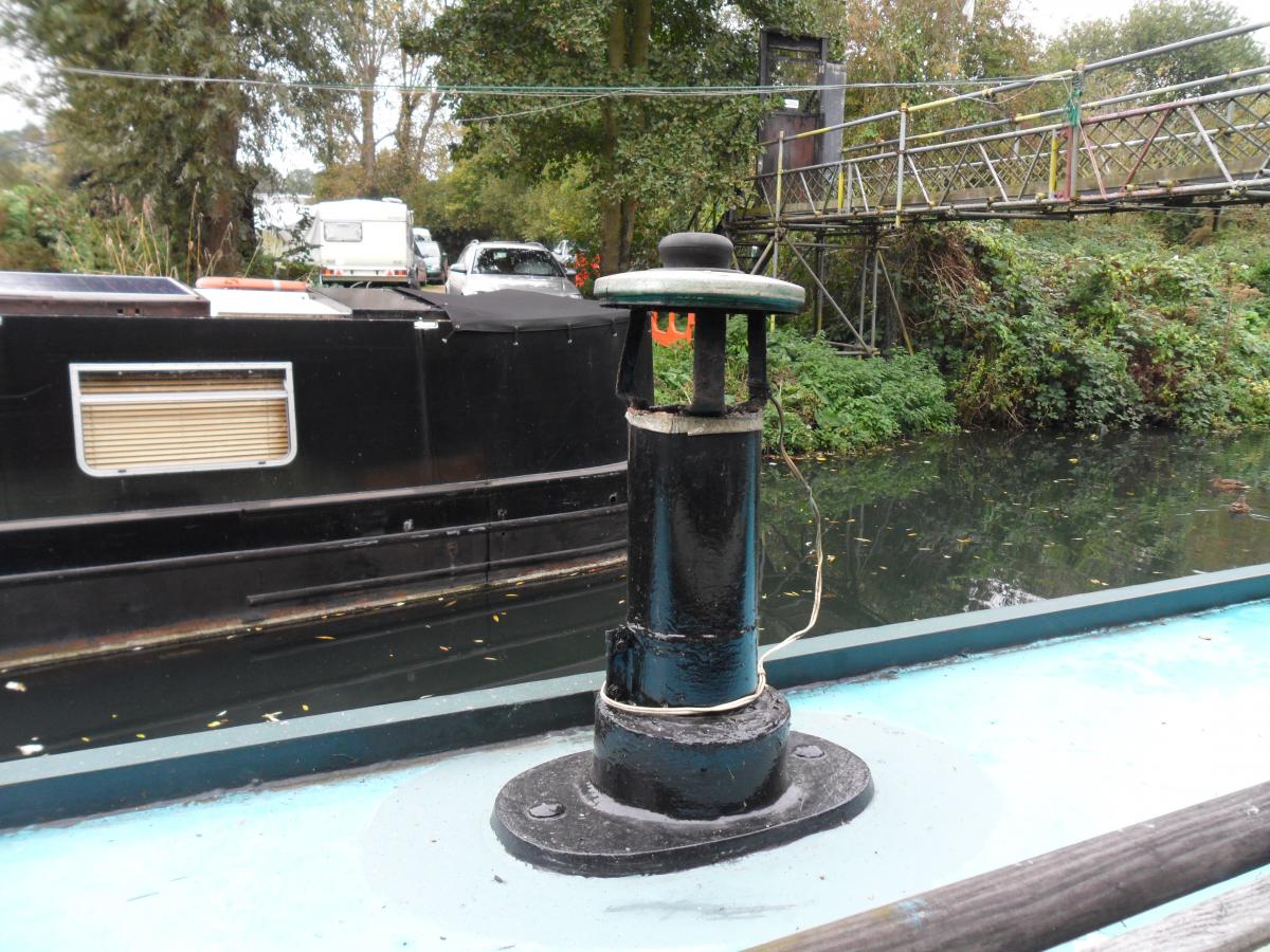

Ahoy Nick. If you have the usual sort of daft chimney that overlaps the collar flange I'd chuck it just lightly silicon a bit of pipe INSIDE the collar orifice. Also make sure all your fuel is perfectly dry before using it. Bagged smokeless coal or whatever is often soaking wet when its bagged, it's normally stored in open staithes at the coal merchants, open to the weather. Putting it wet or even damp onto the fire will create creosote and more tar. A pic of my stove chimney and roof[attachment=1392:007.JPG]post-13905-0-86045400-1444997973_thumb.jpg and the stoves alight.

You should clear all that grass out of the top of your chimney though.
