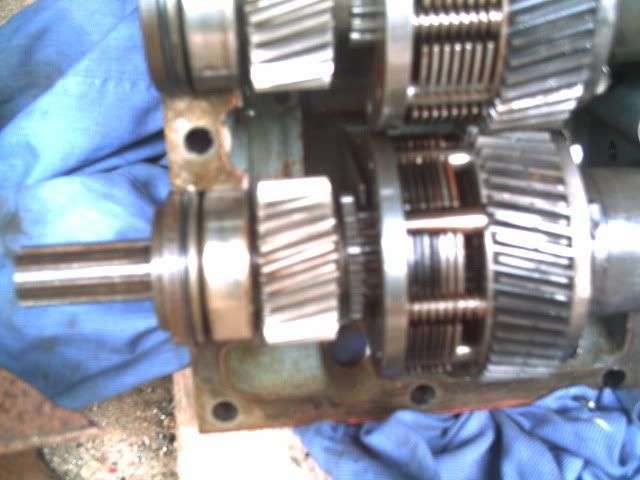

RLWP Posted May 13, 2012 Report Share Posted May 13, 2012 (edited) Would you like to know what's inside your PRM 160 gearbox? I have just finished rebuilding one, so I thought I'd share some pictures. This box is similar to some of the other boxes, like the 260 The basic box has three assemblies that do all the work, the input shaft, the layshaft and the output shaft. Here are the input and layshaft lying in the gearbox cover: On the right is the input shaft, on the left the layshaft. In this view, the cover is upside down. The splines at the front of the input shaft engage with the driveplate. On the back of the layshaft is a sticky-up casting. This is the oil pump. These two shafts are permanently coupled together by the large gears at the far end, so one goes the same way around as the engine way, the other the opposite way. This is how this box gets it's reverse direction. Here is the output shaft engaging with the input and layshafts - remember, this is upside down in this picture. The output shaft sits in the bottom of the box. Again, the output shaft is permanently engaged with the drive pinions on the input and lay shafts How does it work then? Each shaft has a multi-plate clutch on it: There are a stack of plates driven by the shaft, and a stack of disks splined onto the pinions. Each shaft has a hydraulic piston that squeezes this clutch to engage the drive. This is the reverse pinion with a drive disk - this one is a bit tired And here is one of the driven plates: The plates are driven around by six of these tubes, which are bolted to the big gear on each shaft This is the piston sticking out of the big gearwheel: It is this piston that squeezes the clutch plate stack and engages the drive. For comparison, here is the piston when drive is disengaged: The shaft rotates inside the casting on the left, which carries the oil to and from the piston. So, moving the lever on the valve block pushes oil into one of these shaft assemblies and drives one of the pistons out. The piston squashes the clutch plate stack and locks the shaft to the small pinion. This pinion drives the gearwheel on the output shaft, and Bob's your uncle Richard Edited May 13, 2012 by RLWP 3 Link to comment Share on other sites More sharing options...

twinpot Posted May 13, 2012 Report Share Posted May 13, 2012 I shall look at my gearbox with utter admiration from now on,thanks for posting that. Regards. Twinpot. Link to comment Share on other sites More sharing options...

granddad Posted May 13, 2012 Report Share Posted May 13, 2012 thanks for that it was very informative. My prm160 has an allen key in a housing to lock it in gear when the clutch is worn where's that and how do I do it. My gearbox is 13 years old should I replace it? when will I know its on the way out? ken Link to comment Share on other sites More sharing options...
