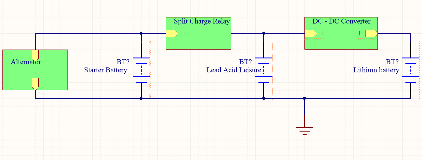

Mikexx Posted October 16, 2024 Report Posted October 16, 2024 1 hour ago, The Alchemist said: The split chargers purpose is to charge two lead acid battery's, the primary is the starter battery and the secondary is the leisure battery. The lithium battery has to have a lead acid battery between itself and the alternator as the output of the alternator is not adequate for lithium batteries. The dc to dc charger then adjusts the output from the lead acid battery to the charge requirements of the lithium battery so that they are then charged through the system. Can you confirm the wiring is like: In which case there isn't a need for the LA leisure battery. Given the DC-DC load is within the alternator capacity I doubt the alternator would suffer any damage from extended charging.

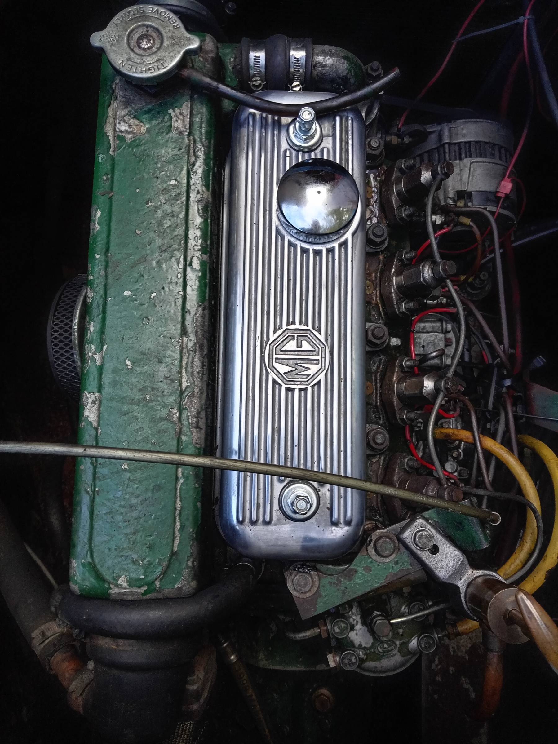

GBW Posted October 17, 2024 Report Posted October 17, 2024 (edited) It seems likely this is too late but it is possible to buy a cast aluminium rocker cover that is in a different league to the tin one. Refer to my relevant post in this forum;- That leaky rocker box. Edited October 17, 2024 by GBW addendum

Mikexx Posted October 17, 2024 Report Posted October 17, 2024 On 16/10/2024 at 19:40, The Alchemist said: Yes. Your diagram pretty much displays my set up. I was given a similar diagram of the recommended layout for a lithium battery system when I purchased it from the supplier and it included a lead acid battery in the diagram. I assumed it was to encourage the alternator to continue putting out a charge into the system and so that when the lithium battery was at full charge the dc to dc charger would cut out allowing the lead acid to fully charged as a means to kickstart the dc to dc charger when the system starts. I never questioned the reason behind it! You are correct in that when Lithium battery's BMS system disconnects the batteries you still need to present a load to prevent the alternator output voltage from climbing to high values and destroying anything connected to it. However you already have the starter battery that will limit voltage and present a load in these circumstance. So there is no need for the second LA leisure battery. It's one time a split charge relay or voltage sensitive relay or a DC to DC converter should work well with a single alternator. I, for instance, have a second alternator and should I change to lithium I would leave a lead acid for those occasions where load dumps would destroy anything connected to the alternator, and quite possibly the alternator itself.
Tony Brooks Posted October 17, 2024 Report Posted October 17, 2024 11 minutes ago, Mikexx said: However you already have the starter battery that will limit voltage and present a load in these circumstance. So there is no need for the second LA leisure battery. It's one time a split charge relay or voltage sensitive relay or a DC to DC converter should work well with a single alternator. Not sure a VSR would work to limit the charging current drawn by the lithium battery, that is where the B2B comes in. I agree with what you say, keeps it simple.
Mikexx Posted October 17, 2024 Report Posted October 17, 2024 10 minutes ago, Tony Brooks said: Not sure a VSR would work to limit the charging current drawn by the lithium battery, that is where the B2B comes in. I agree with what you say, keeps it simple. They seem to kick in around 13.8V and disconnect below 13V. I'm not sure how accurate they are.Some claim to be 'software controlled'. It does generally ensure the starter battery gets a chunk of current first. The usual technique top limit current to lithium batteries is to use a long cable of a cross-sectional area to cope with the target current to introduce some resistance in the charging circuit. Some say that method is a bodge and frown upon it. If a suitably sized cable is used and clipped appropriately I don't see the issue. In practice the length chosen by trial and error and it's not very long.
The Alchemist Posted October 17, 2024 Author Report Posted October 17, 2024 2 hours ago, GBW said: It seems likely this is too late but it is possible to buy a cast aluminium rocker cover that is in a different league to the tin one. Refer to my relevant post in this forum;- That leaky rocker box. Yes. I was expecting this on Saturday but it turned up today. 😊 It came with a cork gasket but I've applied heat resilient silicone which appears to have worked well. 1

GBW Posted October 18, 2024 Report Posted October 18, 2024 15 hours ago, dmr said: A chinese MG in a boat 😀 That will upset a few purists. No - its genuine MGB (and maybe A).
dmr Posted October 18, 2024 Report Posted October 18, 2024 1 hour ago, GBW said: No - its genuine MGB (and maybe A). Yes, just after I posted I thought a bit more and could not think why China would be making rocker box tops for the old B series. I assume that are not still making that engine ? 😀
hider Posted October 18, 2024 Report Posted October 18, 2024 30 minutes ago, dmr said: Yes, just after I posted I thought a bit more and could not think why China would be making rocker box tops for the old B series. I assume that are not still making that engine ? 😀 1.5D was made in India and the 1.8D in Turkey. I suspect that production may well have ceased. India used the engines in the Ambassador cars which were based on the old pre Farina Morris Oxford.
Tony Brooks Posted October 18, 2024 Report Posted October 18, 2024 2 hours ago, GBW said: No - its genuine MGB (and maybe A). I thought he MGA had a very different engine - twin overhead cam possibly.
hider Posted October 18, 2024 Report Posted October 18, 2024 41 minutes ago, Tony Brooks said: I thought he MGA had a very different engine - twin overhead cam possibly. No, straight B series OHV 4 cylinder in various capacities and stages of tune. Twin cam was a different model.
NURDLE Posted November 10, 2024 Report Posted November 10, 2024 MGA had both a single and twin cam version. There is a great MGA website that has lots of good info about the petrol version. Some applies to diesels. https://mgaguru.com/mgtech/engine/en1.htm
