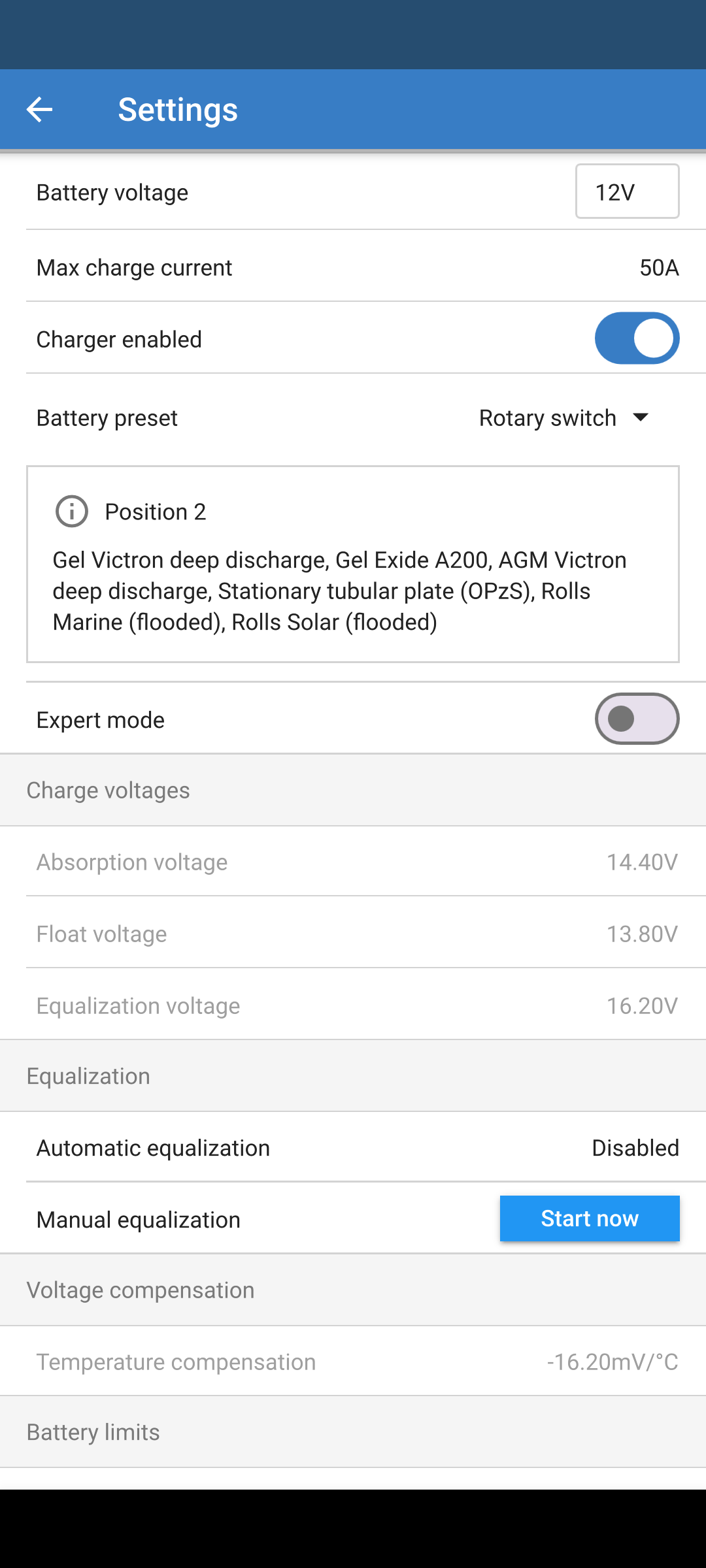

I've got new batteries which are 4 × Numax Sealed Wet Leisure Batteries 12v 105Ah (CXV31MF)
My Victron MPPT solar controller gives me the following seven battery options for setting up the controller (see photos) - none of which are to me an obvious match for my batteries, but you guys and gals may know better.
Please can you tell me which of these are a suitable setting for my batteries? Thanks

Without the battery data I would think 2 will be fine and 1, but 1 would be a little slower to charge the batteries, you may not notice the difference.

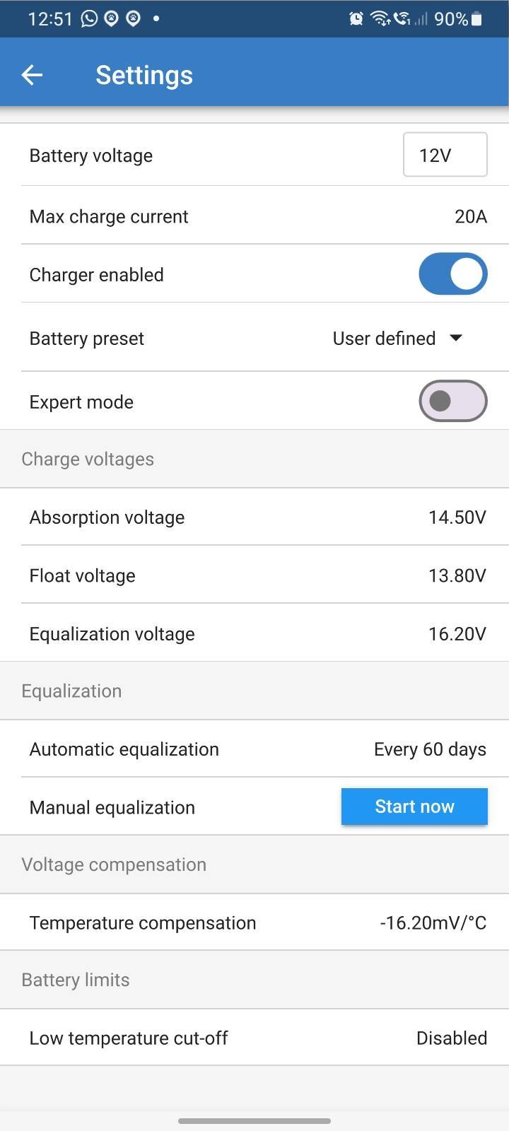

There is a user defined setting. Basically you can edit the settings and save the modified set up. Here is a screen shot of mine. Similar flooded LA batteries.
Leave everything else as is.
Is Equalisation recommended for Sealed Wet batteries?
At the moment Equalisation is set to Manual only.  I've used settings 2 which I think means the Equalisation voltage is 16.1v.
Should I change it to automatic equalisation rather than manual? And is that voltage okay for my type of batteries?

I wouldn't try to equalise a "maintenance free" battery I wouldn't take it above 14.4 volts

I can't see the rotary switch on mine so I've set it via the app. I think this means the same as yours @Rob-M
