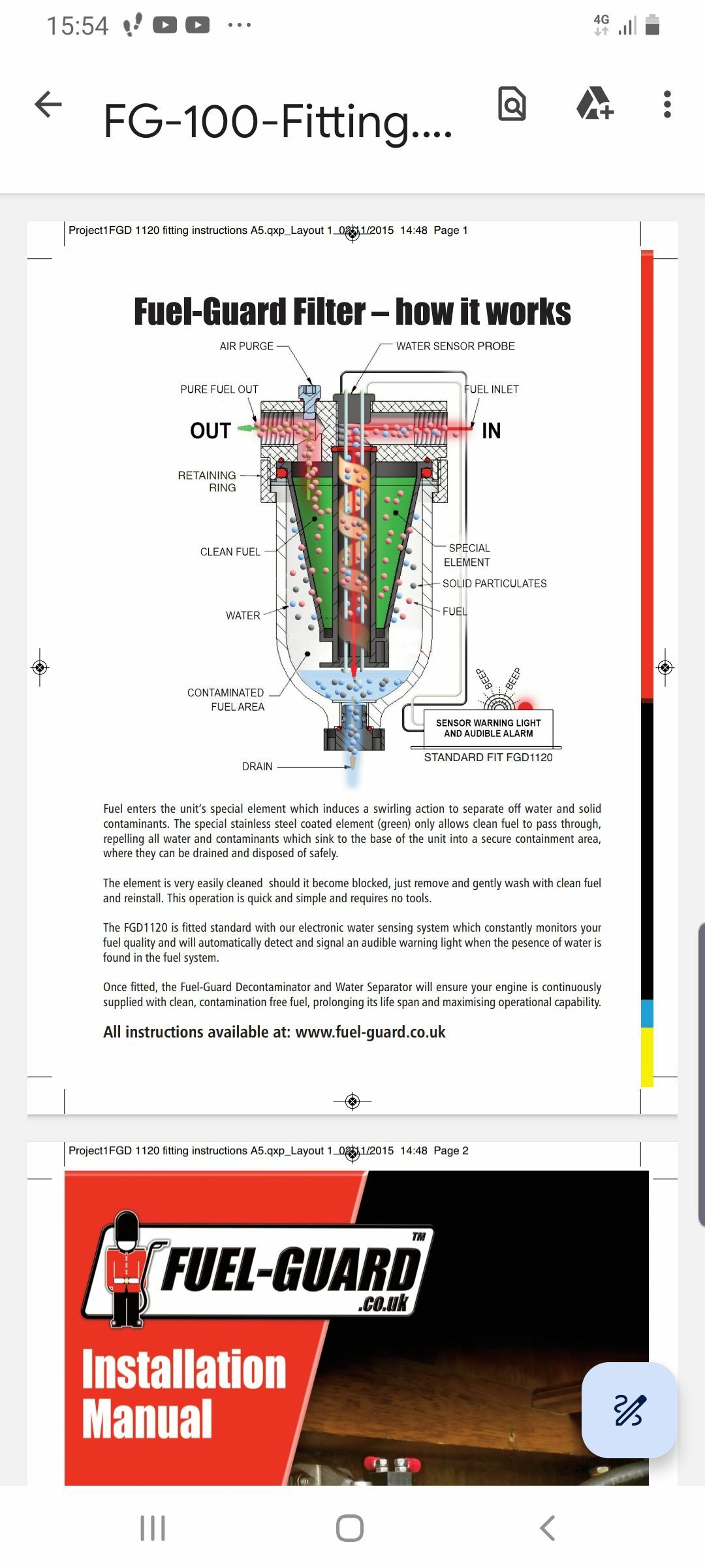

 I have one of these fitted as first filter from tank to engine and never had a problem with water/fuel.
https://www.ebay.co.uk/itm/115943365015?mkcid=16&mkevt=1&mkrid=711-127632-2357-0&ssspo=V6ViuM71S7W&sssrc=2349624&ssuid=1dHCkYGlRKG&var=&widget_ver=artemis&media=COPY
I have similar on mine they work well, mine has a washable filter which is handy, its also clear so I can see water if its present

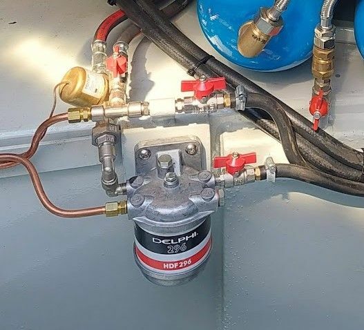

This is the one I was talking about...
