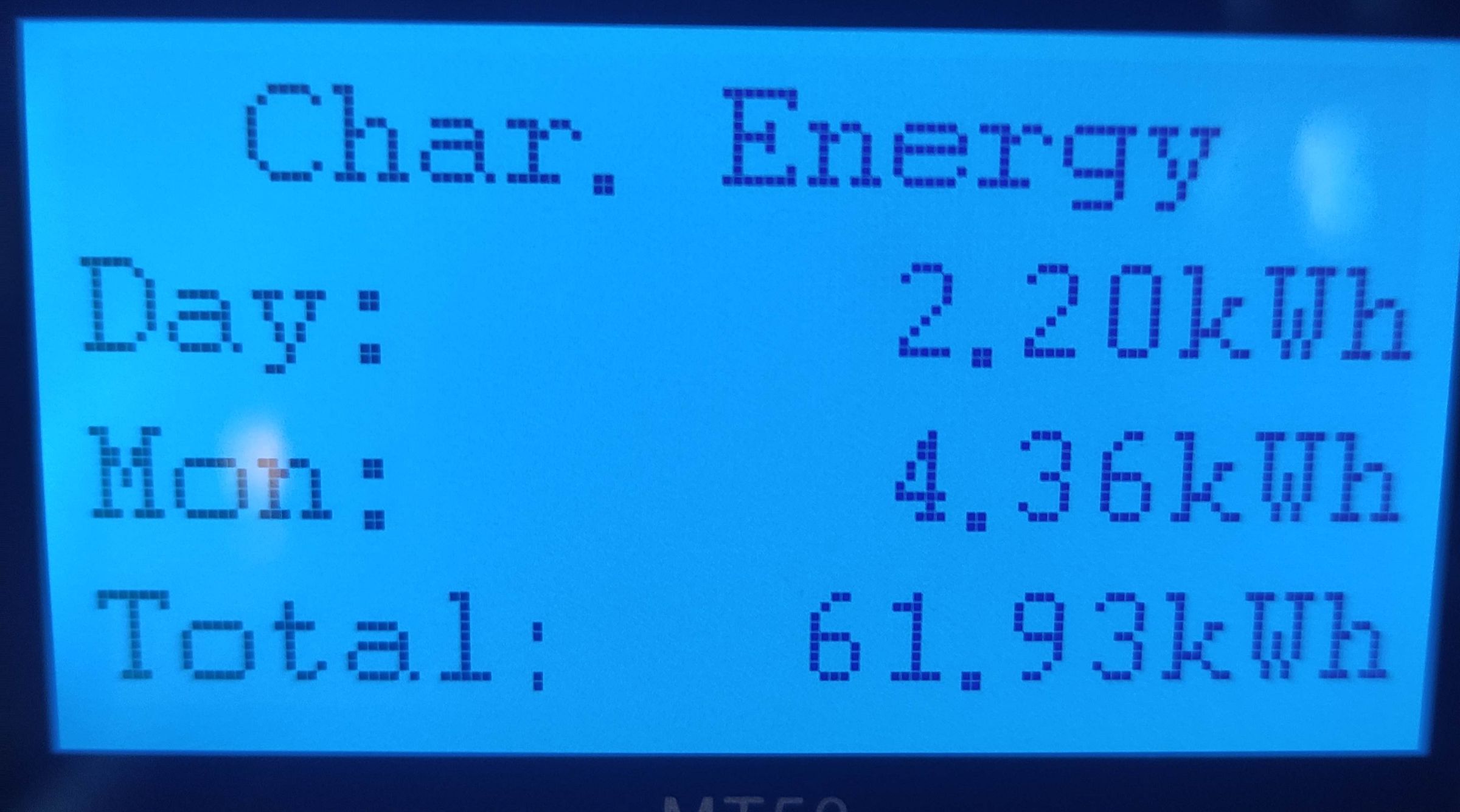

Since I installed my solar panels just under 3 months ago I've generated nearly 62 kWh of electricity from the panels and I've used 98 kWh of mains from shore power. Today was exceptional and I ended up getting 2.24 kWh from the panels, the most in one day so far.
So is it as simple as saying that since I started 38% of my electricity consumption has come from the panels?
The panels charge the batteries which are used to run mains appliances and run my 12v system, whereas mains power is used direct to run appliances direct (and also occasionally to charge my batteries with the battery charger). So I can't quite get my head around whether all the power I'm generating with the panels is actually being used or if some of it's being lost in the charging process so it doesn't all count as consumption?

Yes once the batteries are full the amps will drop and solar controller will reduce the power coming from the panels, but what's shown on the display unit already accounts for that. The kWh shown is what's come though the controller.

Obviously the mains kWh is correct. But the solar kWh is complicated!
Efficiency of solar power that is used instantaneously by dc appliances, very nearly 100%. But there won’t be much of that.
Solar power going directly to power ac appliances - about 85-90% (inverter losses)
But then if you bring batteries into it… about 93% charge efficiency. So for every 100Ah you put in, you get back 93Ah. But energy (kWh) is the multiple of charge (Ah) and voltage. When the solar is charging the batteries, the voltage might be up at say 14.4v. When discharging it may be down at 12.4v. And a bigger difference for faster charge and discharge. So the voltage efficiency is roughly 86% for moderate loads. So energy efficiency is around 80%. That would be the figure for dc loads.
For ac loads from the battery you need to add in the inverter efficiency so we are looking at around 70% efficiency. Ie 70% of solar input energy goes to operate ac loads when powered later via the battery.
Your basic assumption is broadly correct, provided you have not used the  engine, or a generator, to charge your batteries, or run any other power consumer and also provided the batteries were at the same state of charge at the start and the end  of you counting period.
Your solar will have provided more power to the batteries than the batteries will have delivered to your 12V (24v ?)  loads, because of charge inefficiency, but the lost power will eventually have appeared somewhere as heat. Exactly how much went missing is very difficult to guess, because sometimes (battery  full, small load on )  the solar is driving the loads directly, sometimes it is doing part of the work, and sometimes it is doing nowt, (night)  but the battery is discharging and will need to be filled up when the sun returns.  Similarly, if you have used a mains battery charger some of the mains power will have been lost in charge inefficiency.

Charge efficiency on battery monitors etc is the efficiency in terms of charge (the physical thing with units of coulombs or Ah). Not the same as energy efficiency because of course charge does not have dimensions of energy. Confusion is caused when people refer to charge as the charging process and others to the physical property of coulombic charge.
Yes, I've realised it is a bit complicated, if not only for the fact that if you draw loads from the batteries while the sun is shining you'll get more out of them than if you just leave them to charge the batteries. Yesterday I ran the washing machine and topped up my batteries and ended up generating 2.25 kWh from the panels. Today was just as sunny but the panels only ended up generating 1.41 kWh because I wasn't really using much power.
