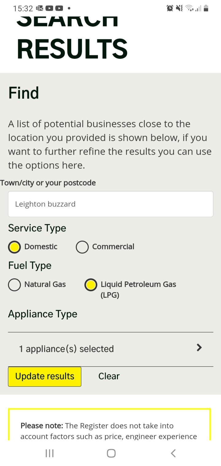

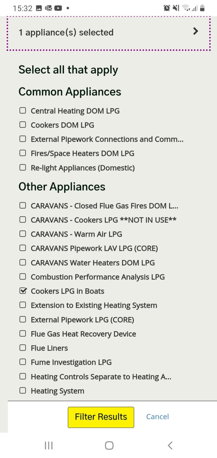

I did a search on the GS Register for Leighton Buzzard, ticking Domestic and LPG and under Appliances ticking Cookers LPG in boats. I got 50 results and checking the services offered by the first few, all had a tick in the relevant box.
Not the most user-friendly of websites to search, but the info does appear to be there.

Hey David. I do not see how to select by LPG in boats.  Is there any screen shot or more info you can send. Much appreciated. If it is just me being dumb please help!
On a laptop, you search for gas bods in your area, then there is an option to filter results by type of appliance

Tony, I think you have to search in your area for everyone on the register first. Once you've done that, you get a screen offering you ways to filter the results by all those categories.

I just got a load of "display" boxes with showing the entries with no obvious filter for marine or similar. I clicked on a few names and got a table with ticks and crosses showing what each can do. After looking at four I gave up. The OP seemed to find something similar. It looks like a typical site done by a web developer who has little idea about what customers need. Probably the specification Gas safe gave them was not detailed enough or Gas safe have little interest in serving minority interest users.

At the top of the results page it says "A list of potential businesses close to the location you provided is shown below, if you want to further refine the results you can use the options here."
Select LPG and then the filter is under "Appliance Type".
It does work and i’ve reached out to a couple more local guys. It’s against my usual rules to do everything myself, but am worried if I do, Ive no way to test the fix.
