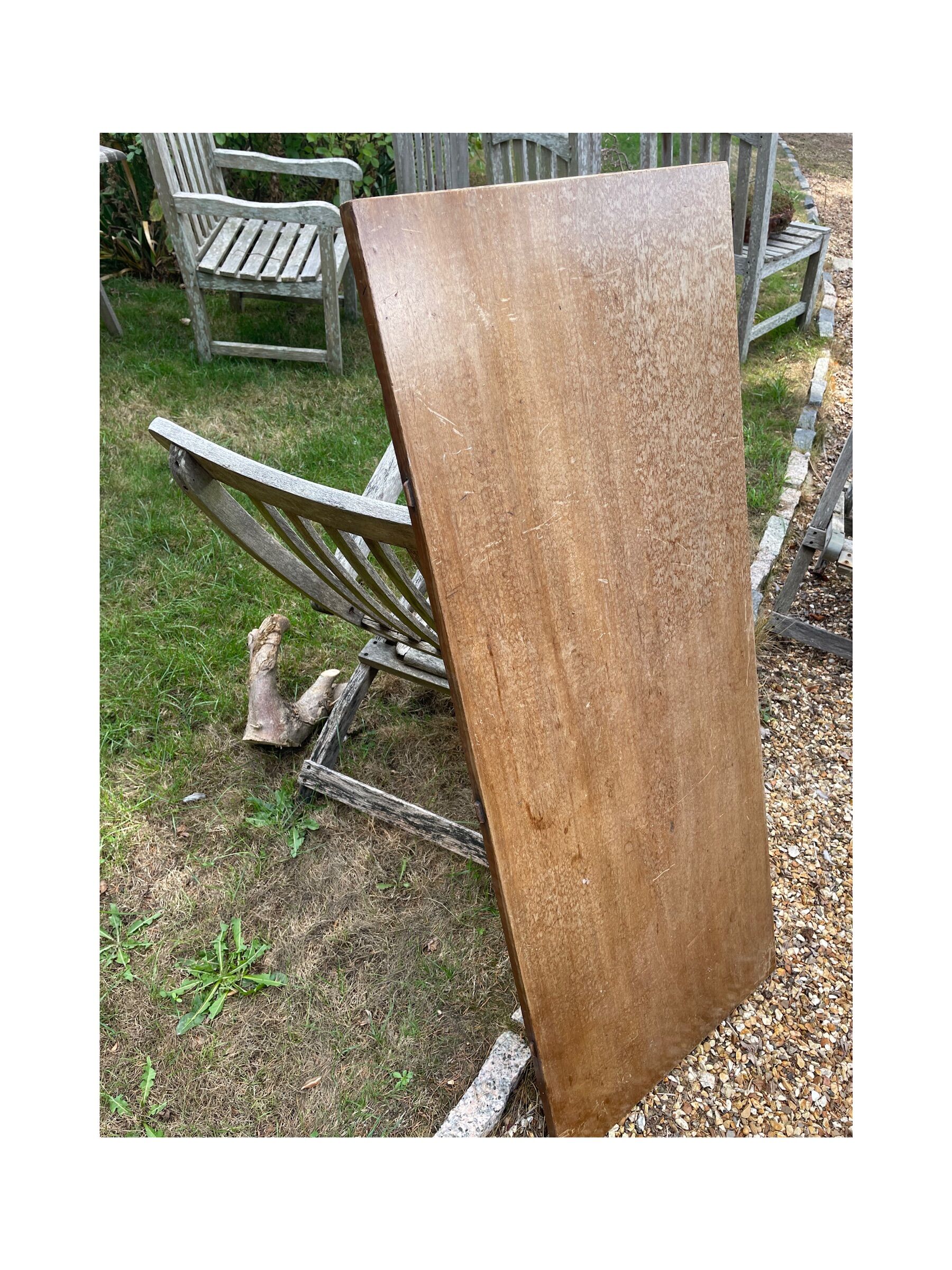

Stroudwater1 Posted August 29, 2022 Report Share Posted August 29, 2022 2 hours ago, David Mack said: I don't think garden furniture has been made of teak for years! It seems to be David , not at B&Q but there’s a fair number who still do it, theres plenty around being binned though as B&Q were doing till at least 8 years ago. Some of the chairs and tables will have enough of the right length I suspect. https://www.sustainable-furniture.co.uk/set-of-2-classic-teak-folding-armchairs?gclid=EAIaIQobChMI_puqxfvr-QIVym1vBB15MAR6EAQYBSABEgJY5PD_BwE 2 hours ago, Tracy D'arth said: Furniture is rarely of a significant section for making such as cratch boards. I suppose you could laminate lots of pieces together, Heath Robinson would be impressed. Old tables are being thrown away at an amazing rate Tracy, found this with two D ends and the centre extending part in a skip two weeks ago. The builders were fine with me having it, and found a brass attachment too 🤣 . It’s a 8-10 foot extending table, Early Victorian I suspect. Brown furniture generally isn’t desired especially big bits as they often aren’t able to fit in small London white houses & flats (Teak chairs on the grass as Im clearing the patio today ☹️🤣) Link to comment Share on other sites More sharing options...
Tracy D'arth Posted August 29, 2022 Report Share Posted August 29, 2022 1 minute ago, Stroudwater1 said: It seems to be David , not at B&Q but there’s a fair number who still do it, theres plenty around being binned though as B&Q were doing till at least 8 years ago. Some of the chairs and tables will have enough of the right length I suspect. https://www.sustainable-furniture.co.uk/set-of-2-classic-teak-folding-armchairs?gclid=EAIaIQobChMI_puqxfvr-QIVym1vBB15MAR6EAQYBSABEgJY5PD_BwE Old tables are being thrown away at an amazing rate Tracy, found this with two D ends and the centre extending part in a skip two weeks ago. The builders were fine with me having it, and found a brass attachment too 🤣 . It’s a 8-10 foot extending table, Early Victorian I suspect. Brown furniture generally isn’t desired especially big bits as they often aren’t able to fit in small London white houses & flats (Teak chairs on the grass as Im clearing the patio today ☹️🤣) Nice bit of timber but its not very thick for a cratch board is it? Link to comment Share on other sites More sharing options...

Stroudwater1 Posted August 29, 2022 Report Share Posted August 29, 2022 41 minutes ago, Tracy D'arth said: Nice bit of timber but its not very thick for a cratch board is it? its 3/4 inch Tracy, how think would a cratch board be? Link to comment Share on other sites More sharing options...
