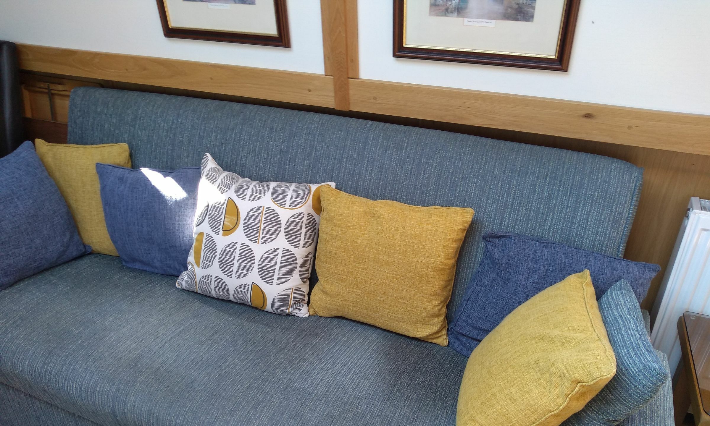

This is ours from Elite. Gunwhale height is 91cm. As you can see the top is about 2cm below gunwhale.

My gunnel didn't limit things as it's higher than yours at about 95cm. In fact, I have actually raised my sofa by about 5cm.
I was merely pointing out that the frame is not the full height of the sofa, so "should" slide under your gunnel, with the back cushion not under the gunnel, but somewhat proud of it.
