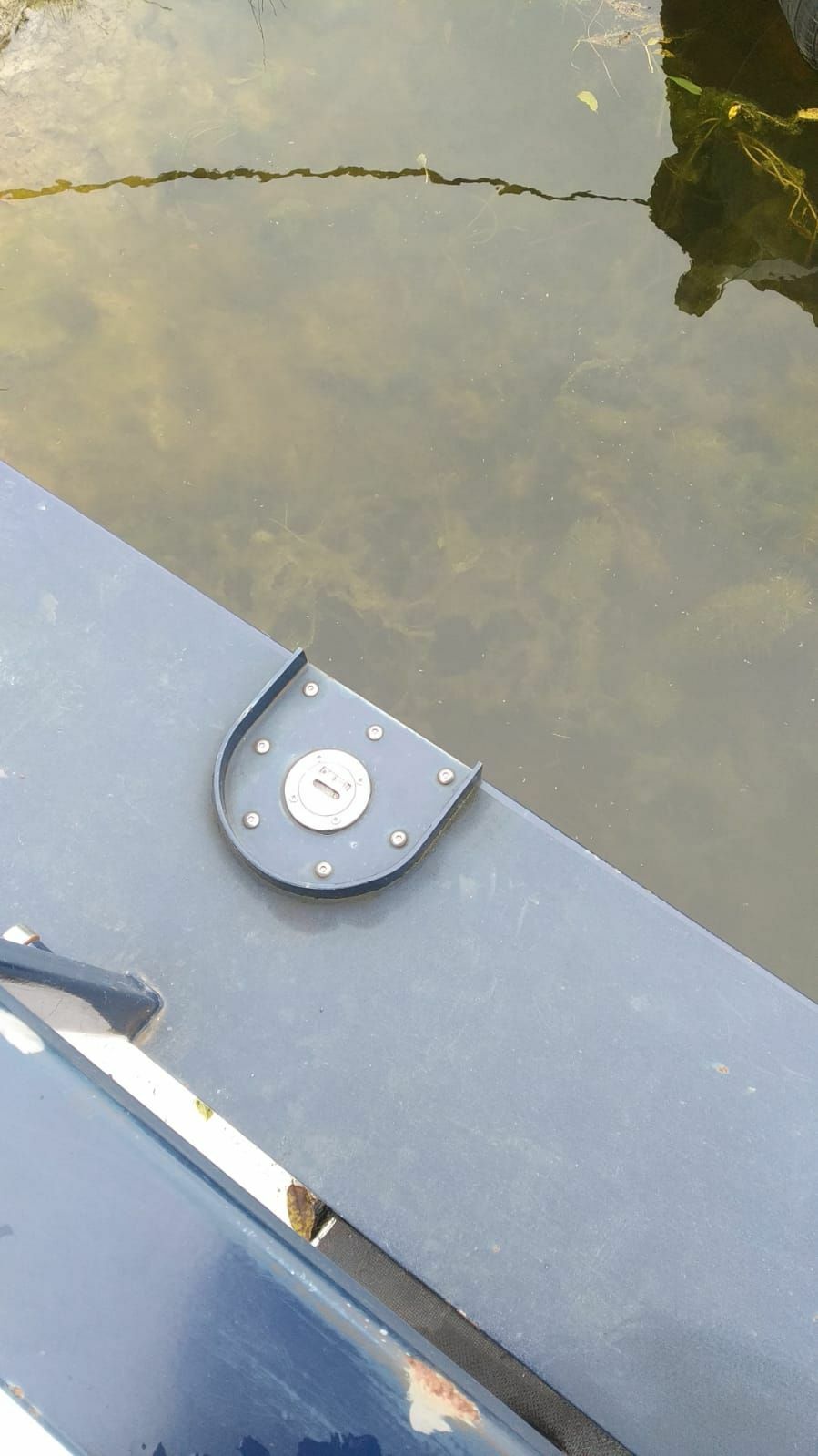

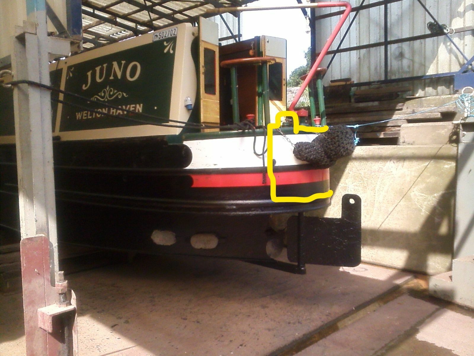

Every narrowboat I have seen or owned has had an integral fule tank constructed in the stern and using the hull as 3-sides of the tank, a steel bulkhead is welded across the curve of the stern and the rear deck forms the top of the tank, or a 'top' is welded onto the tank.. A filler tube is positioned on the rear quarter and flows either directly into the tank, or via a short pipe.
The fuel tank is normally between the weed hatch and the 'transom' and will often have the rudder running thru' the tank.
This was the filler on our last NB and opened directly into the fuel tank (ie what you can see is the 'top' of the fuel tank.
Our fuel tank location and using the hull as the walls of the tank.
Nice looking boat and love the lockable fuel cap. I presume the rudder top hole is for towing a dingy ??
No, it is so you can tell that the trim of the boat is correct. Hole should be 50% submerged (ie just a semi-circle above the water).
If you can see a 'full' hole then you stand the chance of prop aeration / cavitation. If you cannot see any of the hole, the backend is too deep and the boat not lying 'flat' in the water.
