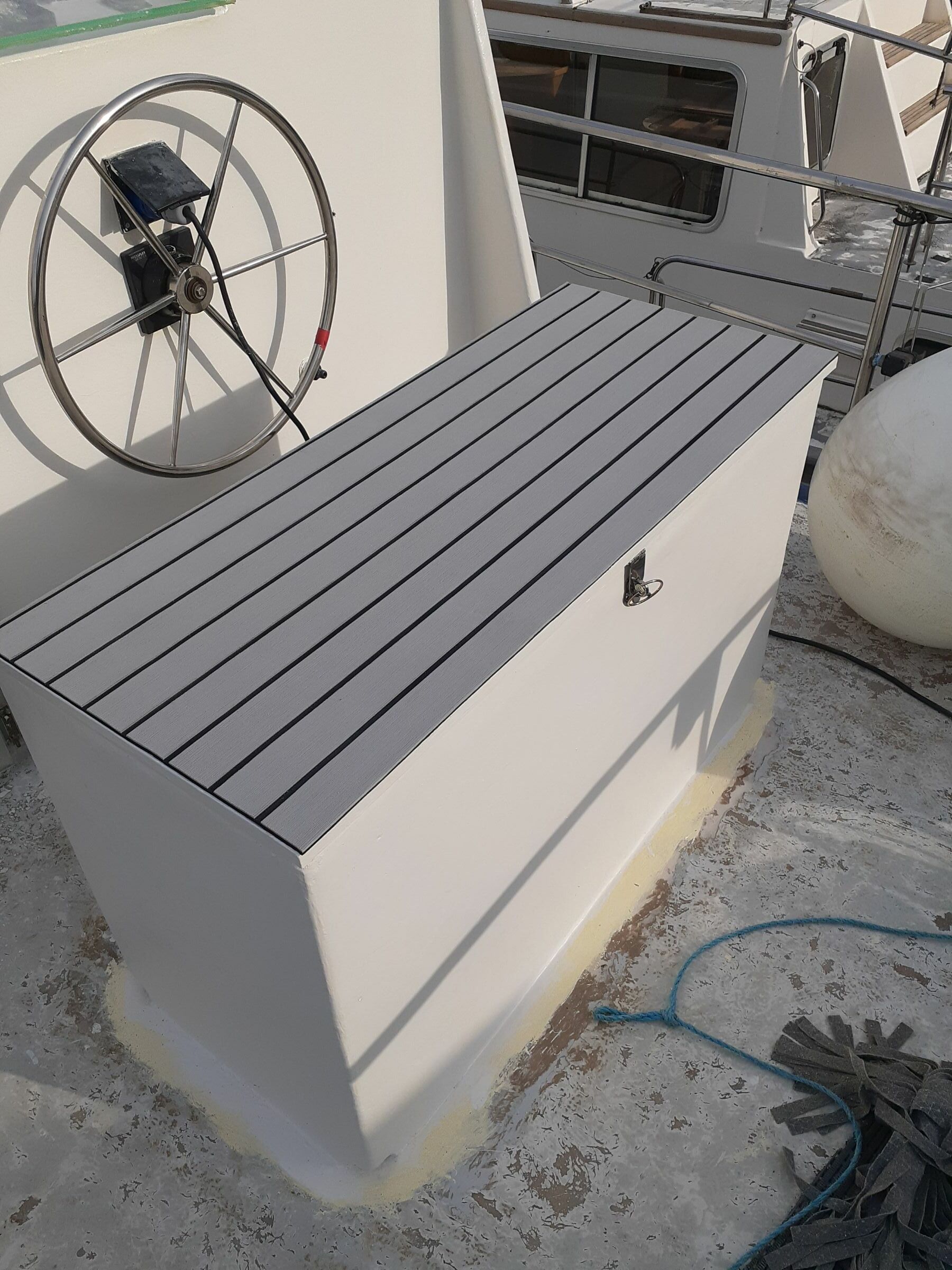

Alan de Enfield Posted July 24, 2021 Report Posted July 24, 2021 (edited) 55 minutes ago, PaulG said: Hi there - thanks for the responses - please see these pictures of the broken unit. Thats the same os the one on my boat - if you don't get sorted before, I'm going on Thursday so will see what can be seen, My shoreline goes thry the wheel to get to it (makes sure you never drive off with it connected) In the middle of priming and filling : Edited July 24, 2021 by Alan de Enfield
