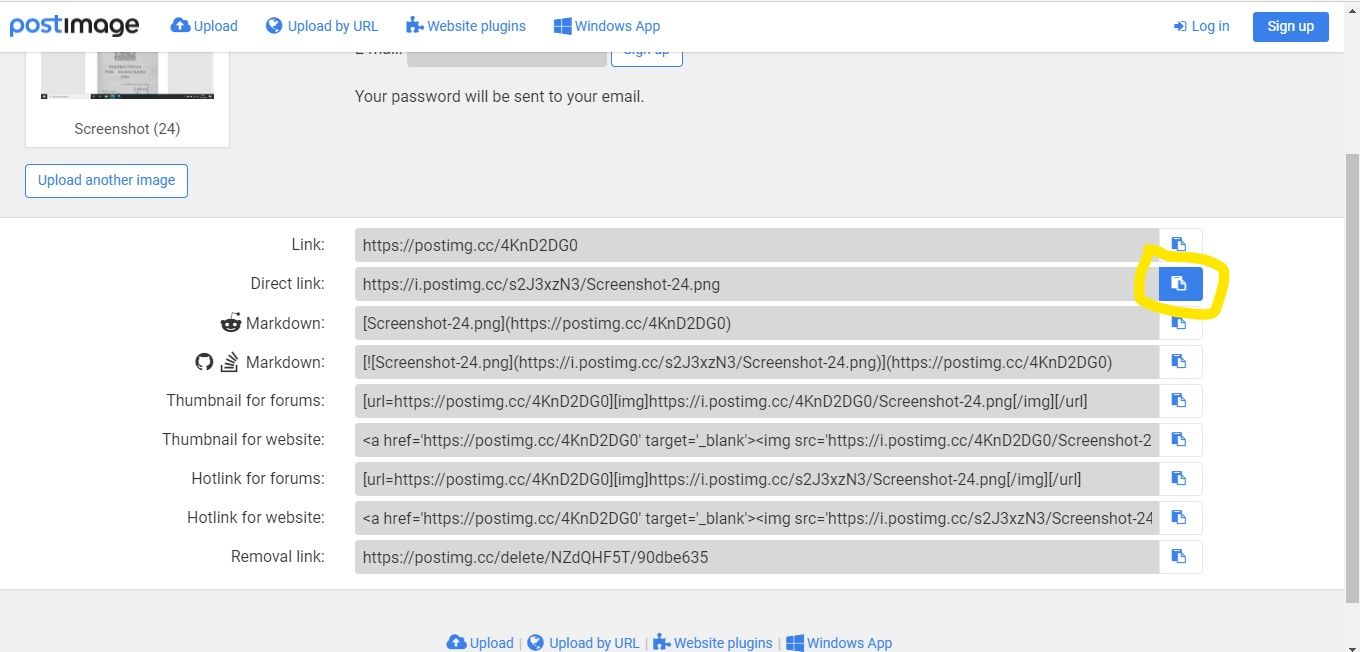

If you upload it here :
Postimages — free image hosting / image upload
That site will host the picture and you can copy and paste from there to here.
Once it is uploaded onto the postimages site, click on the little blue box on the RH side of the second line (called "direct link")
This copies it, then simply come back here and write your message and right click 'paste' and it will be automatically inserted into your post.

Hi All,
thank for teaching me a new way to upload pics.  My dyslexia kicked in yesterday and frustration not being able to share.
I hope the pics make sense as I am disabled and found it hard to get in and out of engine bay.
