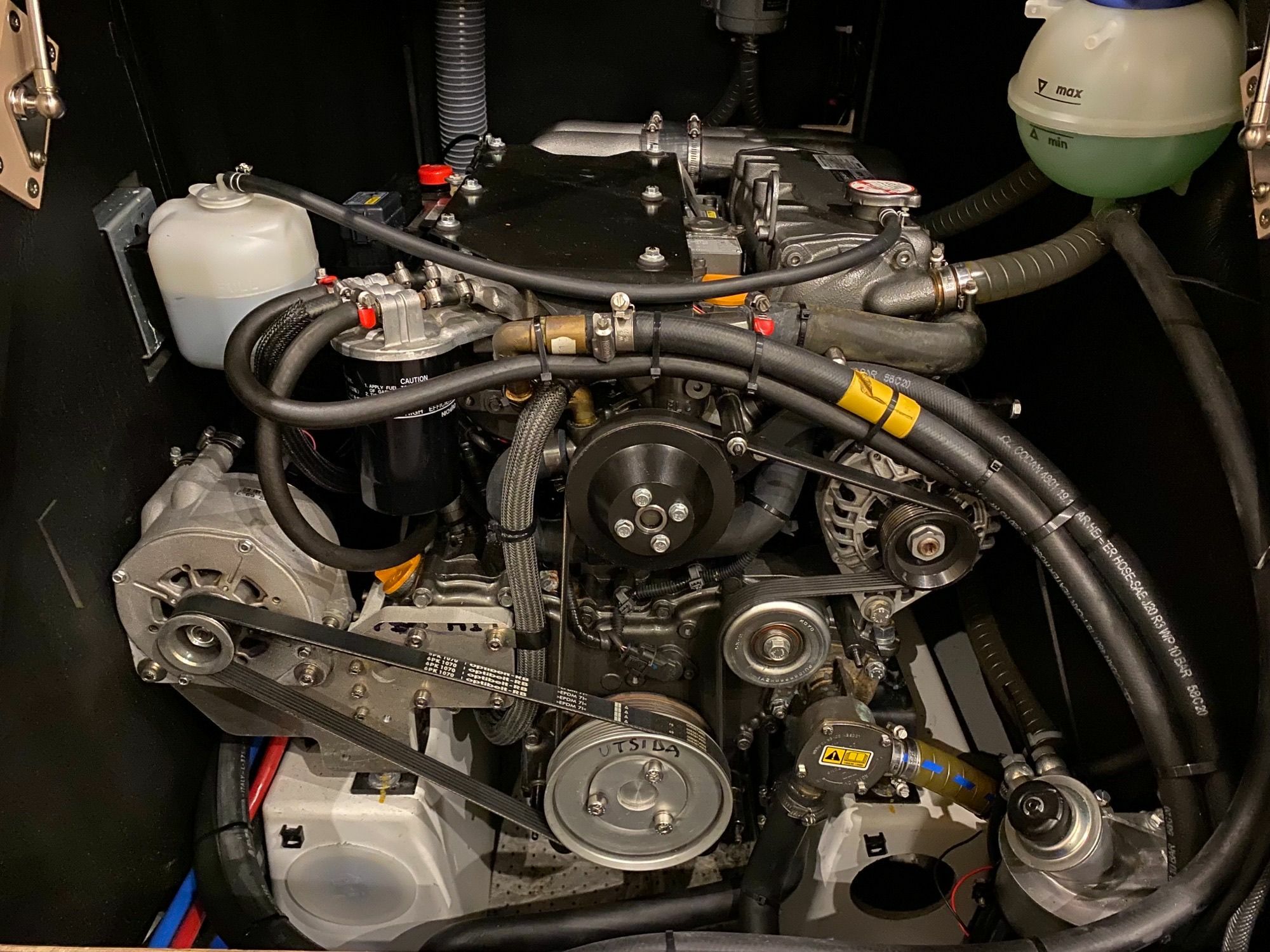

I find on this forum that you have find the Renault / Range Rover alternator as possible to up grade your alternator. I am not a talker, I have done it in my sailing yacht and also my brothers sailing yacht since three years ago. Running for the four season now. I have 10 year old ship with at Yanmar 54 hp and my brothers ship are 5 years old and equipped with at Yanmar 104 hp. The alternator have its own cooling system with at Bosch brush less water pump and a heat exchanger see water cooled in line with the impeller for the cooling to the motor.
I have 540Ah LiFePo and my brother 1400Ah LiFePo. The temperature of the alternator are 1 degree Celsius warmer then the seawater.  My brother have two alternators. The original Hitachi of 125Amp runs burning hot. Its not a nice smell from this one. They are not made for charging LiFe. I will replace that one this winter to the water cooled. My alternator charge in the beginning about 200Amp and after some minutes go down to 130Amp. I have change the ratio to the alternator by +77%. When idling at 650rpm it charge 95Amp and at 800 rpm it charge 130Amp.
All regulators are made for lead acid (Ballmar have one for LiFe but I am not impressed of that one!). A friend have mounted the water cooled 190Amp alternator for VW Toureg and it works also great. He have a separately regulator and he use to charge 200Amp. He also have LiFe
I hope I have filled in a lot of doubts and questions about those alternators.
Sailing regards from Stockholm442348606_Yanmnar54.jpeg.ad8b9a1cc8cb9a3b4eba7ee63d876c72.jpeg1815973570_Yanmar104.jpeg.25d5169c684041319022703bc78d7b3d.jpeg

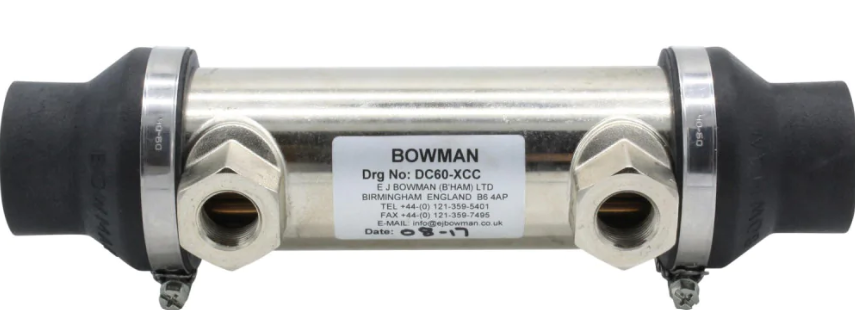

Very neat. Certainly solves the problem! Does it run on raw sea water, or via a heat exchanger? Raw water on canal boats can be problematic due to the silt, weed and other debris.
Thnx Nick
It runs on its own internal cooling system only for the alternator throw a seawater heat exchanger DC 60 from Bowman in Birmingham 🙂
https://ej-bowman.com/wp-content/uploads/2020/09/DC-Oil-Cooler-Issue-K-English.pdf

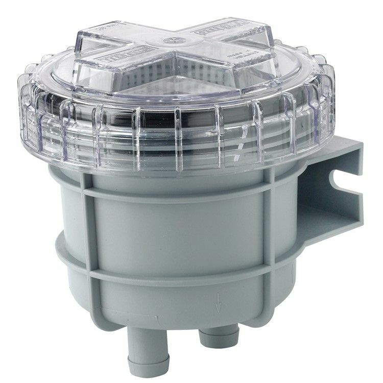

The water to the heat exchanger are coming throw a seawater filter. The source are the inlet for cooling the engine.
Alternator have an efficiency of only 50%. (I have measured this value in a test bench) By 150Amp it’s a heating element of about 2000 Watt distributed by a build in fan.
The heat are the biggest problem to get out more amp from the alternator. Build in regulator reduce the amp by the heat. By mistake a run out of cooling, then the alternator reduce down to 15Amp, the surface temp was 50 degree C.
If you only travel in channels with sweat water and you can get water throw a filter then you probably do not need a heat exchanger. If you do not have a seawater cooling for your engine cause weed etc. then you can use a heat radiator from a car with a fan instead.
Everything started up by a friend rebuild his Volvo Penta by purchasing a used alternator from a scrap Renault for only 40£ 5 years ago.

Are you taping into the engine coolant lines or having a completely separate heat exchanger system for just the alternator? If the later, are you running a seperate coolant pump too?
Iti s running on its own system. Its heat exchanger only for the alternator. Circulation are by a Bosch bruschless pump.
The system has no pressure and its cool. Then temp are only 26 Celsius on the alternator and the cooling water.
This winter i will investigate to make my own regulator. But it shard to get time over with all demands 🙂
The alternator I have are from a Renault 155Amp but I bought a Porsche/Bugatti/Phaeton alternator today and that one are 190 Amp
I friend to me have tested this one in his tow boat and it source 276Amp over one hour. But he has a too simple external regulator.

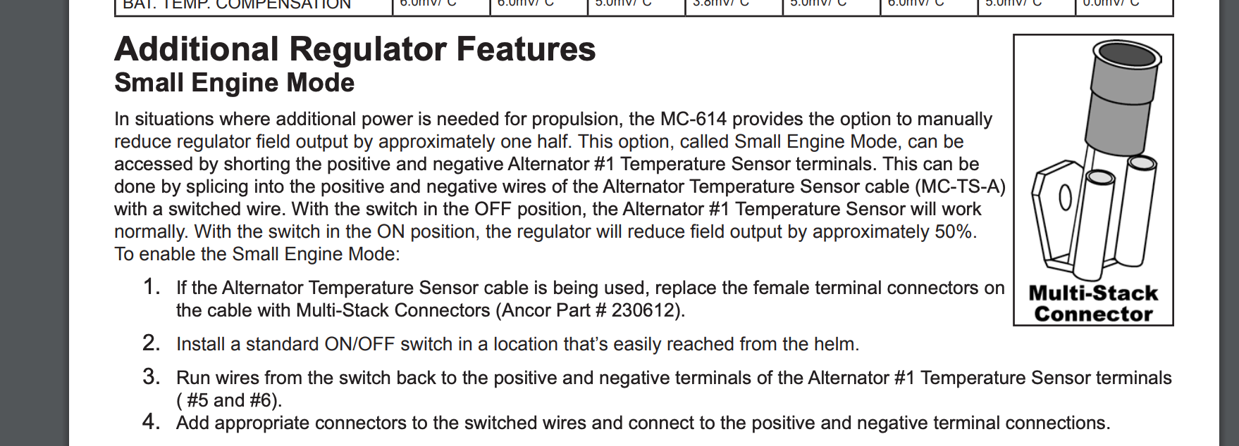

Here's some more specifics of my setup
We are a race boat, we don't run the engine unless we need to charge batteries on long legs. If we are "cruising" or on a "return trip" we are likely to be running the motor for hours/days at a time, the battery bank will be at 100% SoC and hopefully the alternator is not drawing much power.
Our current setup has a Balmar 614 controller. It has the adjustable ramp up on the field current. Hopefully this is good enough to keep the belt and engine happy.
We also sail in very warm waters, we are in the west side of florida, the Gulf of Mexico waters here are very warm. Our biggest issue is with heat. And so, im oversizing the next alternator. Our current air cooled 70a alternator unit reaches 120c. While I think a water cooled alternator will be cooler, it's still a lot of heat for a small engine floating in very warm water (30c is possible in the summer near shore)
My first assumption is that we will try to design around a 190a alternator and program whatever controller max out at 150a and see if temperatures (and belts) are ok.
As for spindle speed of the alternator, for sure, we will need to make sure we are driving the unit at the most efficient speed. I just got a quote from Beta, they have a 6pk crank pulley that is 210mm in diameter. My next efforts need to find out what diameters are going to be available on these alternators. I think we will likely run the motor at a crank speed of 2-2500 rpm (in neutral). What RPM's are you'all running at for peak power and or efficiency? What do you estimate the alternator speed is?
FInally, if I do need to be like a "Hot Rod" I'm hoping I can leverage this feature of the Balmar 614, "small engine mode" which apparently allows for a discrete switch to be flipped to reduce the current by 50%. Of course, if everything is well enough balanced thru programming and belt speed, maybe we don't need this, but here it is!
Thanks again for all the responses, this is truly useful for me.

I have change the ratio by 77% from the flywheel to the alternator from the original. today it is 178/49 (diameter at wheel in mm) The VDO taco are not correct after this rebuilding. But its simple to adjust it (my colleague are product manager for VDO Marine in Sweden 🙂 ).
Idling at about 700rpm my 155amp charge 95 amp and at 900 rpm it charge 130 Amp and at 2000 rpm 135 amp. No idea to over run the engine. The amp curve are flating out at a certain point. In my case its about 900 rpm.  When I start the engine it charge about 140 amp at idling and 195 amp at 1000 rpm and after five minutes its 95 amp resp 130 amp.

That mode on the Balmar controller is very crude, even reducing the load to half isn't going to be enough with a massive alternator on a small engine like the OP is proposing.
Fortunately the Wakespeed has a much better and programmable ability to taper off charge current at low rpm, for example from 20% or less at idle (equivalent to a conventional small alternator) to 100% at 1200rpm (minimum charging speed recommended by Beta).

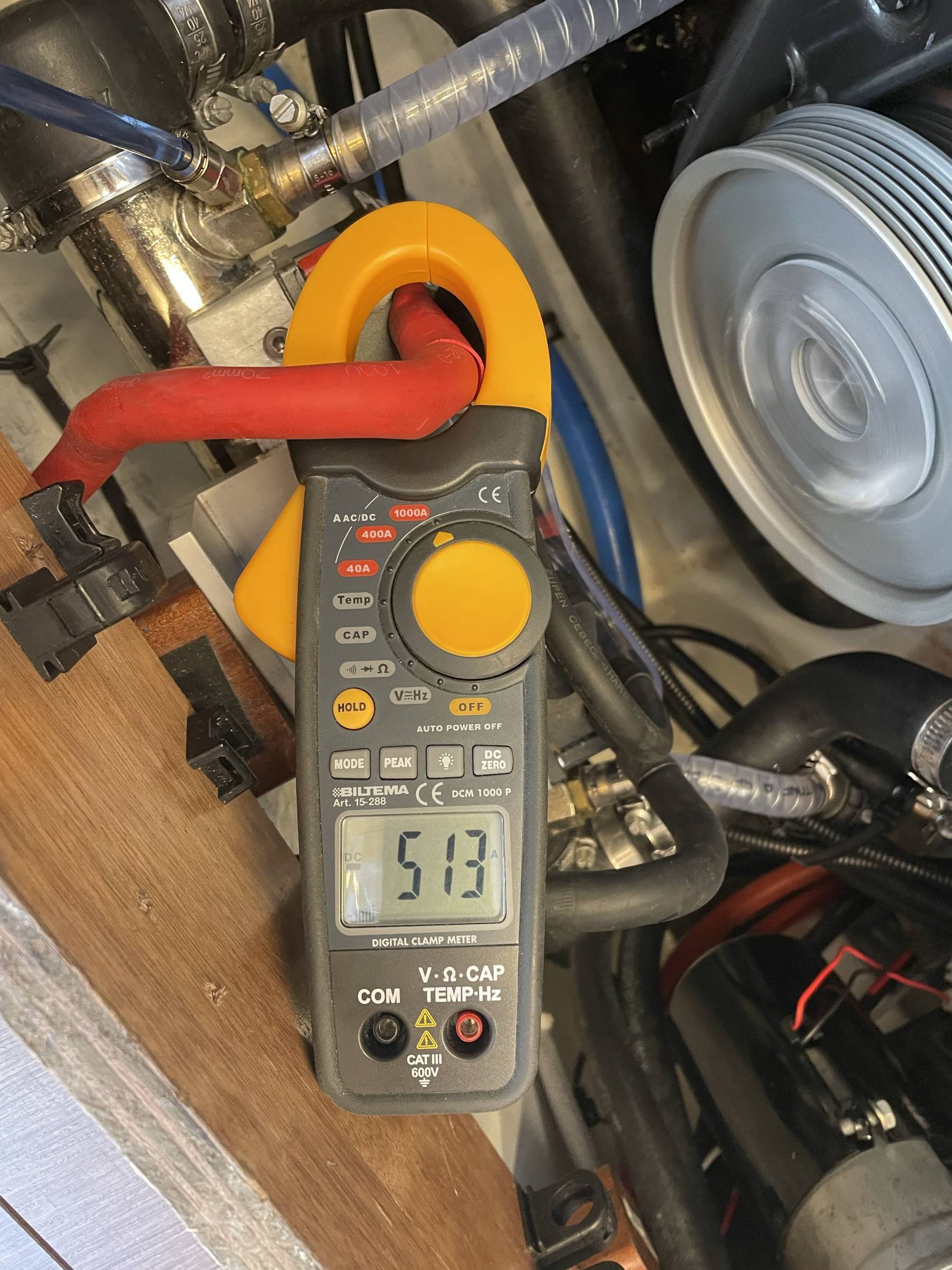

I have tested the alternator. I have removed the internal regulator (snipping off al leads to the IC internely) and soldered two flying leads out that are connected directly to the carbon brushes. The leads are connected to at 0-30V 0-20Amp adjustable power supply. Idling at 800rpm and sourcing 12V to the field we got close to 200Amp.
Will replace the air cooled alternator this winter by a water cooled, then we will have 400Amp charging.

Hi gentlemen and ladies.
Latest news from my project of a water cooled alternator.
It’s a dream. I charge normally 225A continuously at 1400rpm and the temperature is 42C. When idling I charge100A att 680rpm. The idling is going down caused the load.
I am stripping out everything in the alternator and only left the carbon brushes then it’s a generic alternator left.
Two cables are connected directly to the brushes. The field is supply by a Balmar MC-618 and a shunt with blue tooth. Everything can be controlled over my smart phone. Also, a temp sensor is attached inside the alternator that give feedback to the Balmar regulator.
3 thick cables of 25 mm² is connected to the stator inside the alternator. They go further to an external rectifier of 300A that are also water cooled.
Why don’t I use the internal rectifier? Its to week for this hi amp. I have burned so many rectifiers. The alternator is stamped with performance of 190A but that’s not for continues work. Very seldom a alternator can produce continuously what they are stamped especially at lower rpm. Why? The internal fan needs a high speed to cool down the internal heat. As we know is the efficiency only 50% this means a significant amount of heat must disappear somewhere. When I charge 225A at 14 volts, its 3000 watt of heat inside the alternator. To cool down this by air is not simple.
Any disadvantage for this kind of solution?
Need to understand everything how it works, not only about electronics also plumping! Spent so many hours to solve the circulation without having air in the system. Having air in the system could ruin the alternator.

At last i succed to get over 500Amp charging with two alt
I have some thing to modifie. I have to ad bigger cable.
Probebly I will reach a peak of 550 amp
The best part is that everything is super cool
Engine compartment are cooler nowdays then before when it was only one alt aircooled.
Happy charging
