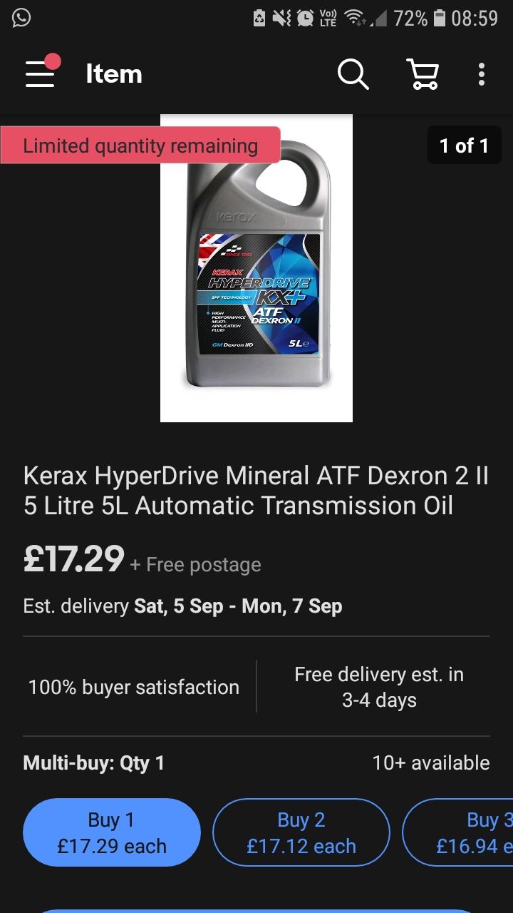

JonT Posted September 1, 2020 Author Report Posted September 1, 2020 (edited) Hi guys i am just looking at the gearbox to check which oil i should use. As i see it, it looks like it needs high quality ATF mineral based, like in the pic Edited September 1, 2020 by JonT Needed extra pic for gearbox type
Tracy D'arth Posted September 1, 2020 Report Posted September 1, 2020 And the gearbox is? Or have I missed the vital bit of info? Hurth and small mechanical PRM boxes up to PRM120 use ATF.
JonT Posted September 1, 2020 Author Report Posted September 1, 2020 1 minute ago, Tracy D'arth said: And the gearbox is? Or have I missed the vital bit of info? Hurth and small mechanical PRM boxes up to PRM120 use ATF. Its a hurth, sorry i am computer illiterate and can't work out how to put the picture of it on. Right yes so mine will be atf ?
